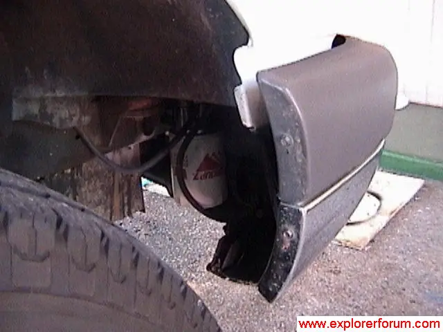

Here is a quick pic of my cover, I just made it out of a piece of sheetmetal, it attatches to the truck at the top, and then curves under the filter. The filter is mounted in the same spot as yours, except on the passenger side...

Thanks, VairKing. I'll do the same thing for a little peace of mind. :)
