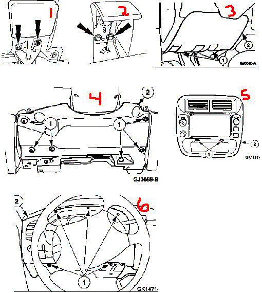

scroll down a few posts for instructions on how to get to the bulb
