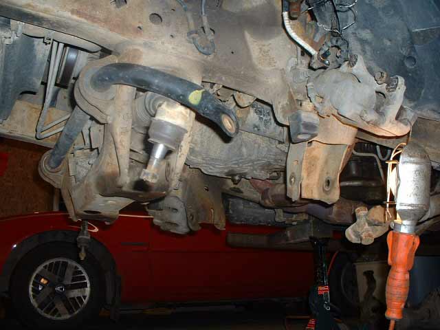

I have never seen them on the front. Would someone please post a pic? Thanks.
Found this in someones lift write up. You can barely make it out.
Look on the far crossmember/swaybar mount, inboard of the bushing.
It's hard to see in this picture. It's right up tight to the bushing. I still have mine at home, I'll take a pic after work.

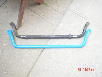

Here's a shot of mine next to EE's.
