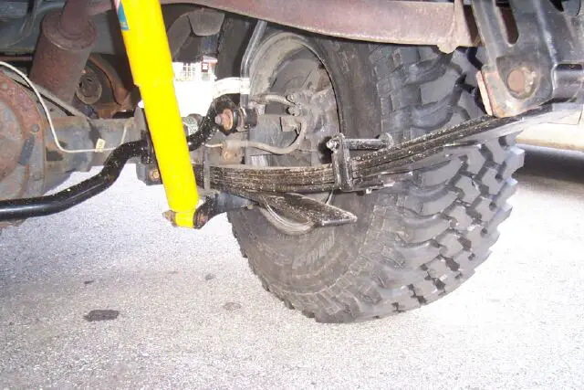

Here are the OMEs on my truck. Highly recomended! Expensive though!
-E

I've had my OME on for about a year now, prolly about 20,000 miles. They have not settled at all. the front torsion bars will settle after the adjustment, but thats easy enough. these OME are so strong and heavy duty I doubt they will ever sag or settle.
when you lift up a single leaf pack, you say to yourself, damn these thigs are heavy duty. I had me, my brother, and another 200 lb + guy sitting in the rear and there was no sag!.
