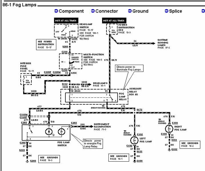

Here is a schematic for the 97 fog lamp wiring. You should be able to figure out the correct connection by matching the wire color codes. The 12 V wire should be Tan with an Orange stripe. The ground wire should be solid Black.
