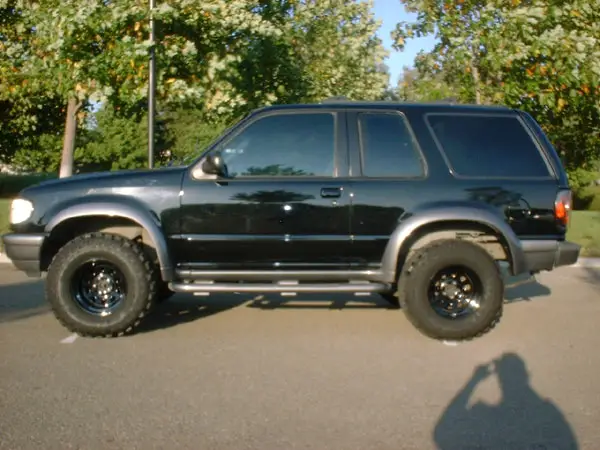

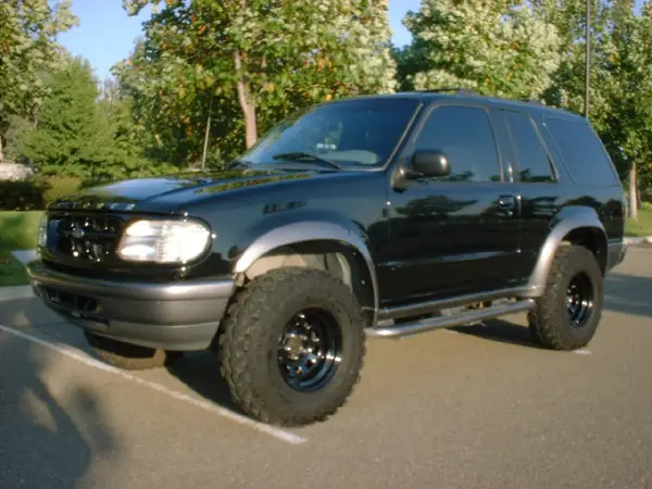

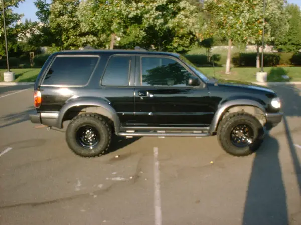

Here are the earliest before pics I have. It already has the TT/Shackles/AAL. I have a set of 31x1050x15 Super Swamper SSRs in this pic. I liked the look and performance of the SSR, but I didn't keep them properly inflated and balanced, so they started to cup. The road noise was more annoying than a crying baby.

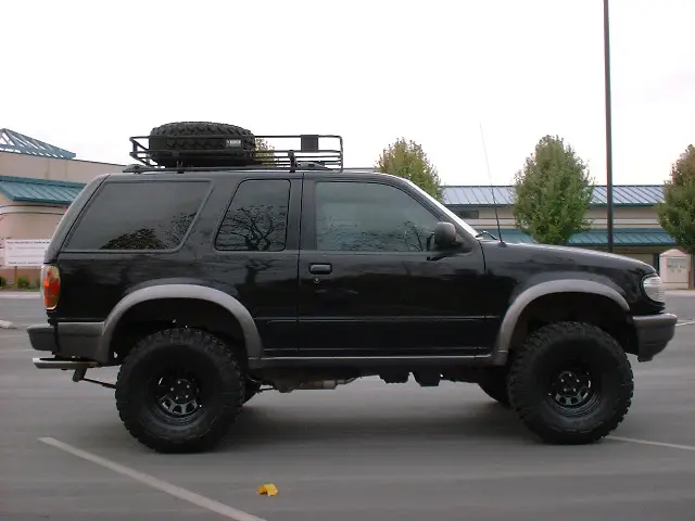

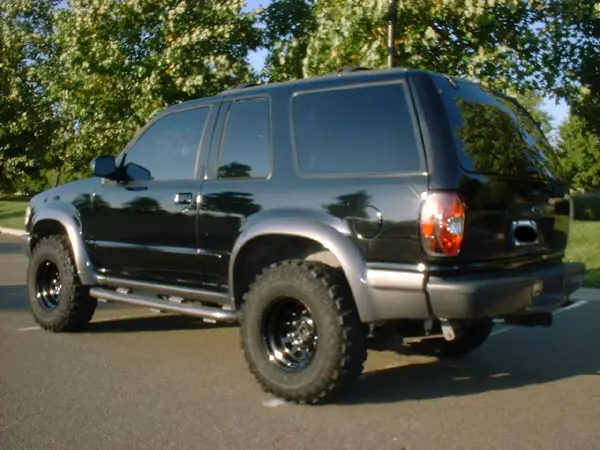

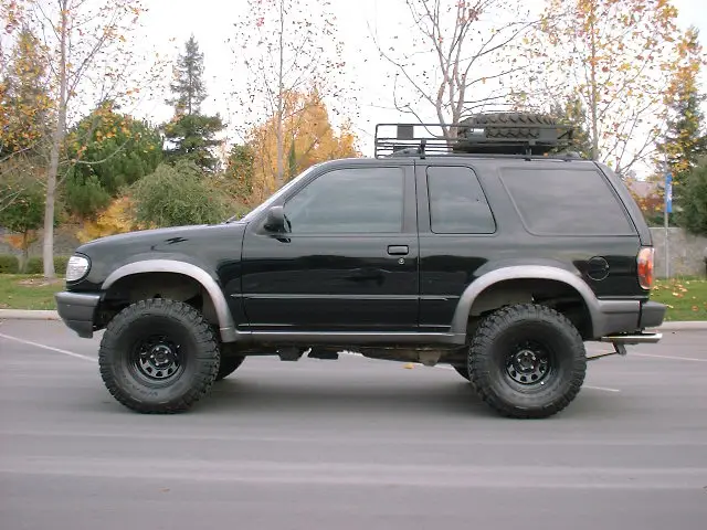

Here are the current pics. I was debating between doing the suspension lift or the body lift or both.
The pros for the suspension lift were:
- it provides higher clearance for the frame and chassis
- slightly higher lift than body lift
- increased articulation
The cons for the suspension lift was:
- I didn't want to spend over $2,000 to get it installed and I didn't have the time or expertise to do it myself
The pros for the body lift were:
- easy to do, I could do it myself within a day as this is my daily driver
- a lot less expensive
- gives enough lift to fit bigger tires
The cons for the body lift were:
- it doesn't provide higher clearance for the frame and chassis
- less articulation than suspension lift
- the guts of the truck show on the side and my hitch would be 3" lower than the bumper
After much debate and waiting about a year an a half to make up my mind, I decided to just to the body lift. It was a fairly easy intallation. First thing I did was gather as much info as I could from this site and other sites. Thanks to everyone for their expertise, it saved me much time and anguish. The only tips I have besides the ones already mentioned are make sure to unclip the brake lines and tranny shift cable. Also, I used an electric impact gun, which saved me tons of time. I was able to spin all of the bolts off in no time. Lastly, be prepared to spend a bulk of the time with the bumpers. I got 2 brackets made at a local metal shop. More info on the bumper bracket below.

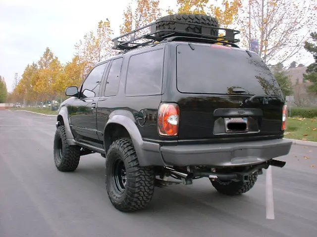

Here is a pic of the rear bumper bracket I had made. I got a schematic that is posted on several of the threads on this forum, took it to a metal shop, had them cut it, drill pressed holes (note: the holes need to be larger than 1/2" if you're using the stock bumper bolts)

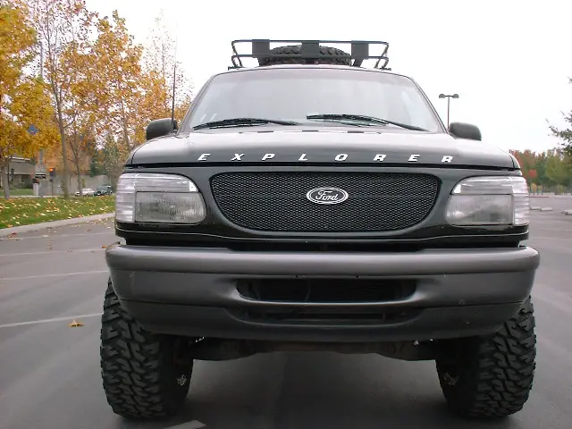

Here is a pic of the Grillcraft grill, black Ford Explorer emblem, and Range Rover Style Explorer badging. The grill was easy to install, I just removed the black surrounding grill, drilled three holes, attached the grill, and that was it. The Explorer lettering was removed from the rear and attached with extra strength double sided tape.

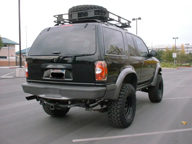

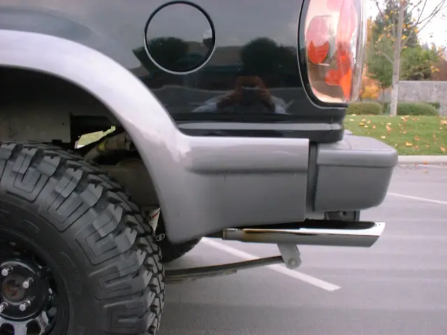

Here are pics of the exhaust. The tips are black chrome from Toucan Industries. The tips hang slightly low under the bumper, but it's fine because if I ever need to mess with the body lifted bumper I have some room to work.

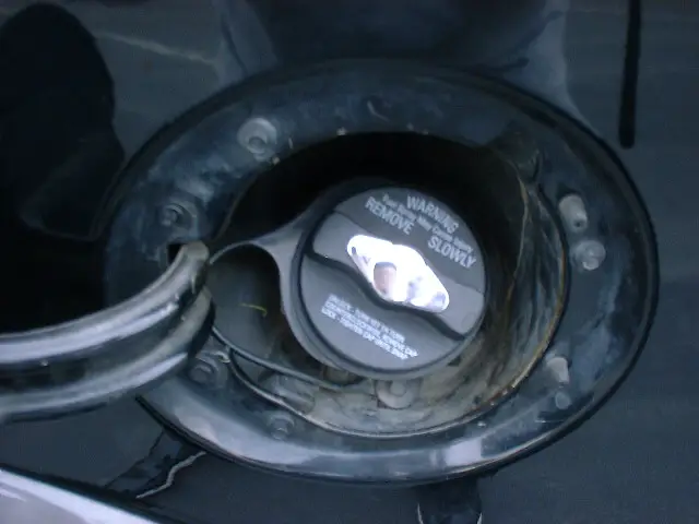

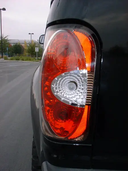

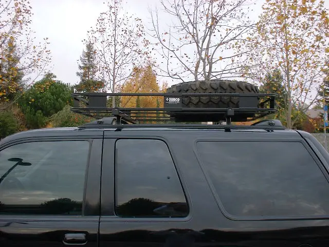

Here are pics of the safari rack, hitch tow hook, de-ambered clear corner (notice the cut where I dremeled, not noticable from a distance), altezza style tails, and locking gas cap. I don't know why Ford did not not have a cab operated gas lid opener like in most cars. They have an unlocking system where anyone can siphon your gas, pour sugar in the tank, etc. I think this is one of the best investments I made.

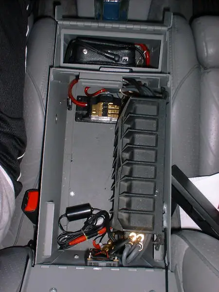

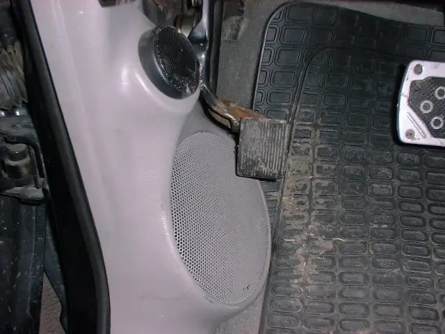

- Audio: Alpine head unit, MB Quart RSB 215 separates, Q Logic kick panelsRockford Fosgate 4x100, Pioneer 5x7s, JL Audio Stealthbox, MTX Thunder 2x100, Neo MP3 player
I wanted to provide more cooling for the amp in the Tuffy box, so I installed a computer fan and drilled 1" holes in the sides.
The New Jukebox is a little glitchy, but 20gigs of music is sweet on long drives.

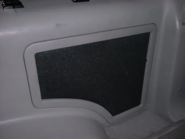

The JL Audio Stealthbox "is so necessary". It hits pretty hard, but stashes away for maximum storage capacity. I highly recommend it.
- Misc: Tuffy Stereo Security Box, Explorer Express Storage Console, APC Pedals, rear mounted fire extinguisher and Maglite
- Seating: I replaced the crappy cloth captain's chairs and rear cloth seats with leather front and rear. To power the new seats, I spliced into the monster cable used for the stereo system. It was a fairly easy install. If you have a sport, you must get the sport seats. The sport seats have the sliding rails to move forward when someone wants to get into the rear and has rear lower thigh/rear quad extendable pads.
This storage box is great for all the junk, cell phone charger, earbud, tire gauge, condoms, etc.
