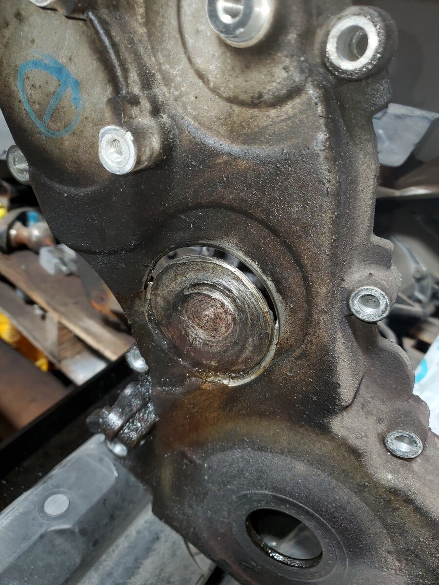

BTW did 4.6 chains on an e250 van yesterday, only because the belt tensioner blew up and took out the cover. Put metal all into the chains but still drove it in.
The passenger side cam sprocket has holes in it. Shove a large, long screw driver through the socket and wedge it against the head. Forget where I did it, but it’ll be obvious with it open.
