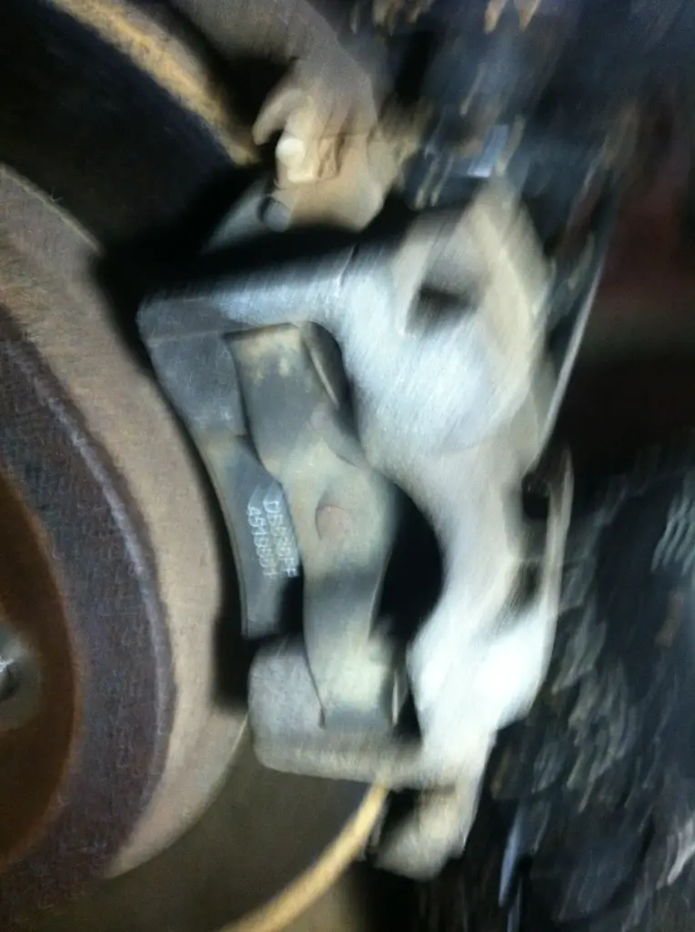

Step 1: Remove tire
Step 2: Loosen the bolt/slider pin, slide it out, move on to the next bolt
Step 3: Wiggle the caliper off the disc (for some it might come easy, for others I am sorry but it could be a little difficult, just be patient and wiggle, and pull towards the rear of the vehicle)
(the pics are blurry, sorry, it was cold!)
Now you'll find yourself in this position!
See that clip on the left side (outside when mounted on vehicle)? A couple screw drivers will be your friend
Step 4: Pull off the outside pad by prying the clip, and the pad up at the same time (This will be hard, you might consider cursing and throwing things to get your frustration out)
Step 5: Removing the inner pad is simple, the outter pad needs to be gone first though. Simply pull the pad away from the piston, there is a triple prong that grips the inside of the piston, it came out easy for me and is easy to replace

I will edit the pictures to be more understandable soon, but I will describe the best I can now
the rounded part on the caliper is where you will want to put the threaded end of the clamp
the back side of the caliper isn't shown very well, but you see the metal line going into the caliper, don't damage that, but there is a mounting bracket where you can place the stationary part of the clamp on that bracket and put a pad on the piston
