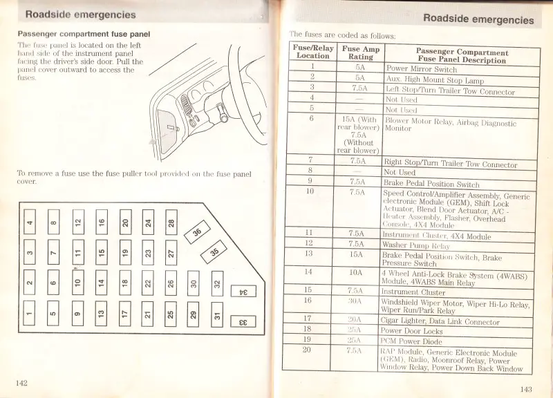

dome & 3rd brake light out. wires touched while replacing 3rd. what fuse # & location to replace.
Hi again, the #2 fuse is good, the LED was a plug & work, but the connectors were not a match, so i spliced both the new LED & the plug from the ceiling. all 8 wires were bare,got thecargo lioghts to work bur can't connect the 3rd brake light, then some wires touched & static sound, now no lights at all, where do i go from here, pls help.
