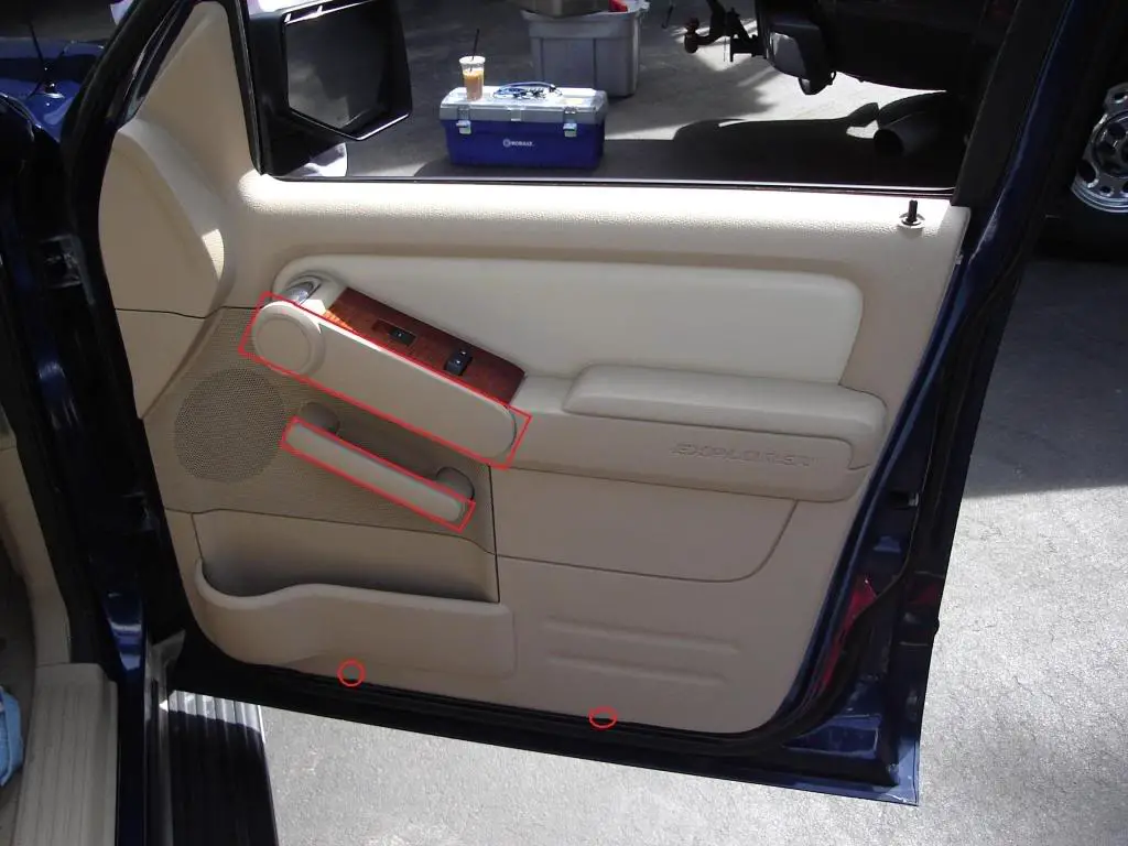

In this first picture I have outlined in red boxes two snap on covers that have to be removed. There are also two screws in the lower part of the panel (circled in red) that have to be removed.
The two covers are snapped into place and need to be gently pried up with a flat screwdriver. I wrapped a cloth around the tip of the screwdriver to prevent scratching. Go easy they will pop off.

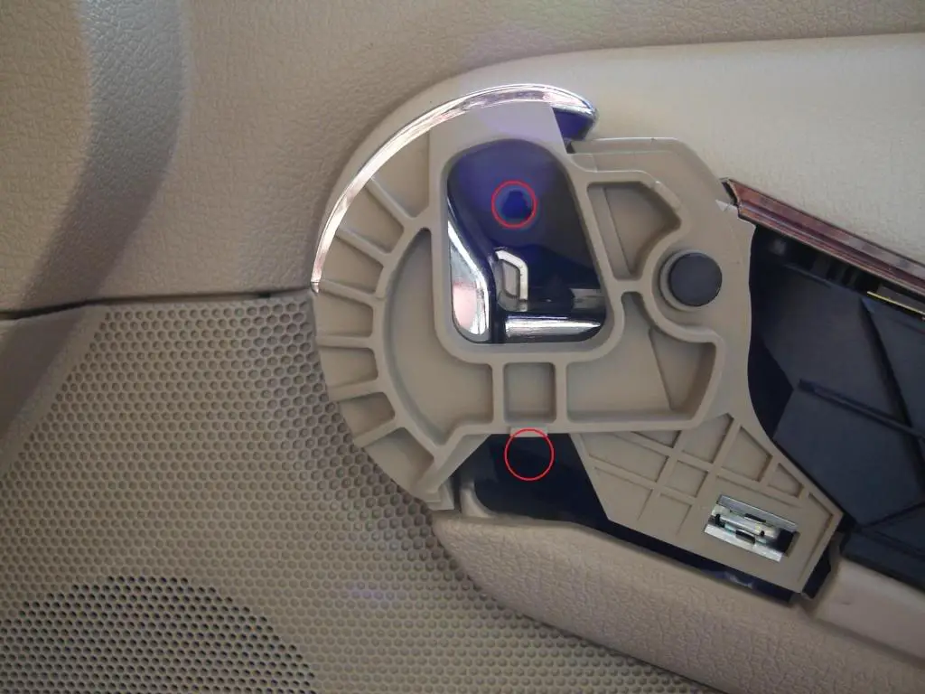

In the second photo I have circled in red two screws that have to be removed at the door latch handle after you have removed that cover.
