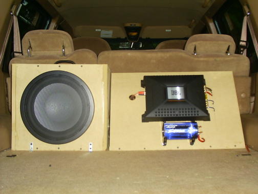

Nothing fancy, but I LOVE it so far. Still need to get matching carpet and finish the amp rack. Gonna install 2 fans, one on each side of the amp, one blowing on the amp and the other off, and frame out the sides and cover with 1/4" plexiglass. The box is a hair over 1cu ft and made with 3/4 in mdf, gorilla glue, 3 in drywall screws & silicone caulk.
I am shocked how much 1 12 can pound!!! IT'S AWESOME!!!!
I have wanted to do this since I was 16 (I'm 29), and I'm so glad I did!!!
