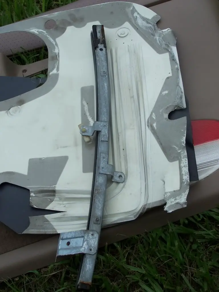

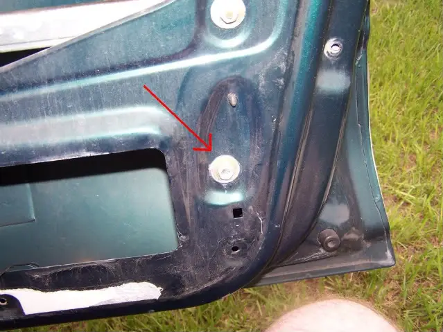

Then remove this bolt here that holds the lower window guide in place
You can either leave this window guide in the bottom of the door or, like I did, add it to the pile!

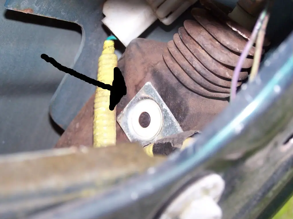

LOOK inside the door and towards the side of the door where the outside lock should be..RIGHT on passenger side, LEFT on driver's side and LOOK for this guy
