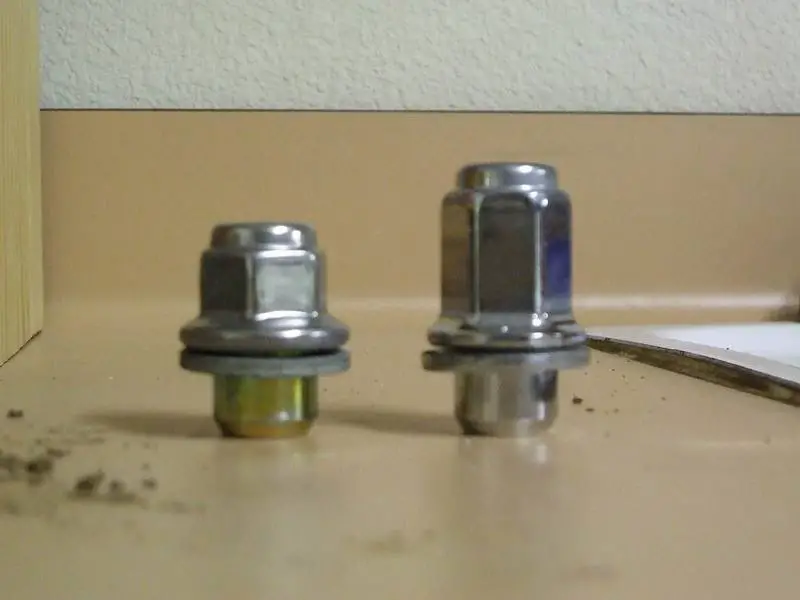

...Did some more searching...:scratch:
..Here is a recent thread with info on the hubcentric rings in post #21..
http://www.explorerforum.com/forums/showthread.php?p=2071791
