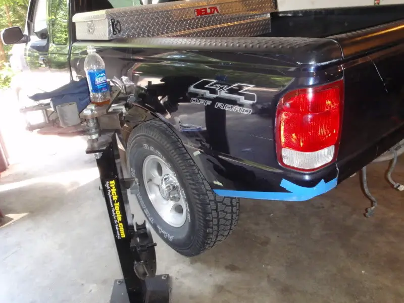

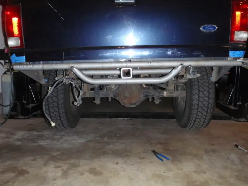

Thought this build would be helpful for people looking to put the DBR 4x4 kit on their Ranger or Explorer.
Specs:
-00' Ford Ranger 4x4 V6 SOHC Extracab
-DBR LT kit
-DBR clevis steering kit
-Fox 2.5x8 c/o w/ raised lower spring collars
-Fox 2.0x3 bumps
-Eibach 18"L 650# coils
-Deaver F31 pack
-Fox 2.5x16
-Fox 2.0x4 bumps
-Fiberwerx 6" bulge front glass
-Seabeck 4x4 bedcage
-Seabeck 4x4 front bumper
-Seabeck 4x4 rear bumper

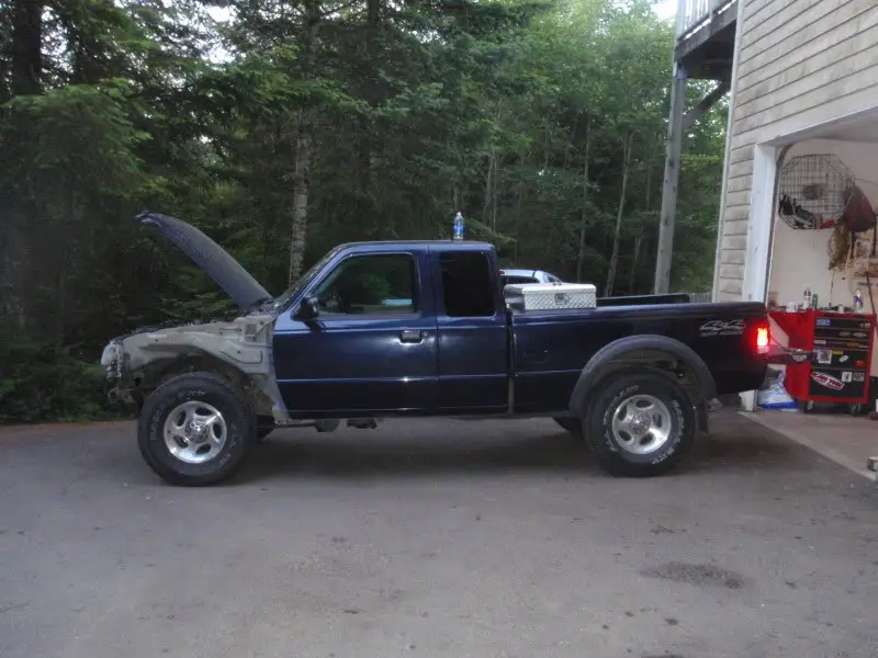

Before with 3" body lift:
Fenders/bumper off, bodylift removed from cab. (thank God)
Stay tuned for updates, just waiting on parts.
