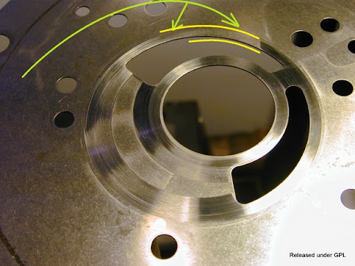

Oil pump adapter plate showing eccentric wear. But the funny part is that the gears show little wear at all on their faces. The pump body itself seems fine as well. I have some small hope that perhaps the wear pattern was caused by fluid escape at that particular spot, which prohibited contact with the plate right there. Sure, right. lol
