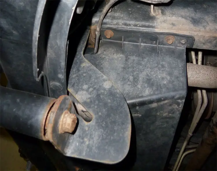

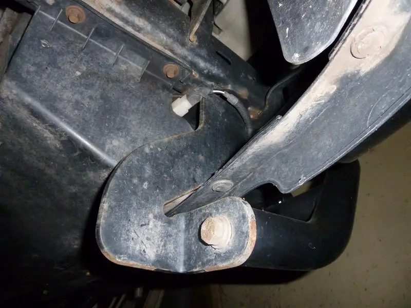

After mocking up the driver and passenger brackets the bar does not line up quite right with brackets.
Passenger Side Mounting Bracket
Driver Side Mounting Bracket
Offset Mounting Brackets and Safari Light Bar
I know that Flounder has installed this Light Bar on his Sport Trac, but I didn't know if anyone had any recommendations for me, anyone else have issues installing the Safari Light Bar on a Sport Trac or Explorer?
The brackets are 29 1/2" from the center of each hole whereas the Safari Light Bar is 32 1/2" from the center of each nut.
The mounts flex a little bit, but there is no way I'm bending the steel. There is a little room to pull out the flanges on the top of the brackets to extend the holes further apart, but I don't want to compromise the integrity of the mount by recessing flanges from the bolt.
Any ideas?
Thanks,
Derek
