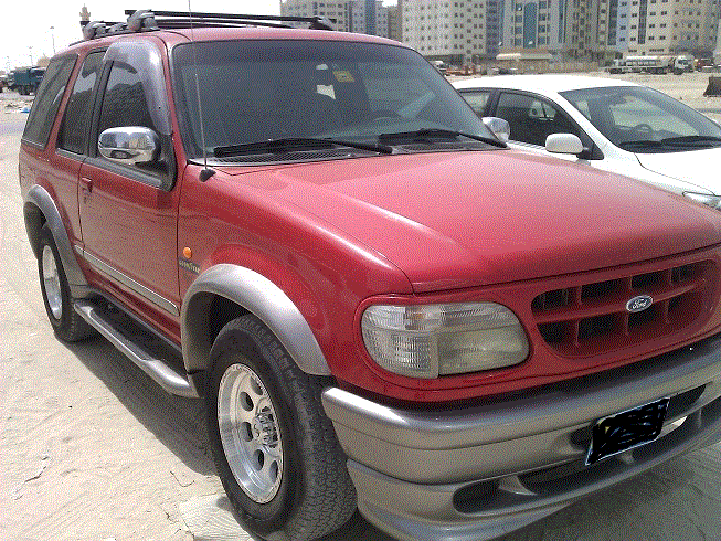

I am new in this forum and not an expert.
I could not find here complete references about (How to do Ride Height Accurately for Stock Vehicles only.)
Guys, You can find bellow the details which will be good for who are looking for this as well as a reference in discussion.
==> How I can make my ride comfortable as much as possible, within recommended height settings. (Which height would be ideal...So Please comment with your experiences. Thanks.

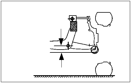

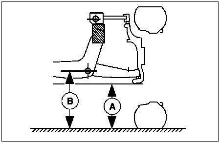

3: Measure the distance between the (A) front suspension lower arm bushing center bolt and (B) Space Saver Lift/ground surface, Record the measurement.
4: Measure the distance between the (A) front suspension lower arm (lowest point, just before lower ball joint) and (B) Space Saver Lift/ground surface, Record the measurement.
5: Subtract measurement (A) from measurement (B) for ride height.
6: When performing an alignment check only, the ride height should be between the specifications.
7: The ride height, after new parts have been installed, should be between the specifications.

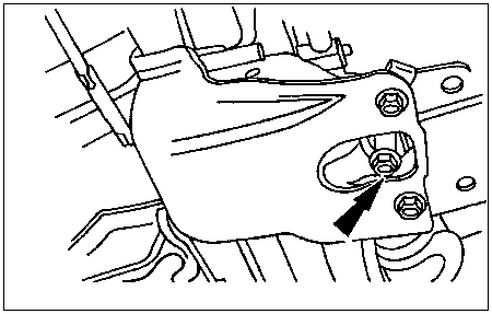

8: Adjust the torsion bars (height) as necessary by tightening or loosening the torsion bar adjusting bolt.
=>Tighten the torsion bar adjusting bolt to increase the torque or raise the height.
=>Loosen the torsion bar adjusting bolt to decrease the torque or lower the height.
