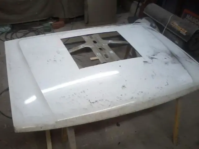

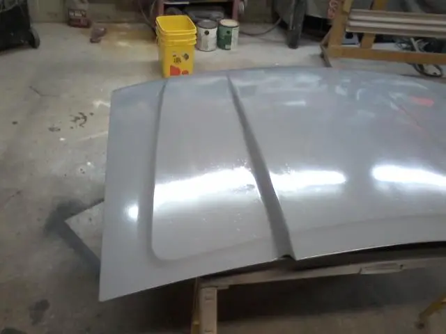

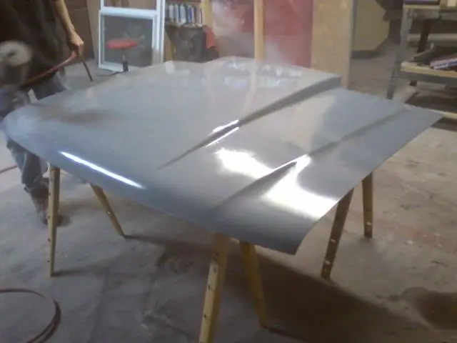

Finaly got into the body work for this!
Here is the cutout for the cowl to make it functional.

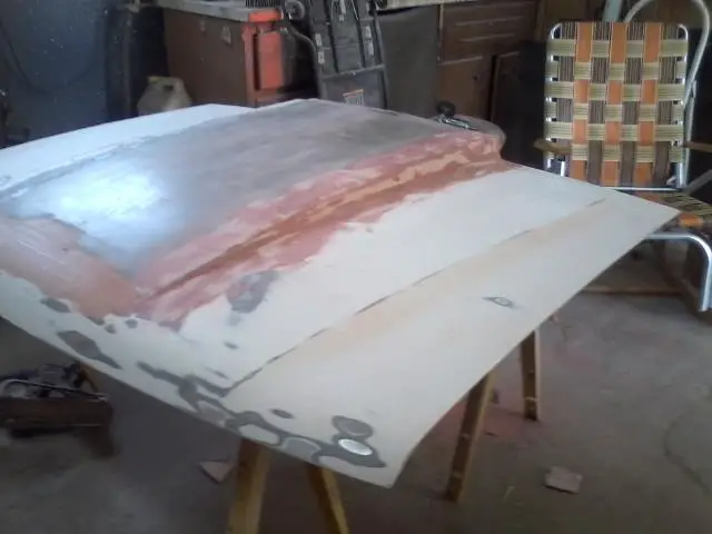

After trimming the cowl and welding it to the hood, we have been shaping it up with fiberglass and bondo to get a nice smooth curve to follow the hood.
We should have paint on it tomorow or the next day :D
More pics to come !
Got it in primer

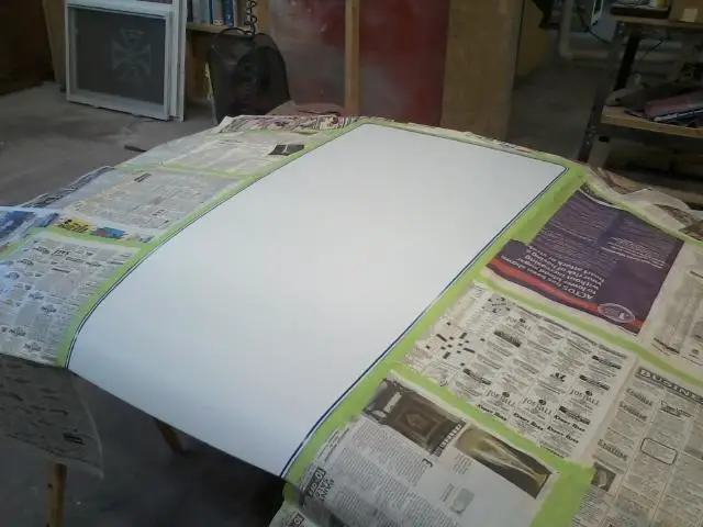

We put the white paint down.
Here is the cowl being taped off.

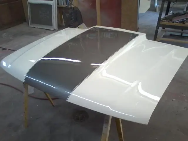

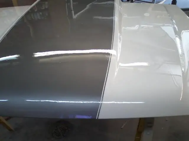

Here is the Dark mettalic grey with the pinstripe. I wanted it to look more intentional than just painting the cowl.

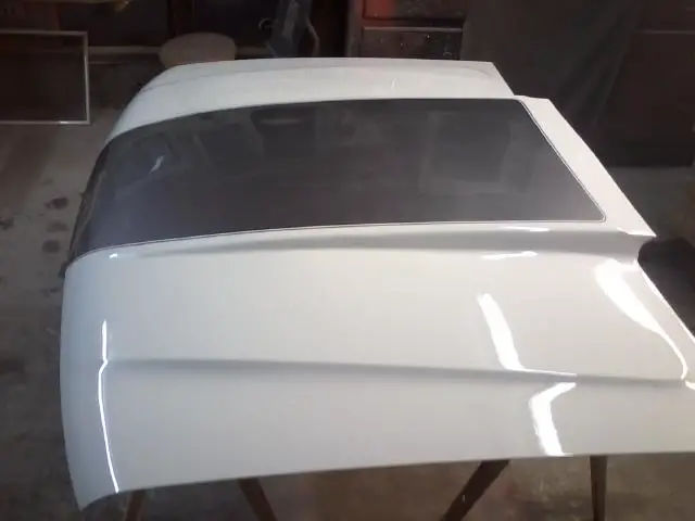

Here it is clear coated :D
