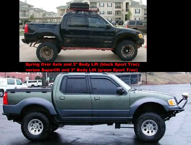

Superlift uses a drop bracket on the torsion bars to keep that at their stock angles. I don't like that. I prefer the way RCD does it.
The green ST in the picture below had a Superlift on it. And you can see how the torsion bar brackets really stick out begging for some rocks to hit them. :D

So, you SOA'ed your rear, how'd you level out the front? In that pic it is a good bit lower than the rear...
Nothing. At that time, I had Hannemann fiberglass fenders on the front. I think they helped make it look normal.
As for the gap you see between the bed and the frame, you won't see that on yours if you do the 3" body lift. One year at Truckhaven, my rear driver's side tire flexed and caught the gas filler and ripped it from the bed side. I fixed it there at Truckhaven by cutting the pipe and it now resides under the bed. So, in order to access it to fill up the truck with gas, I had to remove the inner fender wells. That's why you see a gap between my bed and frame.

Nothing wrong with the way I have to do it now. :D My current tires would probably tear up the inner fender well too. They rub the frame right now. :D
