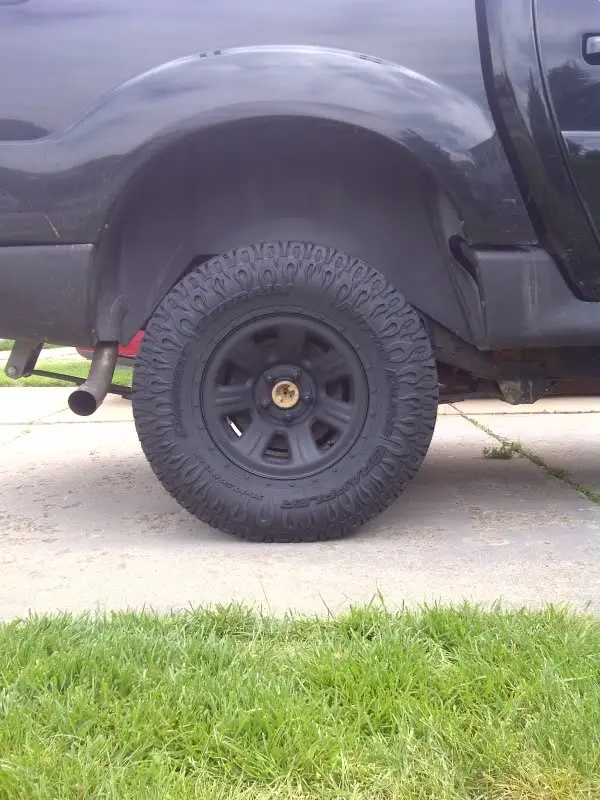

These are 31x10.50x15 on the stock 15x7 wheels but it also has the 3" bodylift with 2" torsion twist and shackle lift in the rear. I think you would be able to fit a skinny 32 on there with just a TT and SL.
Thats the front 235/75-15 with a 2" TT.
Thats the rear 235/75-15 with the warrior shackles.
