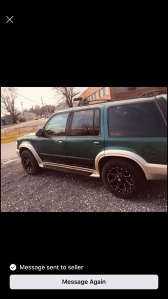

410Fortune, I plan on adding headers when I tear the heads off it to redo the valves. The guy I bought it from cut the exaust off it at in front of the first cat And burnt a valve. I scabbed two magnaflow turbo mufflers and enough pipe to turn it down just before the rearend to keep from causing any more damage. So thanks for the recommendation for headers. This is the very first performance build and want it done right. Any opinions on header back exaust. I want it to have a real deep tone, not crazy loud at idle but want it to scream deep and loud when I get on it. Mike65 thanks for the feedback, I will take all the advice I can get. I want my little explorer to be all it can be. Today I actually bought another explorer today. It's a 97 Eddie bauer' edition. AWD 5.0 with 160000 for 1700.00 I'm happier than a fat kid with a ice cream cake.

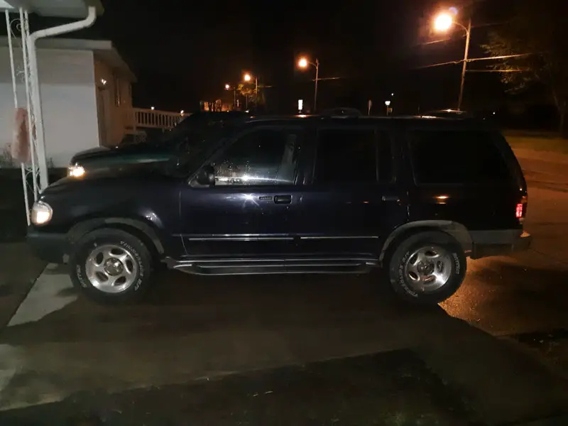

I put the factory wheels that come with the the awd on the 2wd. Made it look a little better....
