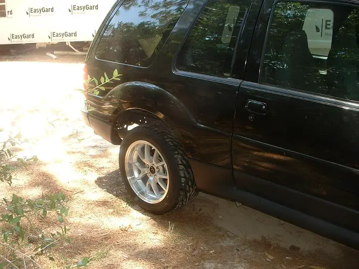

New wheels - dirty truck
Hey, those look pretty good!
Thanks Jon. Just don't try and lift them with your back or you'll be in bed for three days. ;)

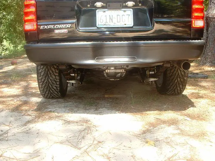

These are 295-45-18's. They fit perfect and I could have gone wider but didn't want to chance it. I haven't driven the truck yet but they look good - way better than the stockers.
I have a feeling the spinning problem on the street is now fixed. If the wider tires don't help, then the weight will. Then again, maybe I'm making a huge deal about the weight, and performance will not be affected greatly. There’s only one way to find out. ;)

Did you go with the 295's in the front too? Also have you lowered it at all? Theres a lot of extra wheel well there I think a 2" drop would help it a lot, and improve the handling too.
That does look good, let us know how the fit is, and how you like the handling and ride.
No, not on the front. I'm going with 255-50-18's on the front (I think)
I'm lowered 1" all the way around. I was 2" but raised it back up. It does look like I need to go back down now...
The fit was good with the 10" rims and 295-45-18's in the back. I could have gone wider because there's clearance there - my guess is around 2-3" still. Once I drive it I'll let everyone know if there’s any problem although I don't think there will be. I have the x-spec sway bar and there are little clamps that come with the kit. When I first purchased the kit I had no Idea what the little clamps were for but now I think I know. My guess is it's to keep the rear end from moving side to side during a sharp curve. Make sense? What that means to me is you can go with a wider tire and not have to worry about it hitting the frame during curves. However, I would still want atleast 2" of clearace.
