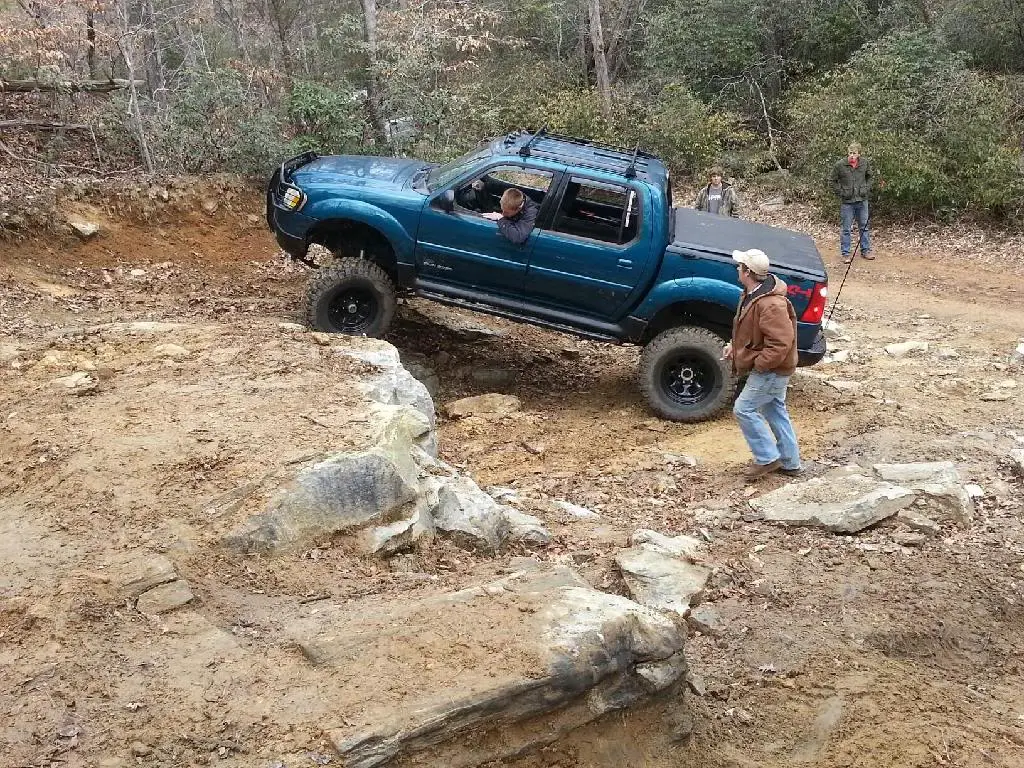

I went with the offroad club at school to a place in Toccoa, GA yesterday to test out the SAS now that it finally has 4wd. Unfortunately it was pretty slice from snow melt and being open/open hindered everyone. I was able to get my buddy to bring his ST with 33s and TT/Shackles to the trail. There were a lot of parts where the extra 8" or so of travel really helped to keep my tires planted. It flexed out great, no rub, but I still need to bend the gas tank skid plate some more to avoid the terrible grinding of my rear driveshaft when flexing.
Upsides: great flex, and didn't have to worry about coming down on the belly (except on a big rock ledge at the beginning, but then again the locked TJ on 42s almost did too)
Downsides:
The truck is really tippy with the BL in and got a little sketchy on some steep turns and off camber ledges.
I NEED to get the Aussie lockers in. This would allow for a lot more control and slower speed where the height wouldn't be as much of a problem.
Overall, I'm happy with the SAS and the way it performed. Kind of wishing I had gone full width but I guess you have to leave room for improvement.
