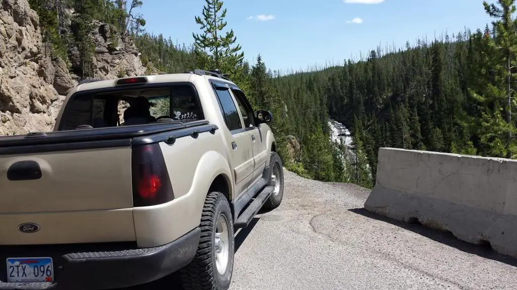

I have the same side steps. Love them. There super light. They mount in the same location as the stock ones. And there adjustable when you mount them on how low they go and how far they can stick out. I wil get a pic up soon too
as dan said they are adjustable and use the forward and rear factory mount points on the body. the link i posted is the brackets and boards as a kit hardware is included. and no they are not flimsy at all i have had my 170lbs and my brothers 225 lbs on it and they dont budge they are said to be rated up to 500Lbs

I just got a set of those running boards on my 01 ST today. they are definitely bolt-ons and have about 3/4 inch adjustability in-out and up-down. if your ST is older, or you live in the rust belt, the j-clips will be extremely hard to remove. in fact, the rocker flange had rusted through on a few so I was unable to use all of the recommended fasteners. also, the j-clips that came with the kit are not very sturdy; they only have 3 or 4 threads so they strip out really easily. don't torque then too much! I am going to try and get 2 more brackets to mount in the center oem position to beef it up some. I will post a pic tomorrow. I think it turned out pretty good. can't beat the price.
pic
