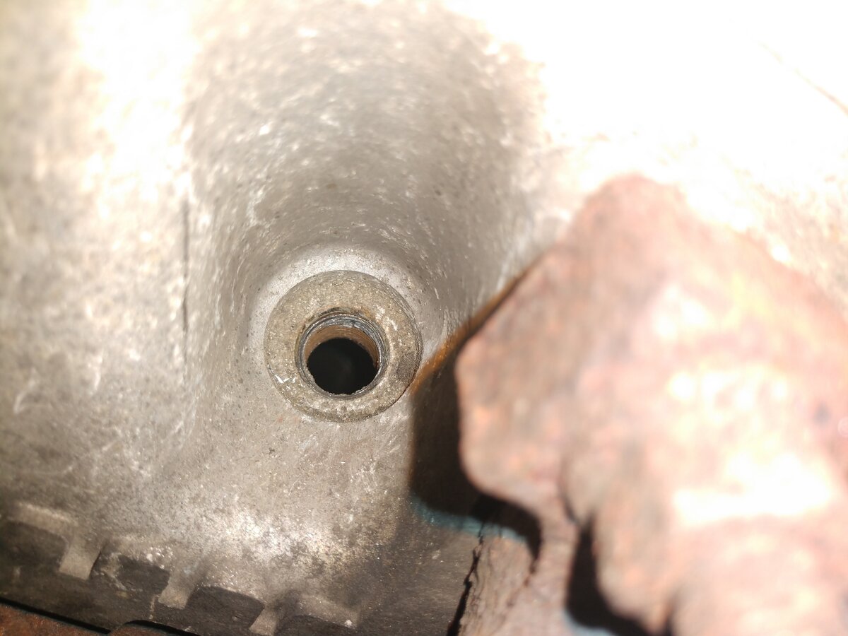

Number 4 plug won't go in. FML.
Have to wait til tomorrow to get the tool to rethread.

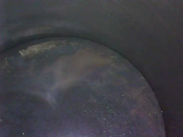

Cylinder 4, 5, and 6. Posted in order. I'm kind of stuck until I can retap the spark plug hole so I used my endo camera to take a peak insides the cylinders.
These look ok for 110k miles or worse than they should?

How did you strip that spark plug hole?
I see it happen all the time but never happened to me knock on wood
Did you thread them in by hand or ?
I found out the hard way once. Plugs can look good but the internal resistor can be bad and grounding out internally. One thing I hate about resistor plugs which all are these days. (I have another vehicle that uses special non-resistor plugs).
How would you test them other than a continuity test just curious
I put them in the spark plug socket and start them by hand.
I screw them in by hand all the way no socket. If it's hard to get to I put a rubber hose on the end of the plug to help guide
but you can't cross thread that way
Then I tighten it with a wrench
I also put some antiseize
I didn't have anything small enough. I normally keep an old spark plug wire boot around for this but must have tossed it.
Without the socket I can't even get it into the hole, no room for my fingers and the plug.

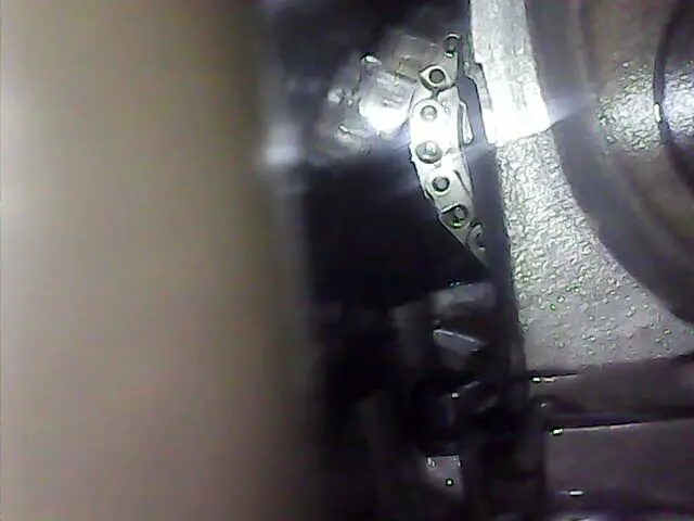

I ran my endoscope cam down the oil fill hole and got a little look at the passenger side. Looks fine to me but the passenger side is a mystery box still.

Timing chains are tight and no broken guides. Everything in the head seemed solid, nothing broken or loose.
