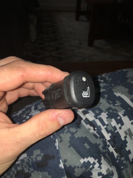

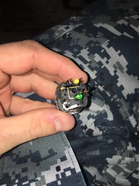

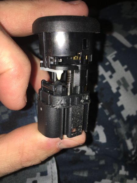

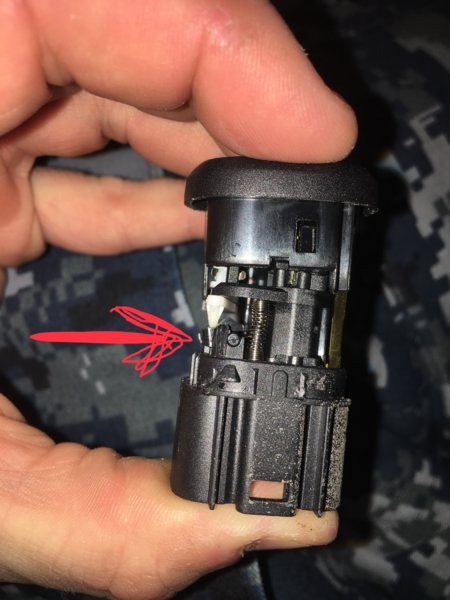

So, recently my driver's side seat heater button will engage when pushed, but will not remain on. I've read there's alot of questions and wanting to know if there's a fix, so I opened mine up.
The green is the engage side of the switch, the red is disengage.
The small white triangle springs back and forth from one to the other to turn on and off. Mine only is sliding to the disengage side. I'm still trying to figure out a way to make the switch alternate like it's supposed to.
