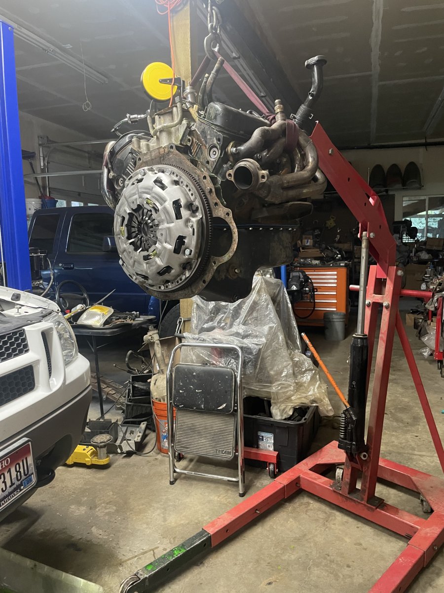

Something went wrong with the camshaft install and the engine is trashed
Ordered new gasket set will be installing a different 5.0
Good news is the engine took about 3 hours to pull. Bad news is I cannot afford to buy a comp cam right now or wait for it so I gotta run a stock 302 for a while
I wish I could buy a Atk 347 hahahaha

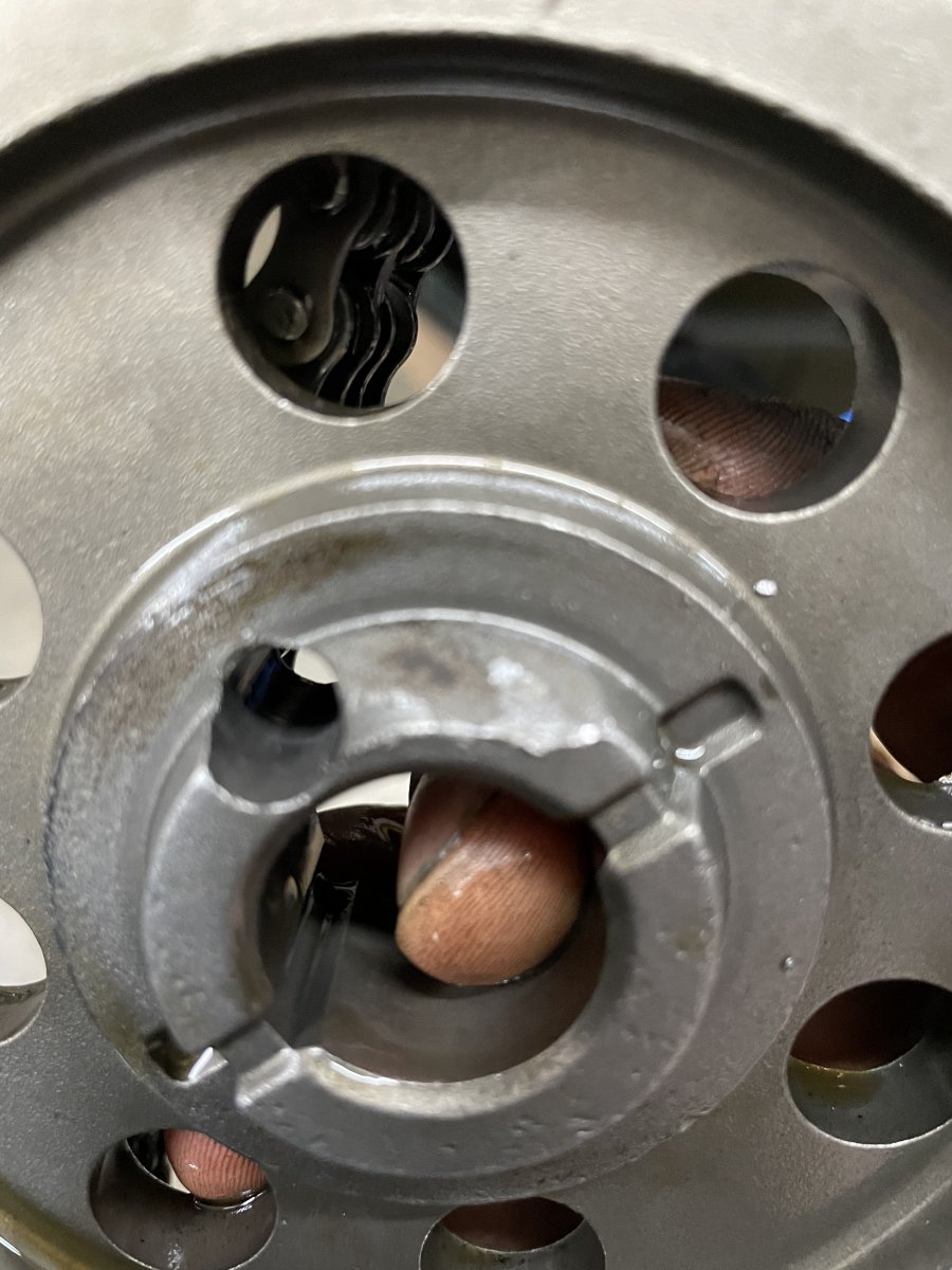

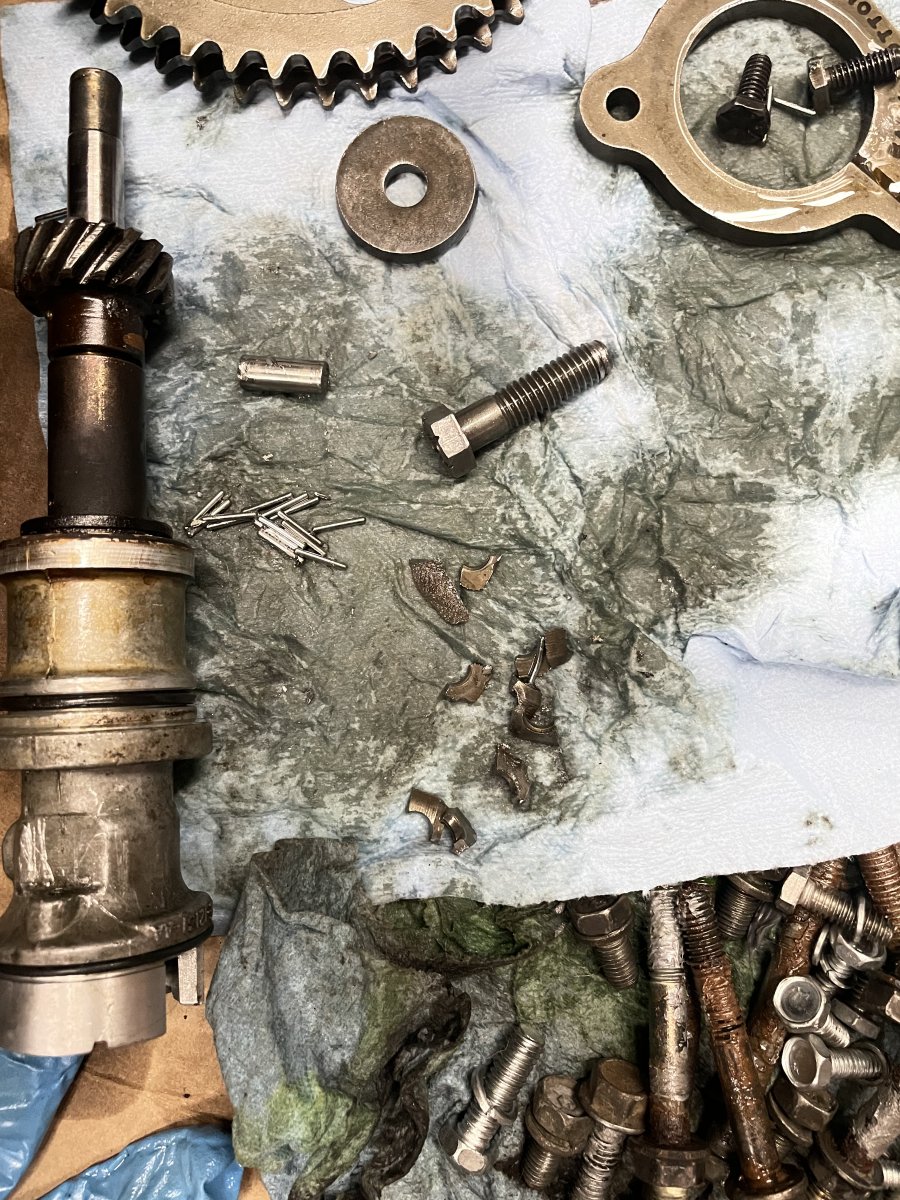

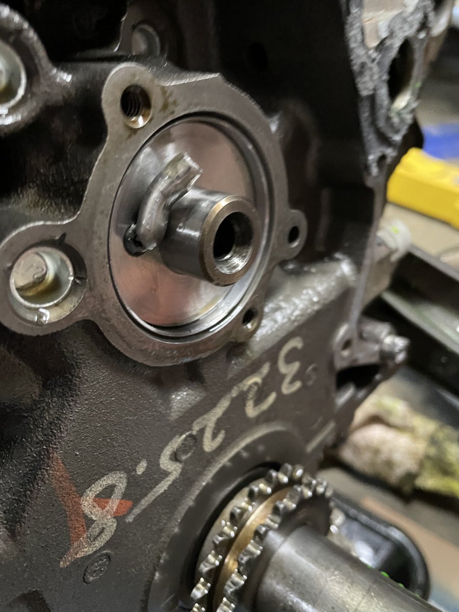

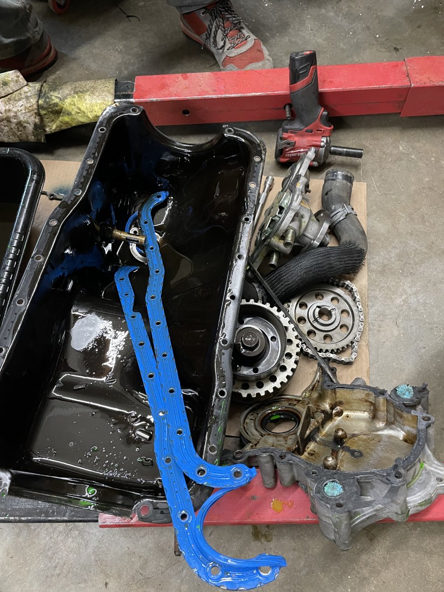

Truck was a ripper! Sounded so good had no clue anything was wrong. Then next day went to start it and sounded bad then quit
No restart. Check fuel psi was good. No oil pressure while cranking, pulled cam synchros could see the cam walked backwards… engine was out 3 hours later
What a loss! Something I did, not torque the cam bolt? Install something backwards, mix match cam gear? No clue. Everything checked out except th cam bolt was loose and the entire timing set was loose, tons of sharp metal in pan… shes toast, I can’t believe it… but moving on
I sat there just staring at it for long time yesterday thinking what is next… then my stepson says well we can stare at it and wonder or we can just pull it. Hahahaha the two of us can pull a 5.0 that is for sure.
At least I know… $3500 loss! Jasper 306 bye bye
Oof that's rough. Do you think it was an issue with the cam or the block?

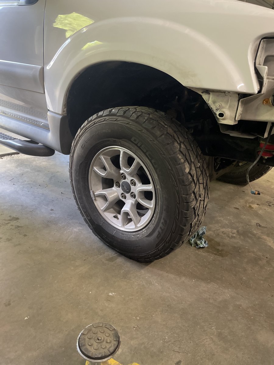

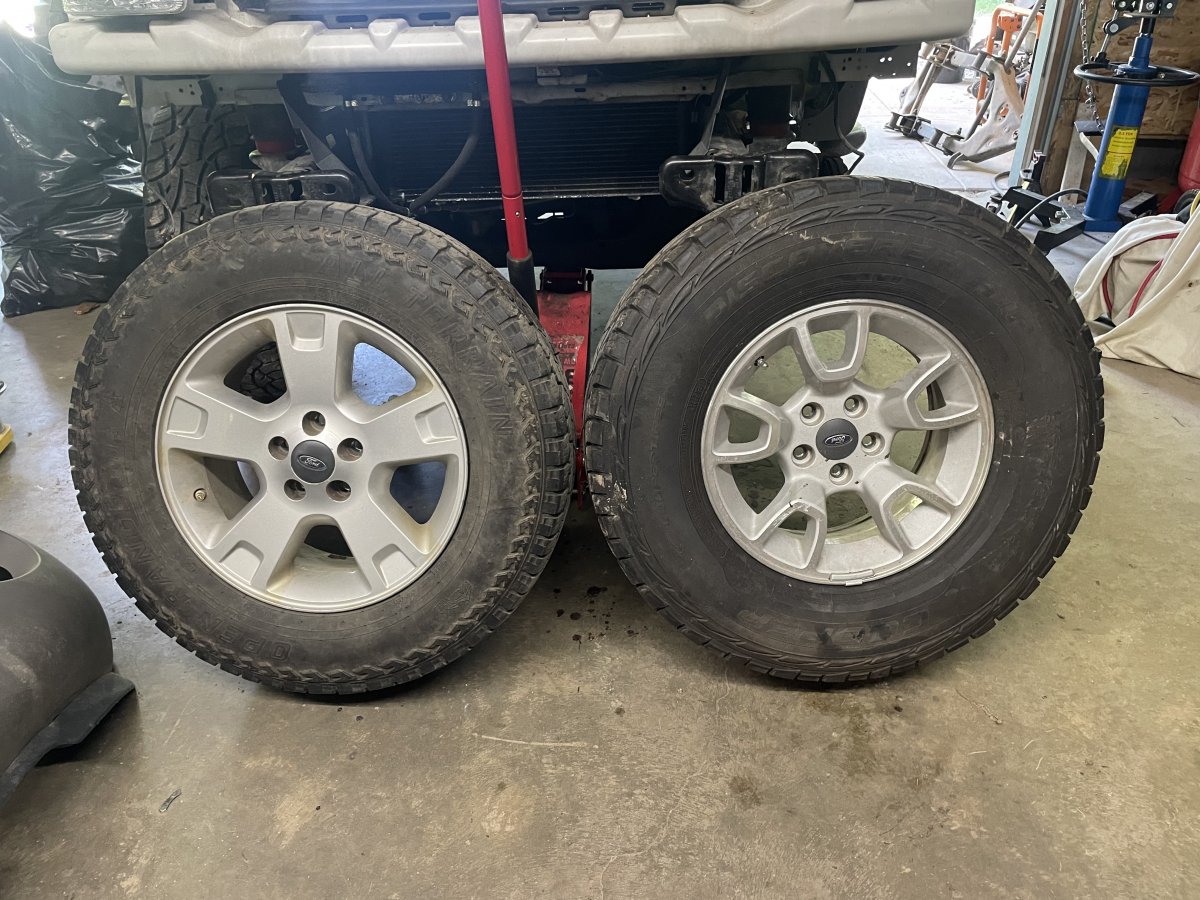

I also swapped wheels and tires for these ones.. these are the wheels from Eddiemoney 07 ranger I get to keep them as part of my pay… they have been waiting to go on this /
A trac for a couple of years now
265 /16 fit nicely! Plan is to run 285 eventually

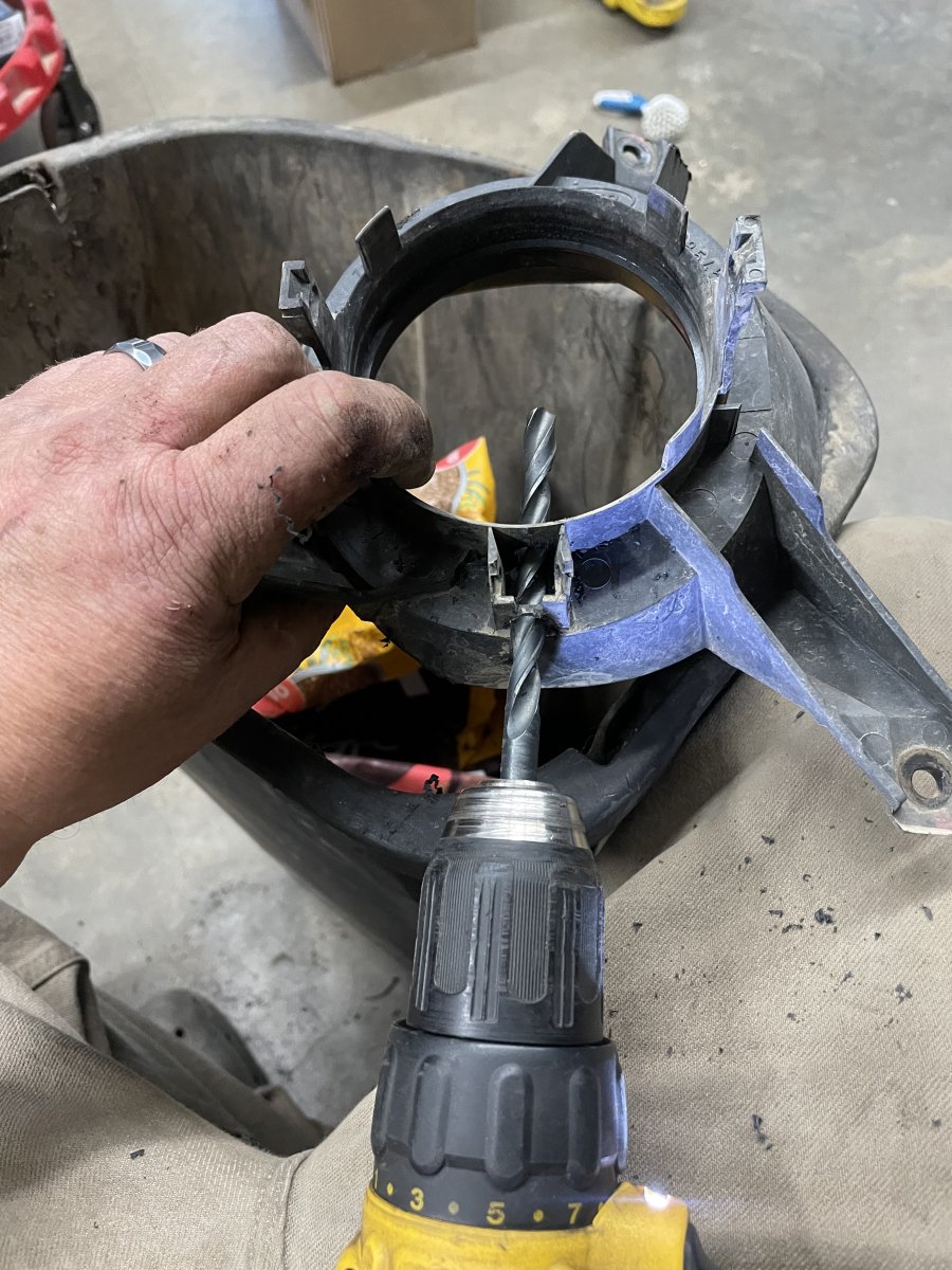

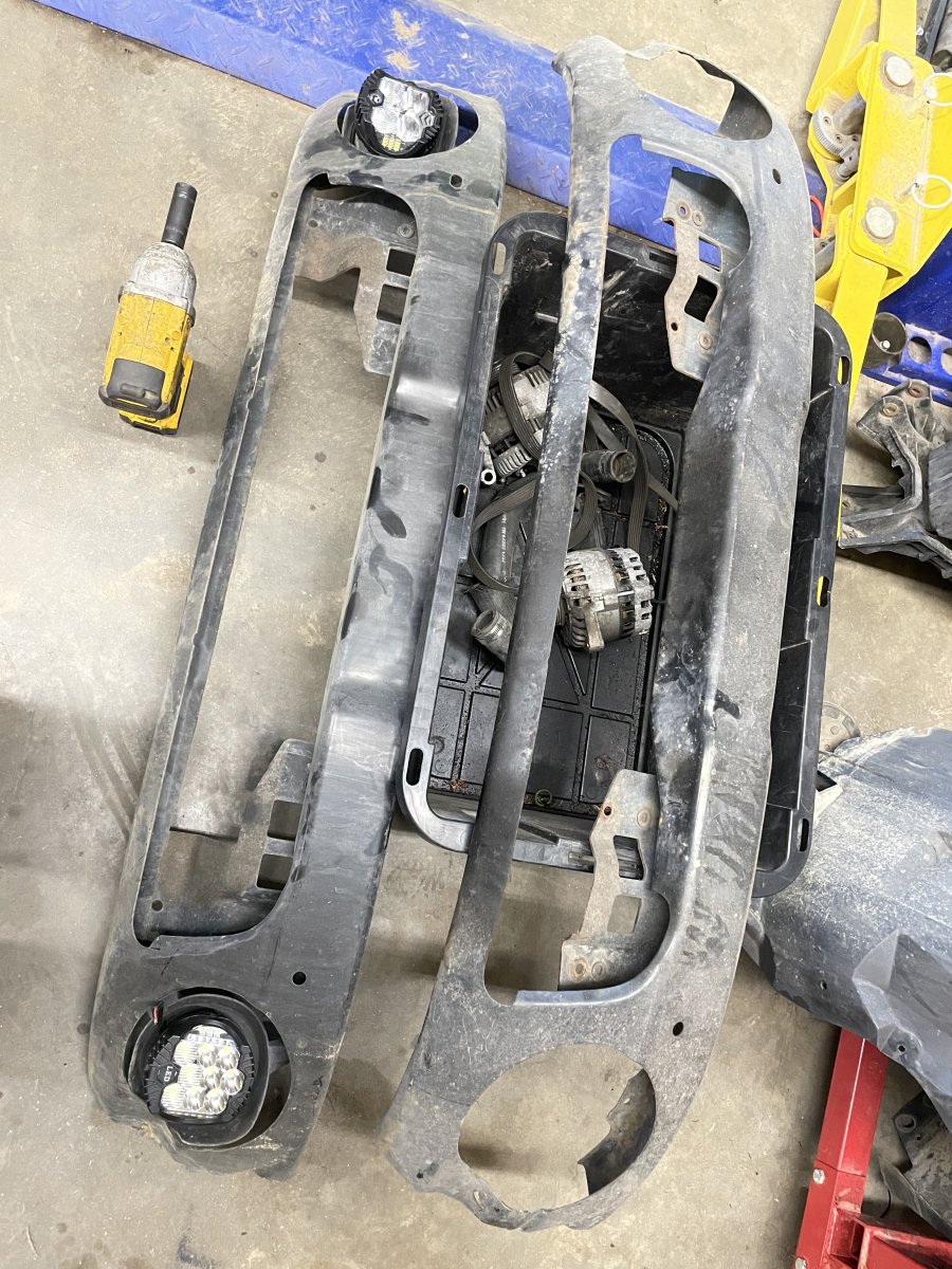

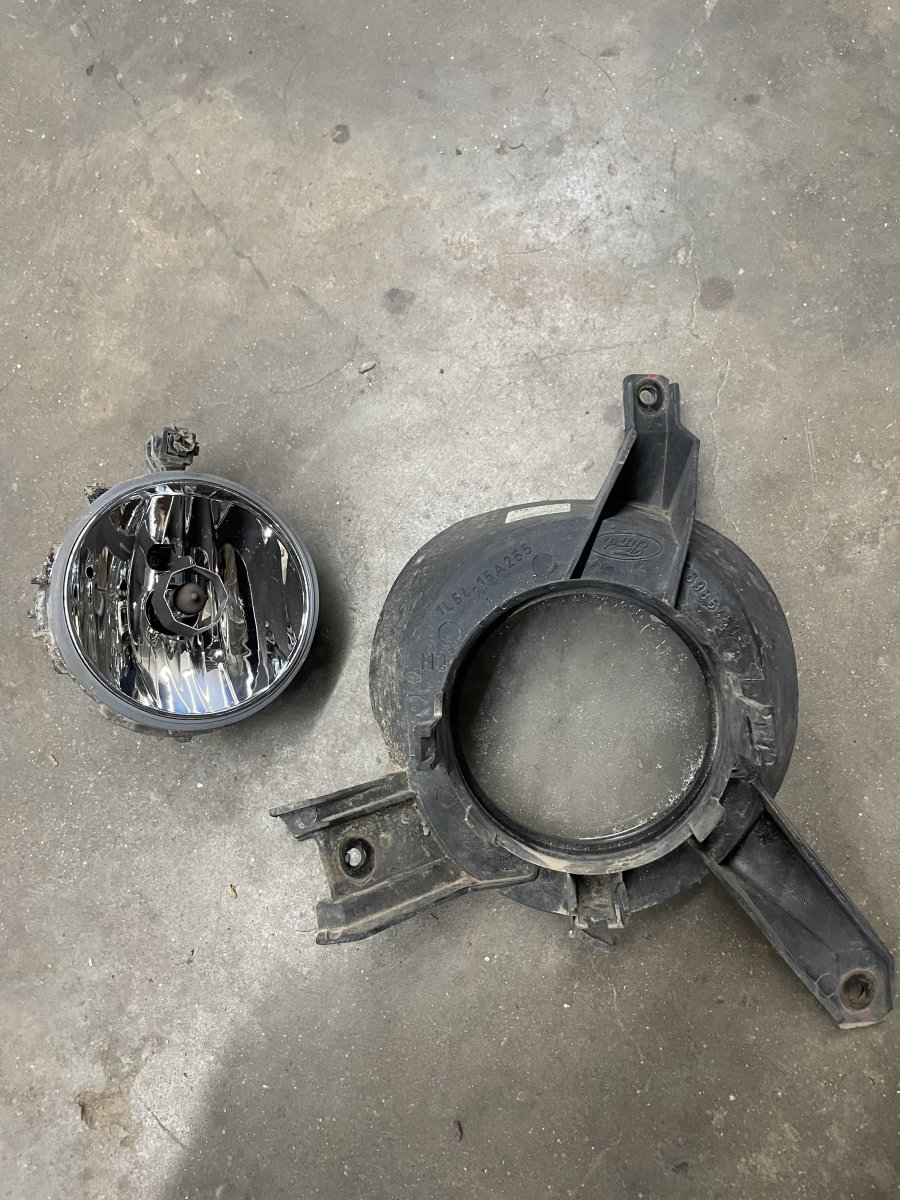

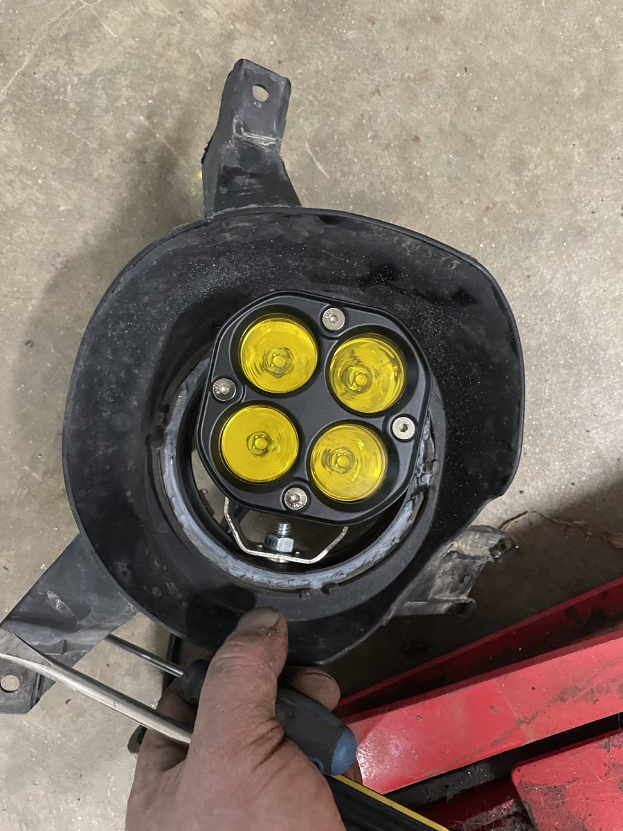

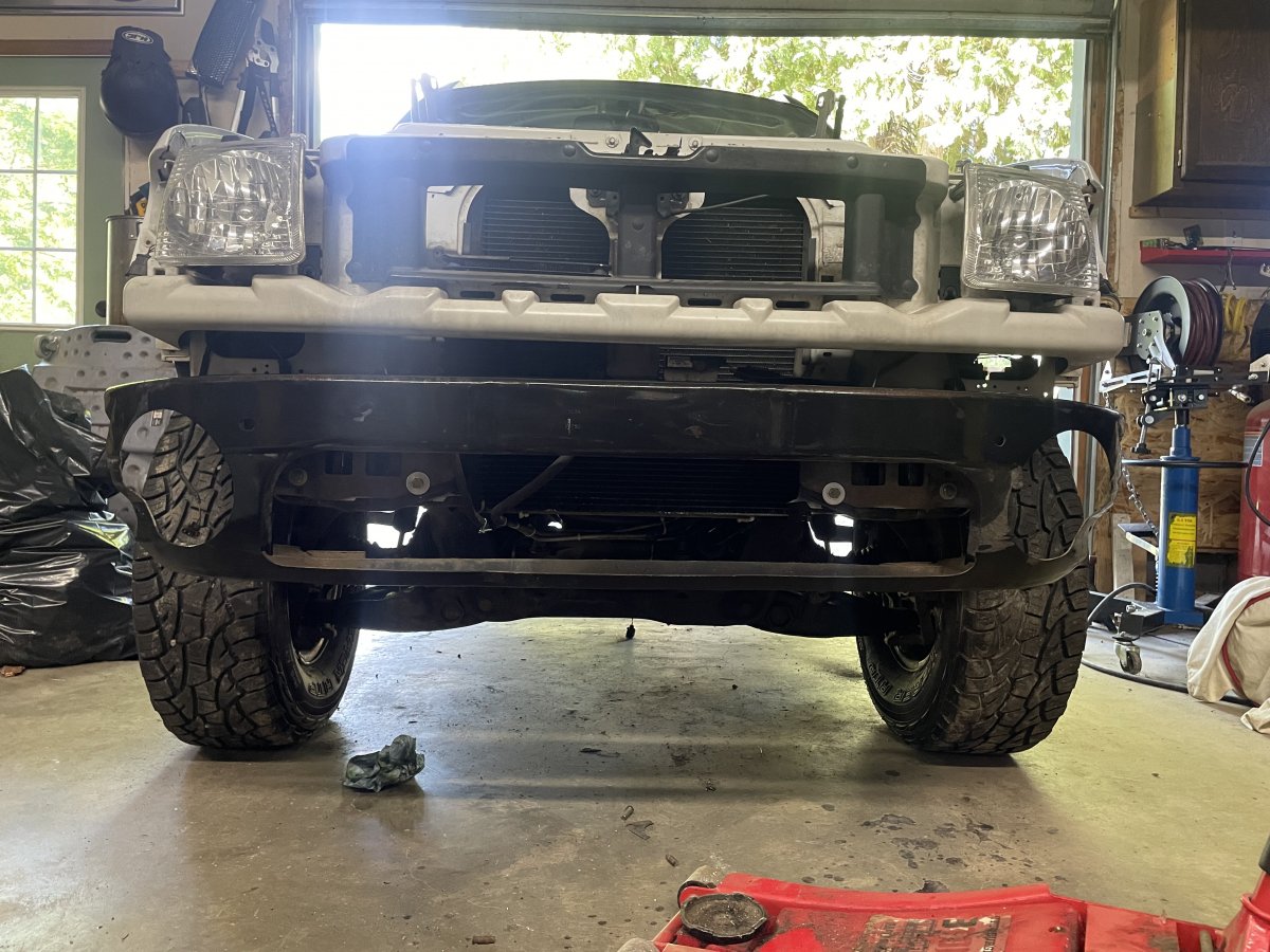

Now that she’s been road tested time for bumper. As you can see this one front bumper has been drilled 2” down to accommodate the body lift. Makes my life easier

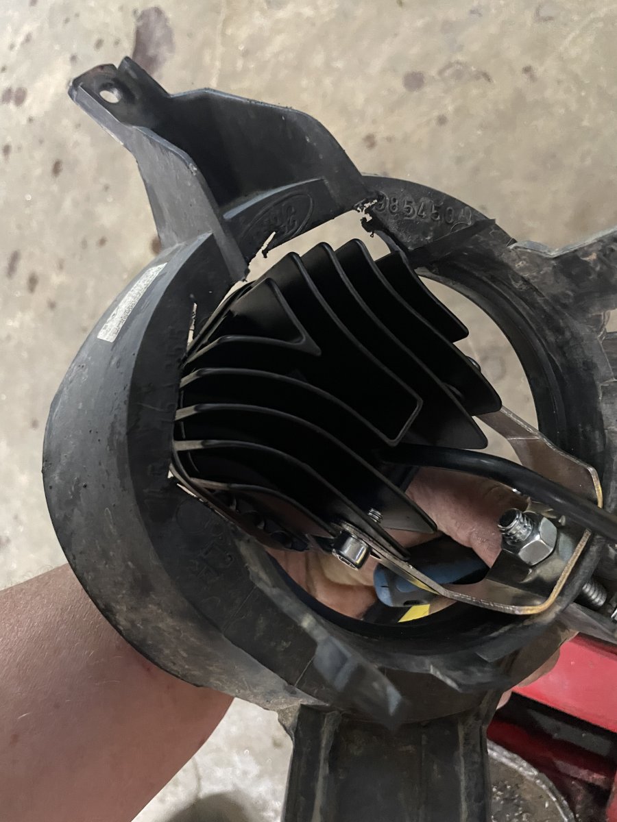

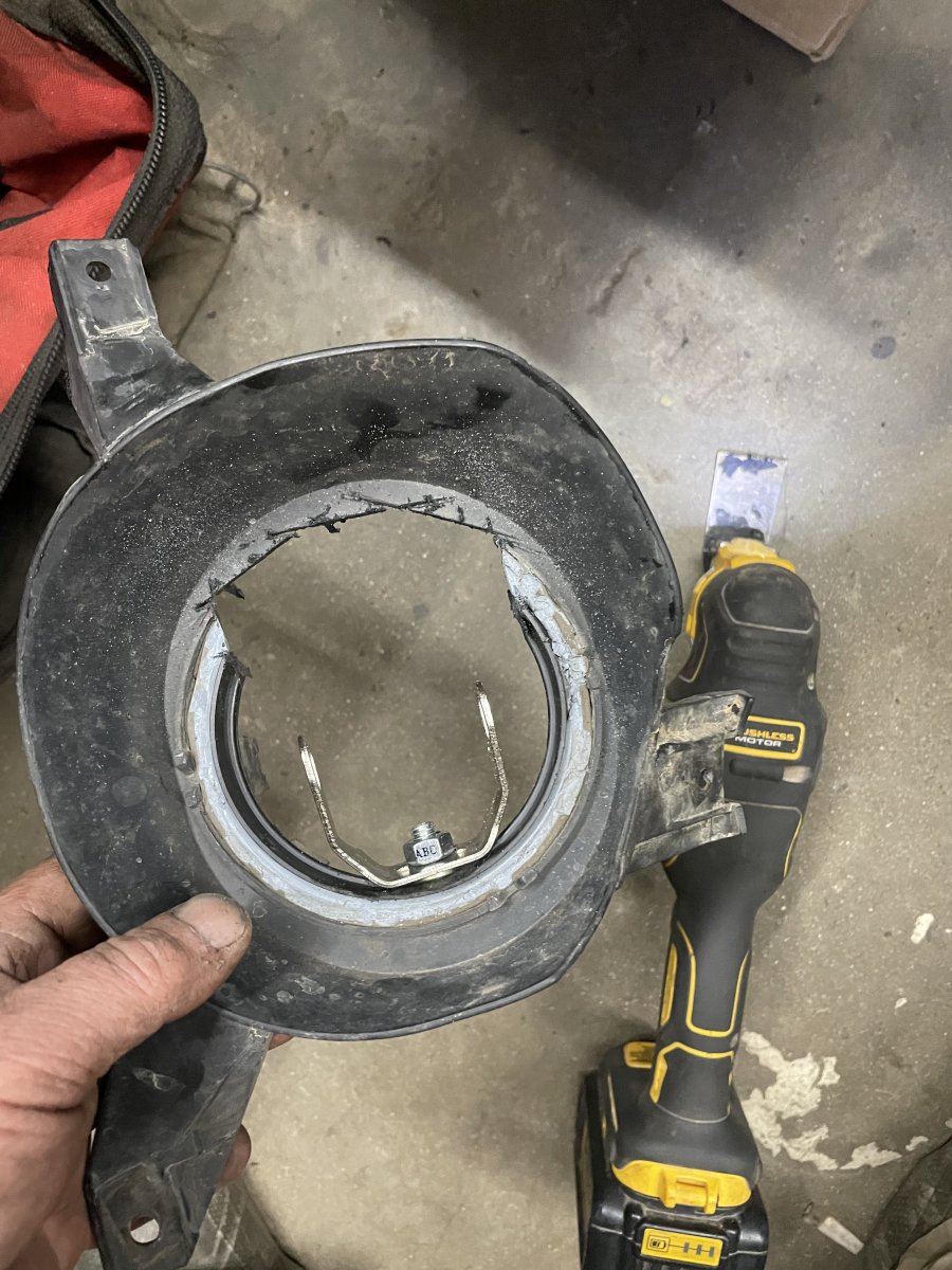

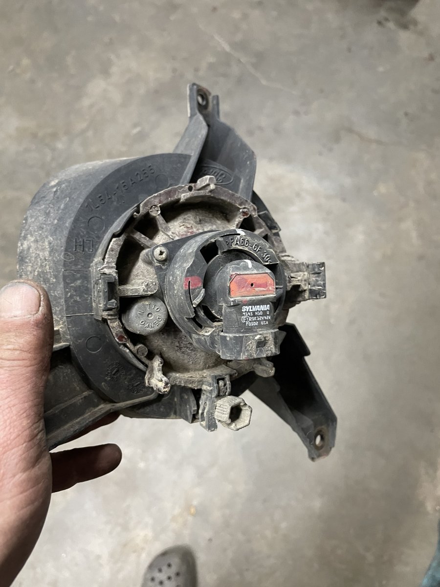

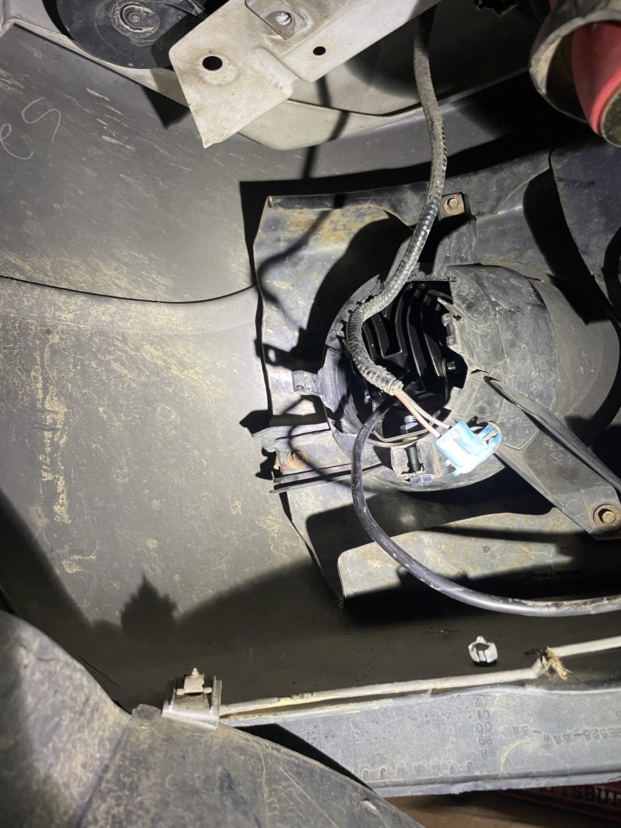

However stock sucks so I had to use my own fog lights

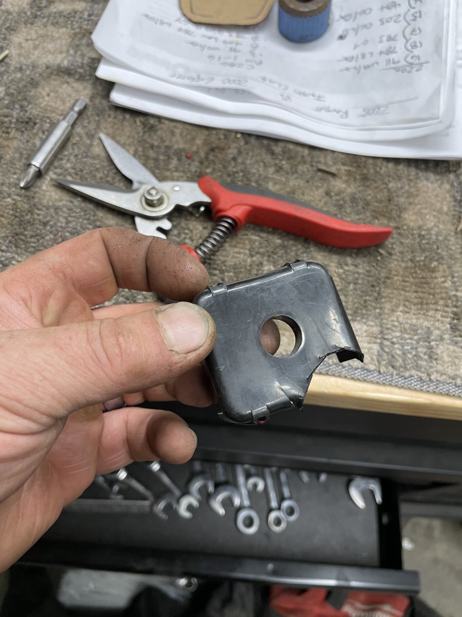

Factory light was dismantled and the glass broken out, removed
For my truck with the body lift I had to get creative to ensure the light was in the hole in the bumper cover

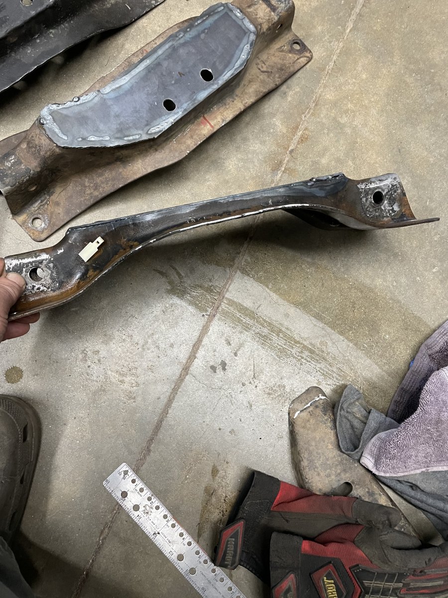

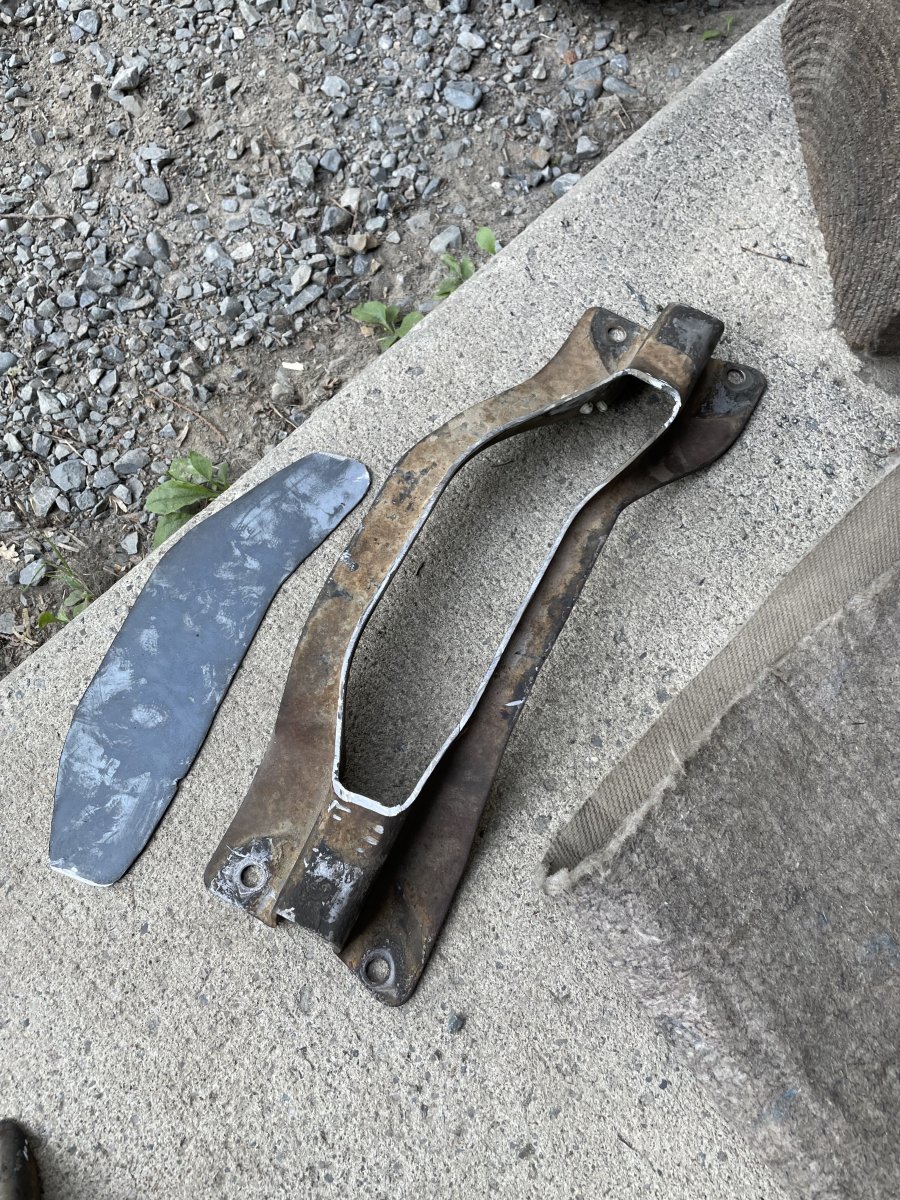

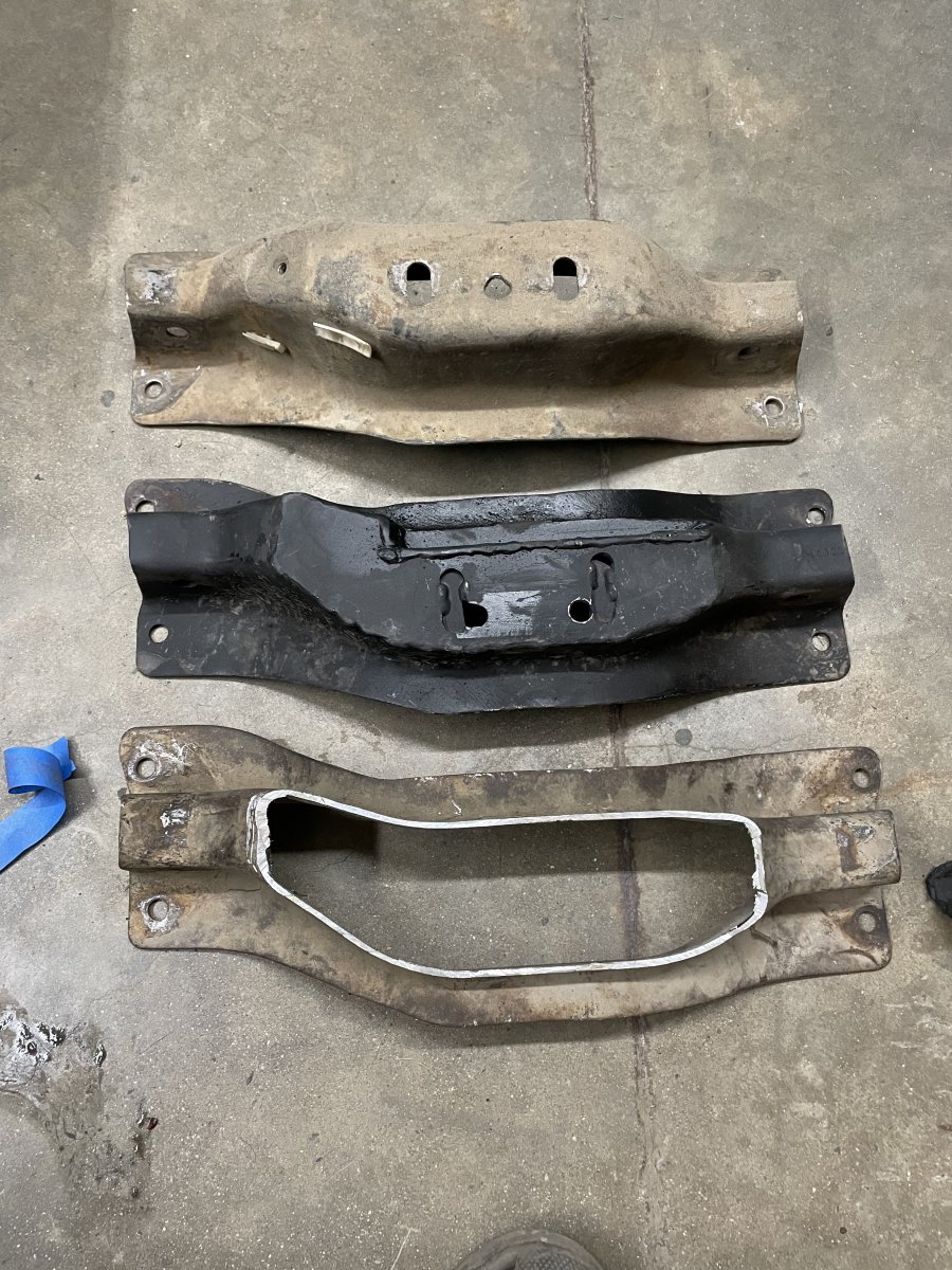

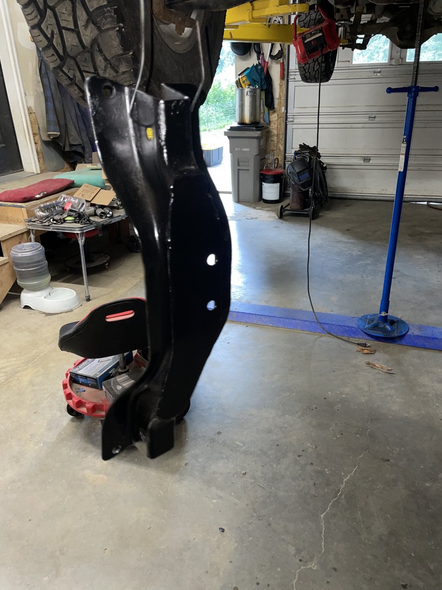

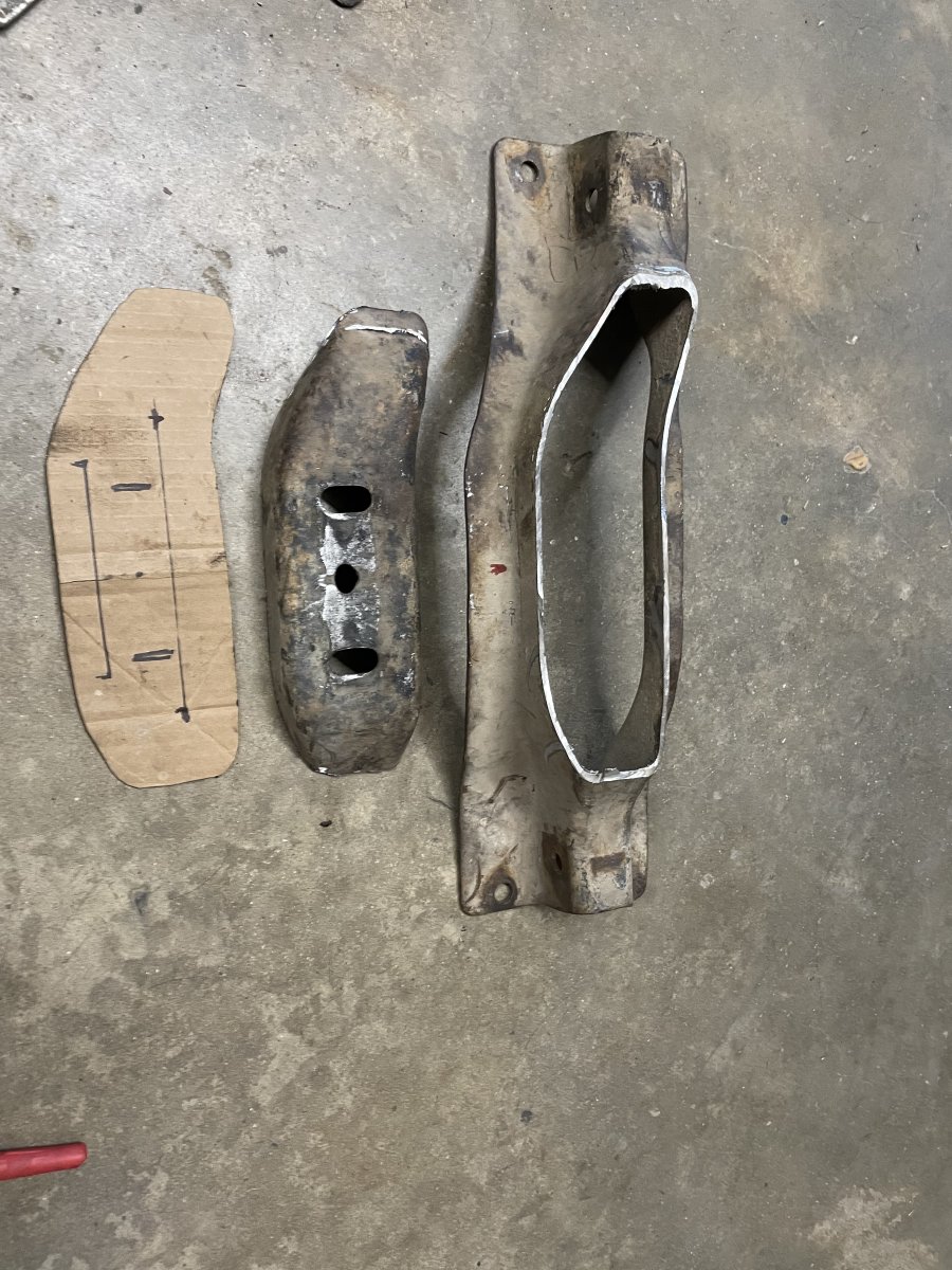

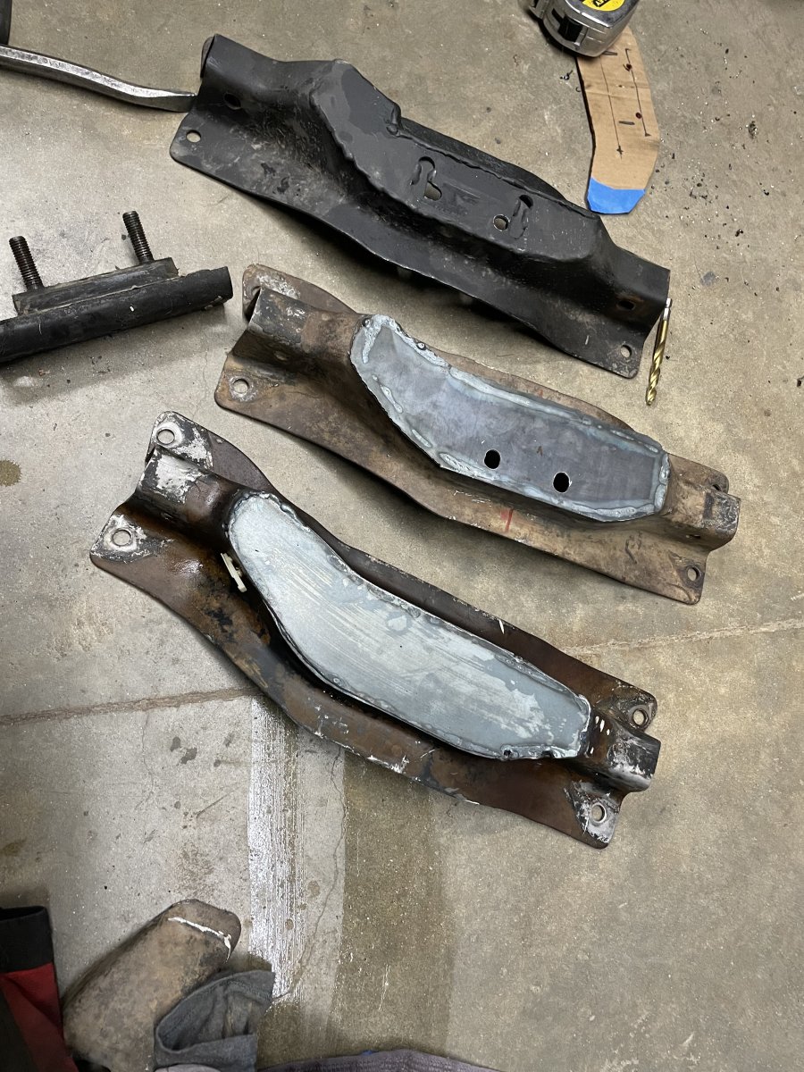

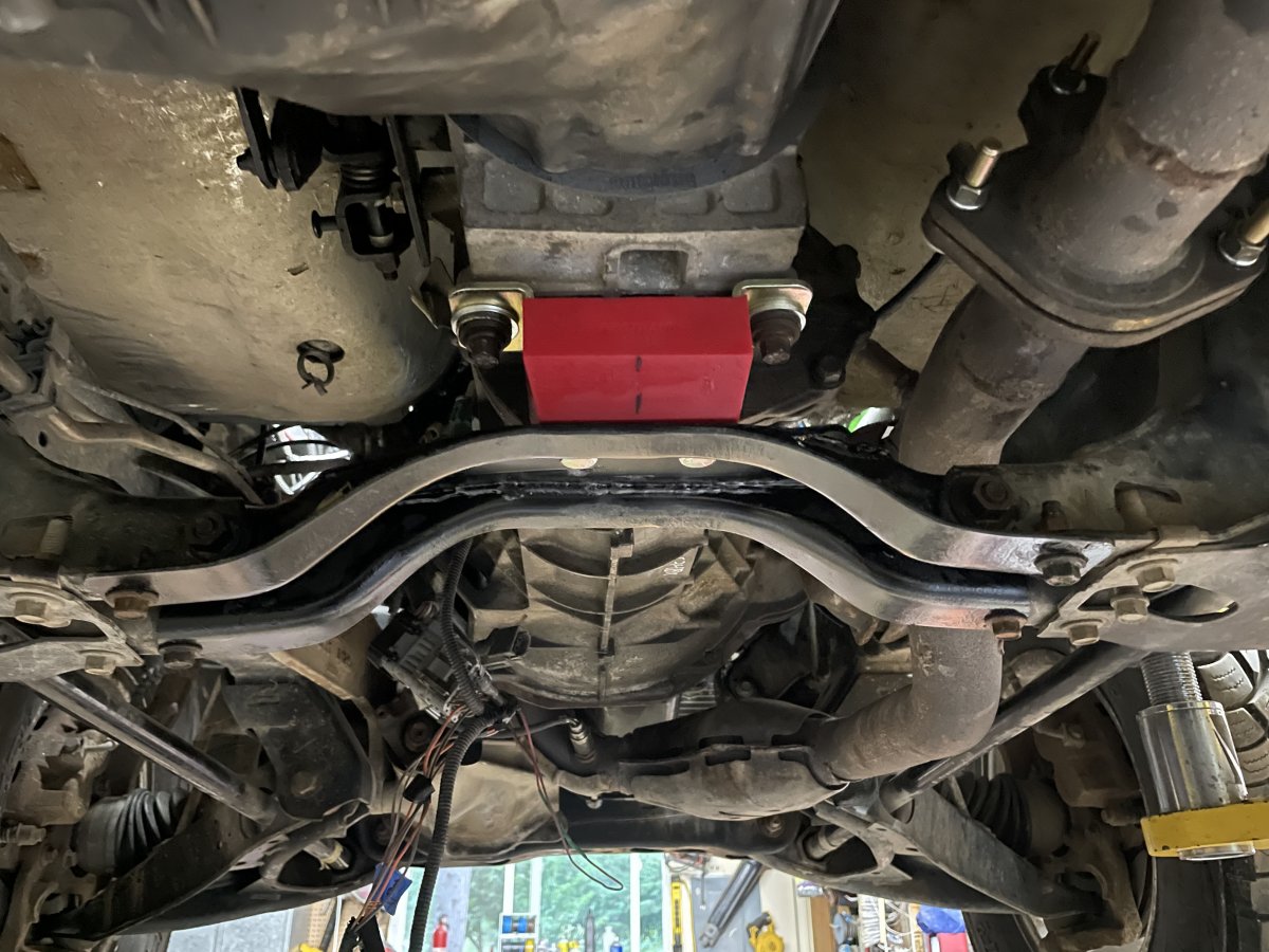

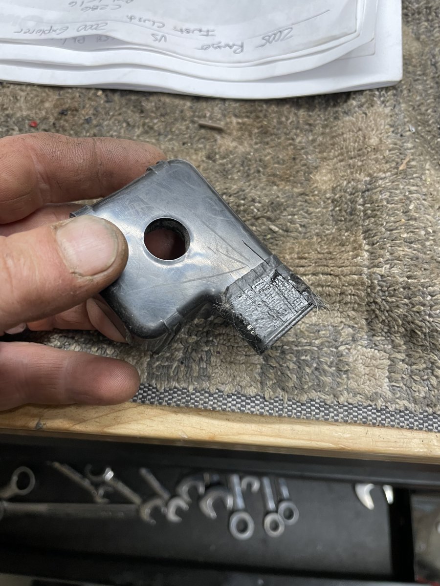

Next time to mod the trans crossmember, the one that came with the sport trac was too tall for my urethane mount
I made two at once because I need another for a 04 ranger v8 we built
For the 5 speed I dropped it down additional 1/2”

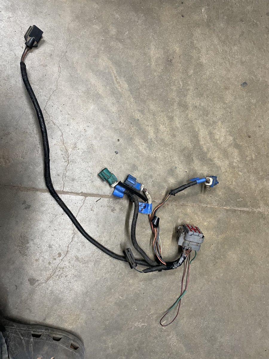

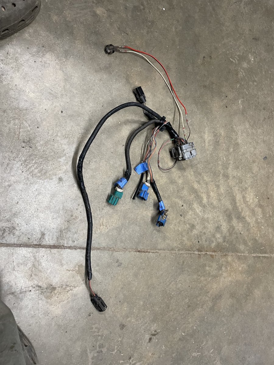

Now I have this auto to 5 speed modded wiring harness except something was missing, plug for reverse lights. So out came wiring books and I w ended up rebuilding this harness adding reverse light wires and plug??

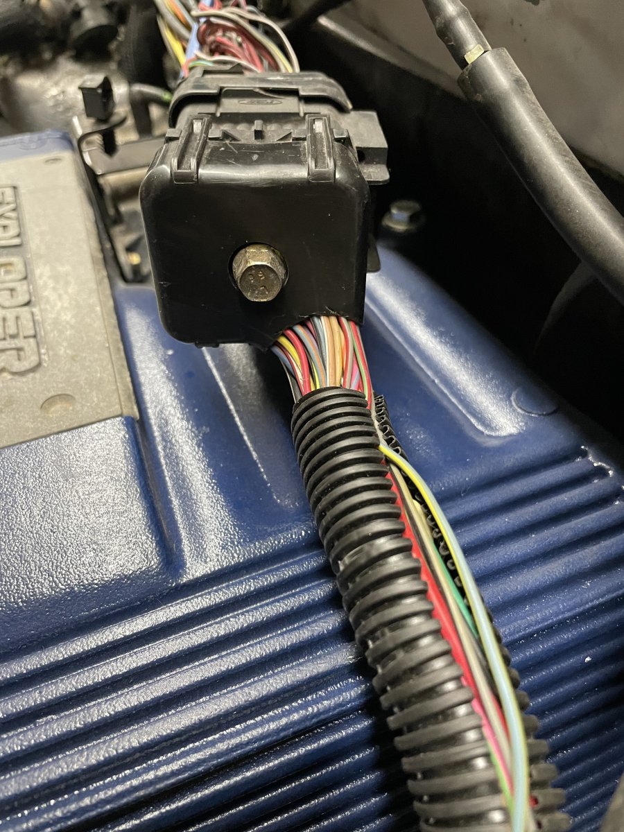

I believe I can come back later and un pin the downstream 02 sensors the catalyst monitors have been removed from my pcm. I wanted to confirm this before actually removing them

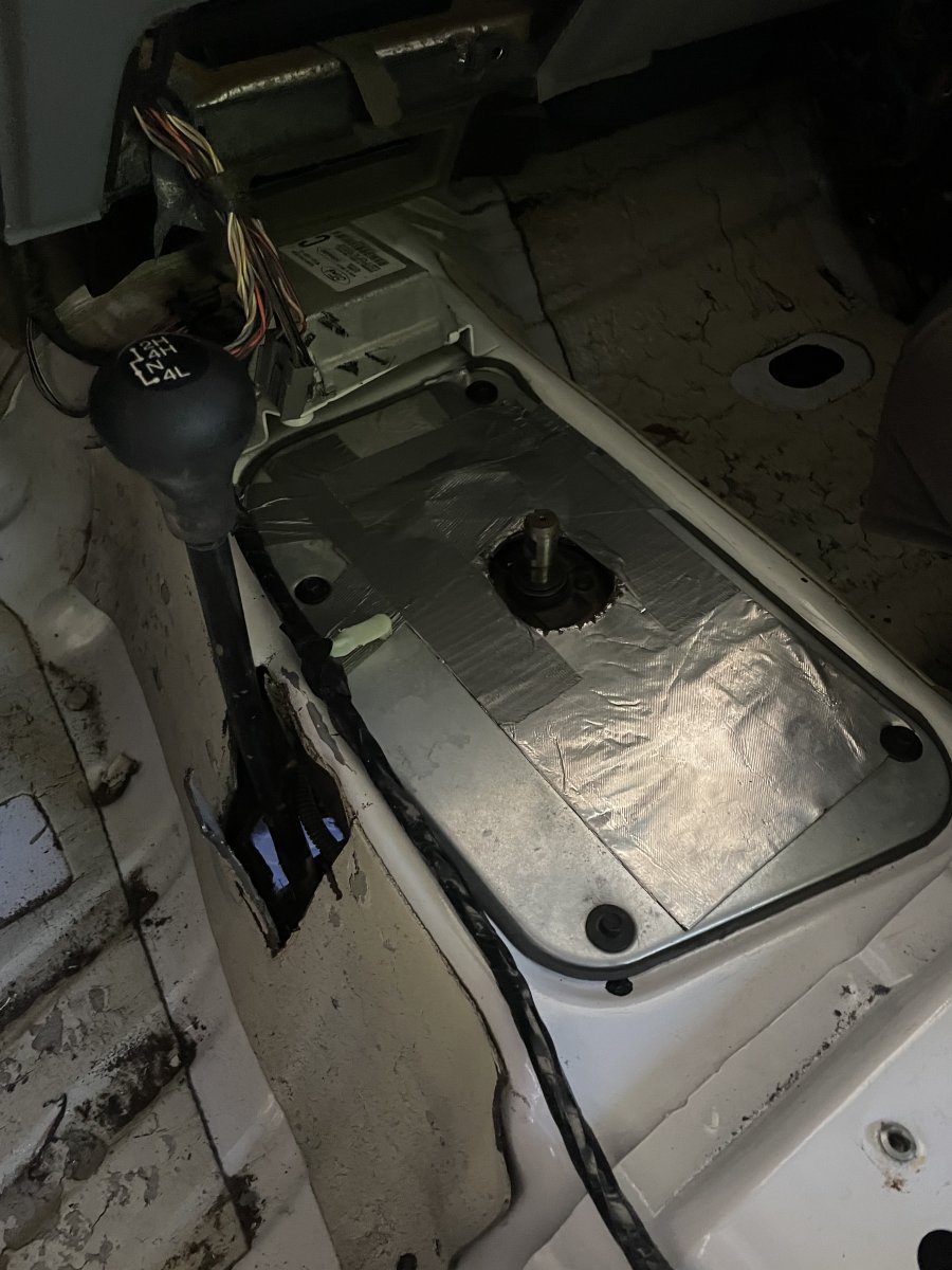

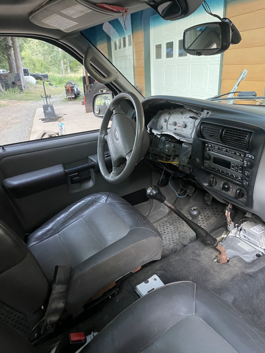

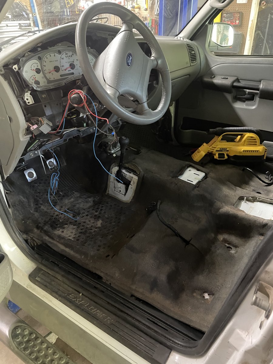

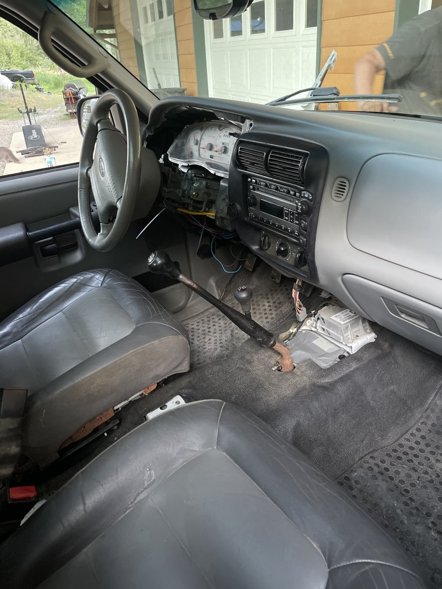

Time for a transfer case shifter

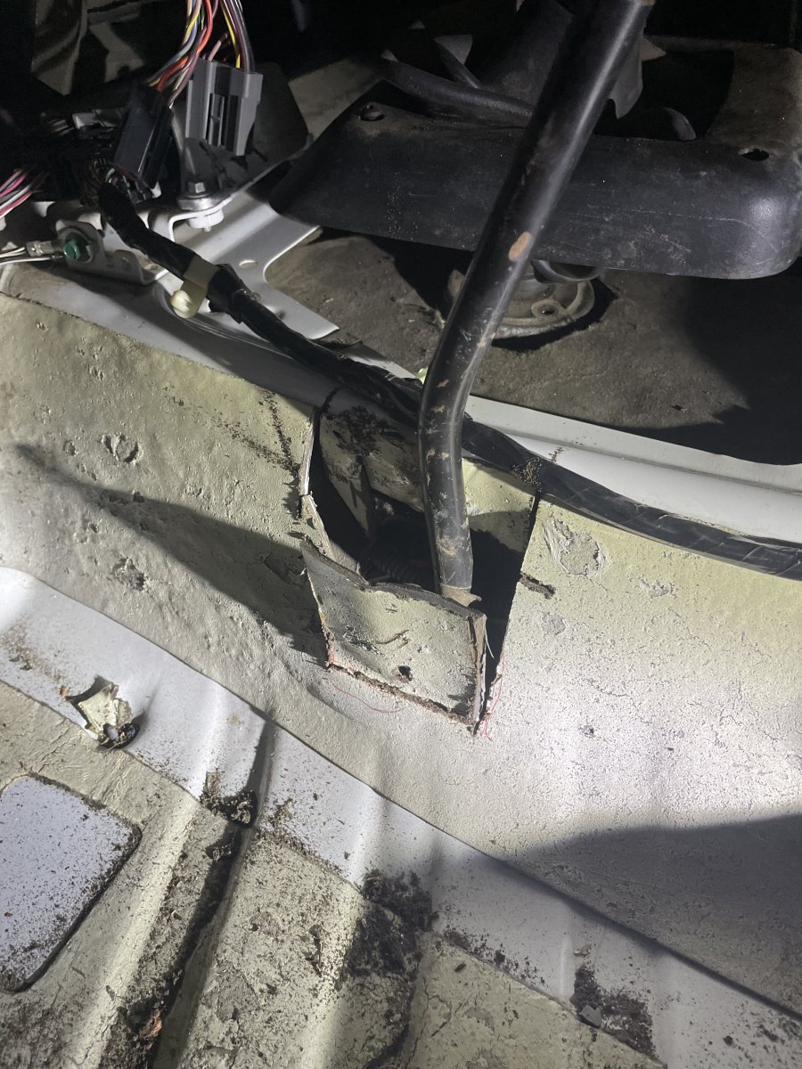

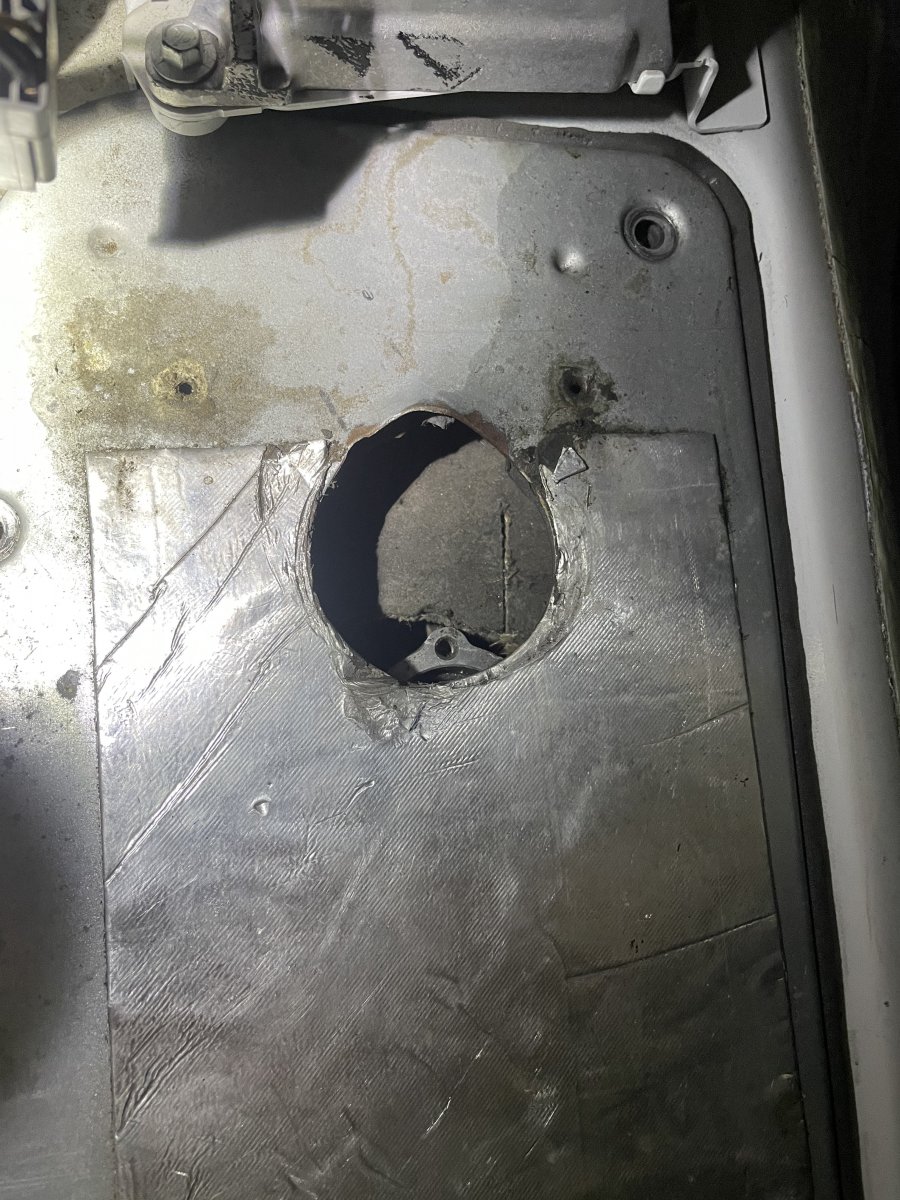

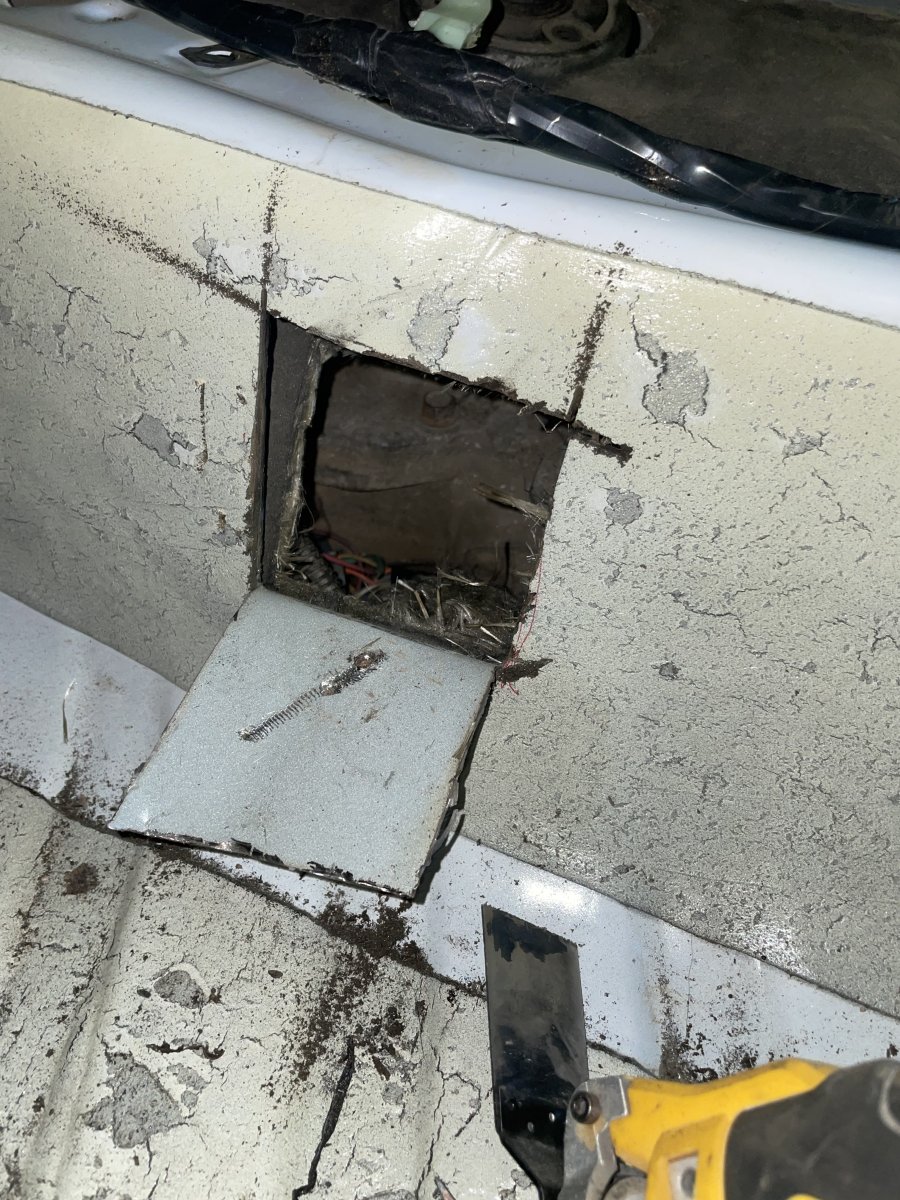

Drilled pilot hole from below then floor opened with grinder
Heat guard material removed with dewalt vibrating tool, one of my
Favs
Shift lever in and checked for clearance
Hole
Finished up
Metal
Bent to clear (bfh)
Time for a floor plate
What the heck?? The plate I have from the other sport trax is off 1.5”?????? Friggin wild! I used a different m5od-r2 the shifter must have moved??? Anyways I like it better a little further back. Tried wrapping my head around this 1996 vs 2004 same trans. Had to
Modify it and install
Both shifters in happy with location time for a floor and seats

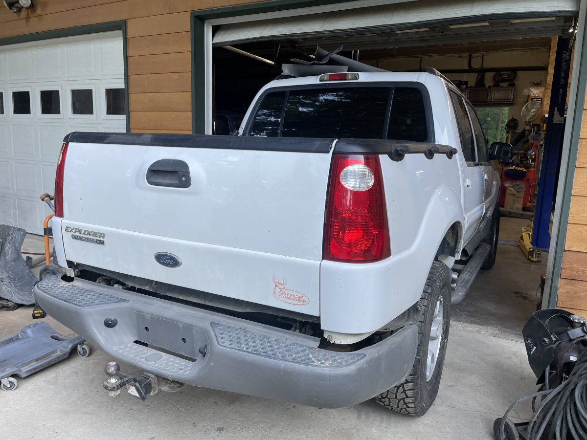

Super excited w the prospect of driving this sucker the next day time to install the bed with 2” body lift
Pucks… unfortunately I used a mis
Match of

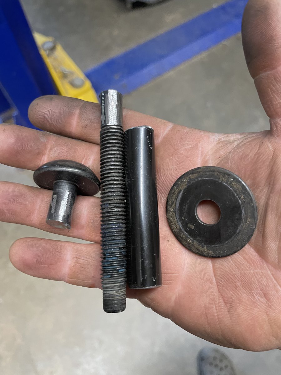

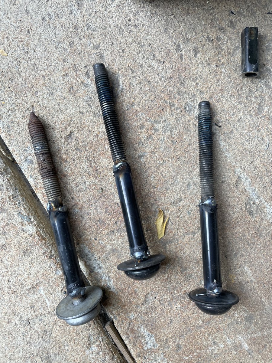

Bolts when I installed body mounts and body lift left me with no bolts for the bed! So I had to make some.
Extended factory bolts 2”
Bed is on! Still need to move back bumper up 2” no biggie
Reverse lights work like a champ!

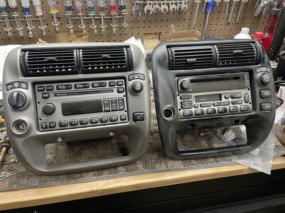

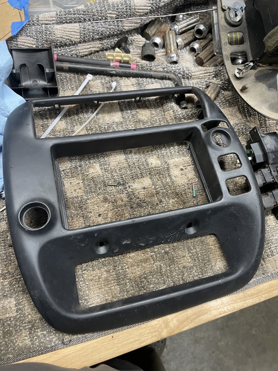

Now that she’s a 5 speed with manual t case we need a bezel! So I made one.
Deleted 4wd switch, added usb ports,
Replaced rear window defrost w second fog light switch (will use for
Off Road lights) and changed the rear wiper spot to a proper sport trax rear window switch

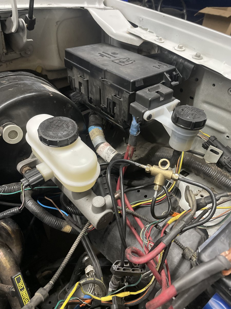

Me! Pulled her out of shop checked things over no leaks… check brake lines 500
Times no leaks. Bled
Clutch slave bled brakes
Time for test drive, she runs so nice! Sounds *****in
Mounted the clutch reservoir

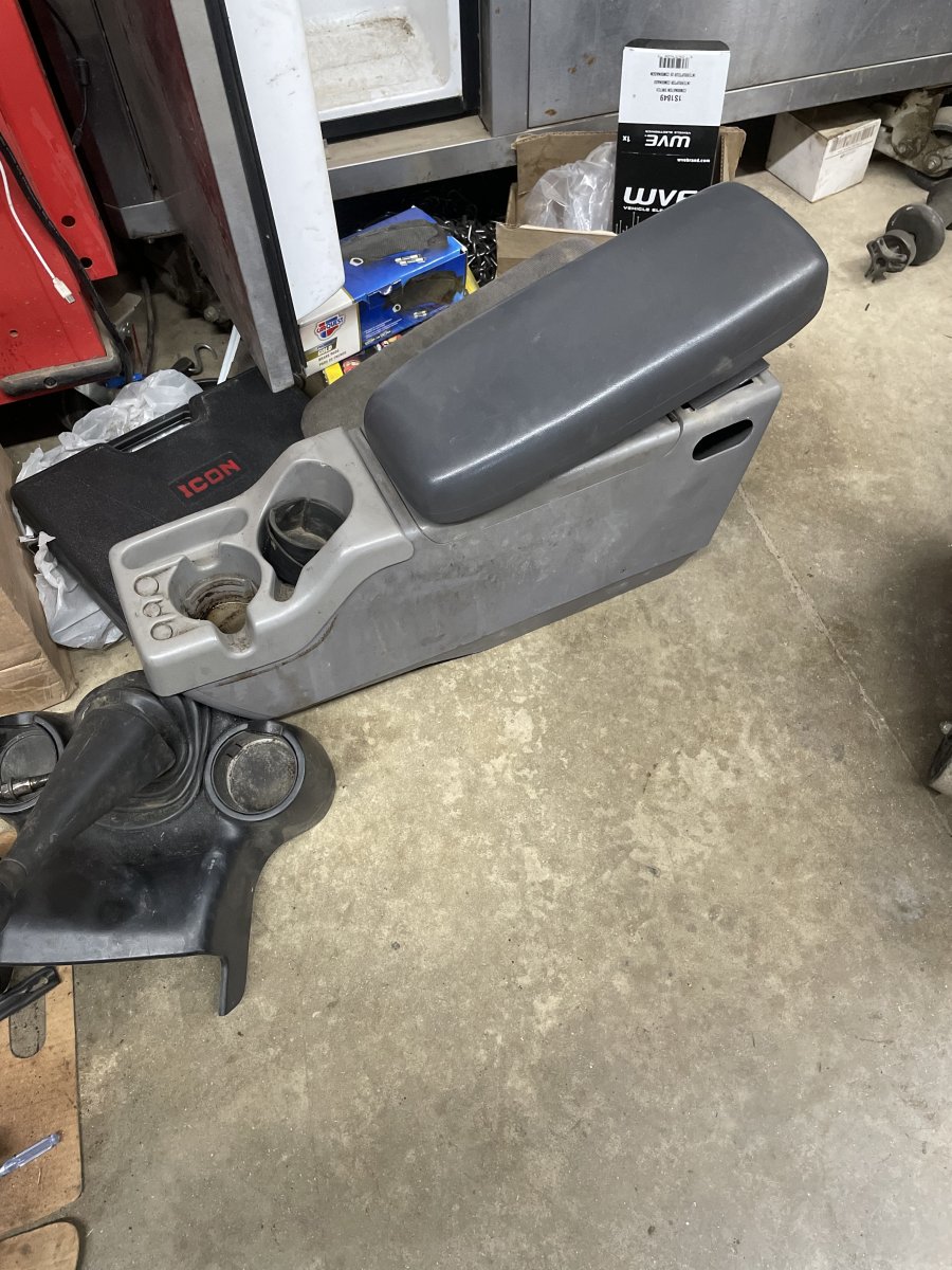

Center console shift boots next up. Modded front d shaft to fit (4.6 shaft shortened 1/2” by removing 1”
From slip yoke)
From slip yoke)
Do you do this for every 4406 swap? I know I've heard to use the 4.6 Expedition front shaft, but I don't recall seeing anyone cut it down before. Also, did you have to run a 1310/1330 conversion U joint at the axle?
Thanks for all the detail on the trans x member and reverse light wiring!
The black sport trac had a 96/97 trans in it, I ended up using one from an 04 the shifter moved a bit between those years
I bought some driveshafts from a buddy who parts out f150 I have no idea what this shaft came from but it was too long by 1/4” or so. My fix when this happens w to shave the slip yoke down 1” gives the clearance needed. Yes it will need a conversion joint or change the yoke on the diff side. Conversion joint has always worked well for me… I’m cheap hahaha

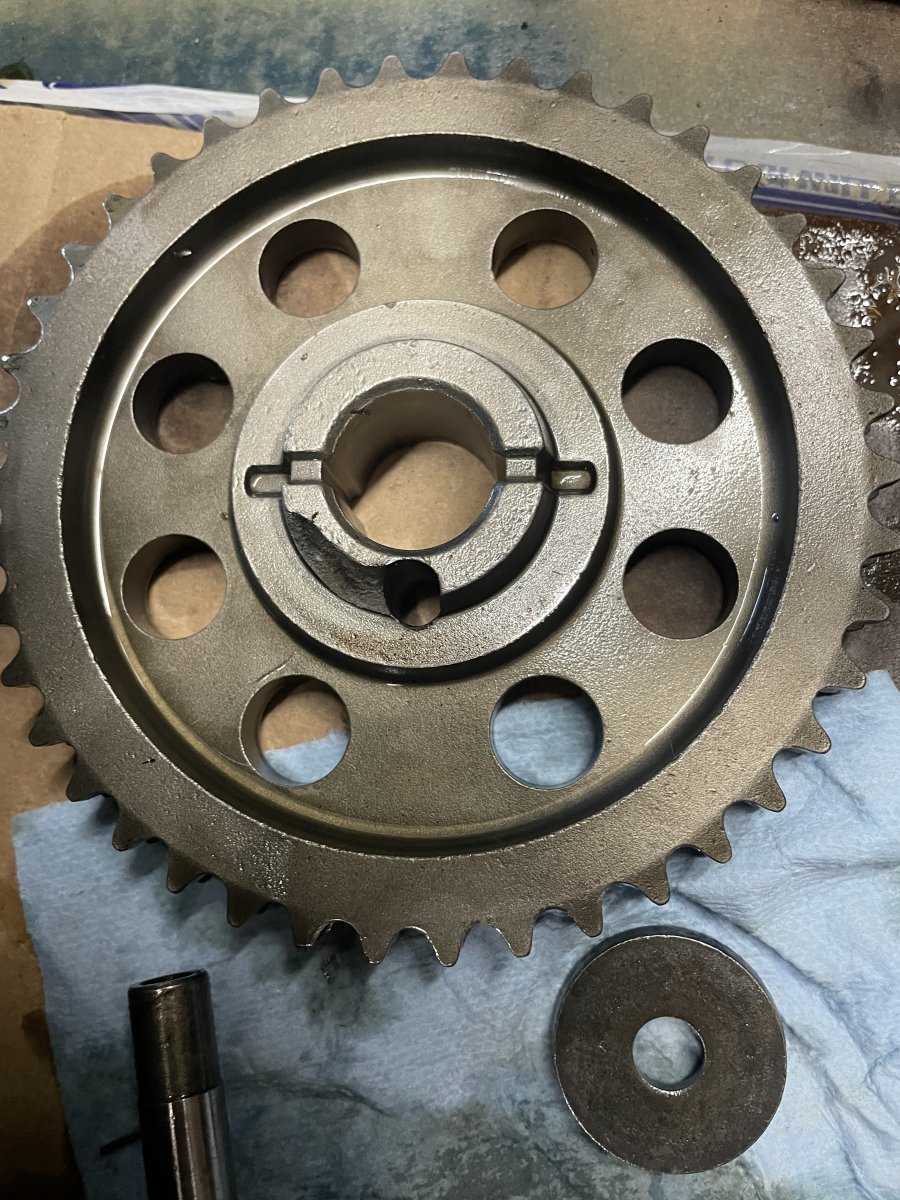

thats odd. i have had a cam dowel break off but the bolt held the sprocket in place. i think there might have been a defect there.
want a 347 eh. i know a guy that has a spare sitting on the floor. if i am not wrong the same guy is having a hell of a time getting his truck running after putting a terminator x max in it.
Want and need are two different things! Haha someday I will have a stroker

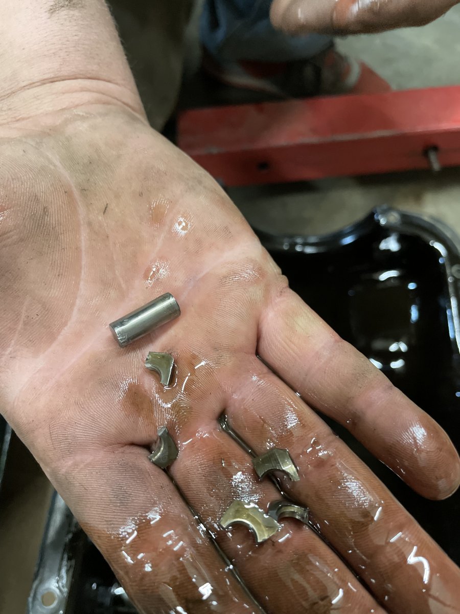

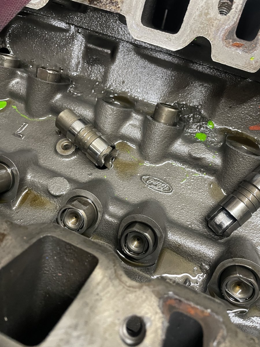

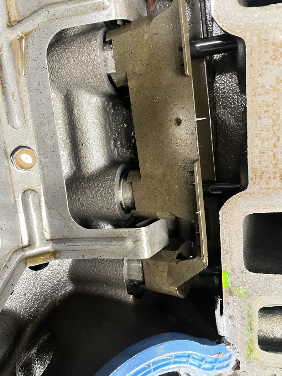

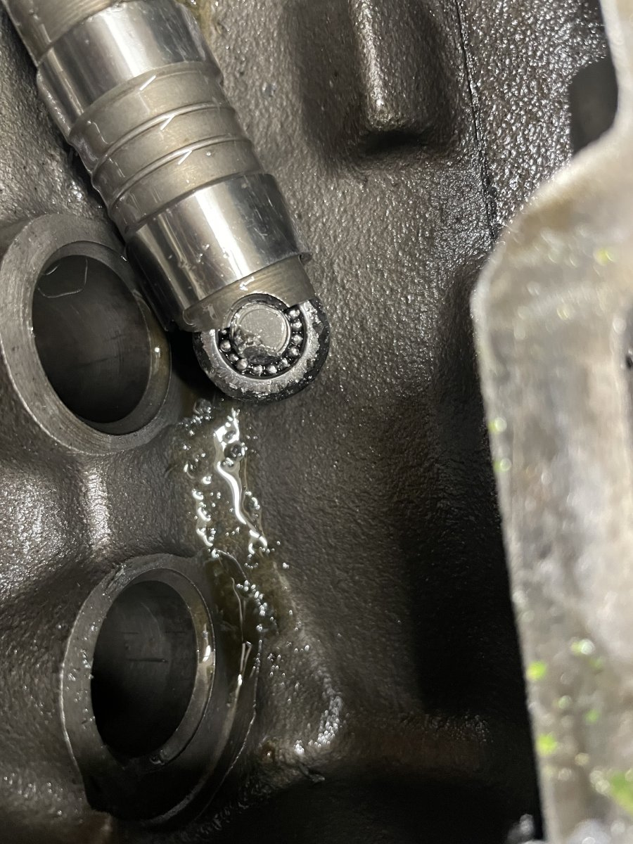

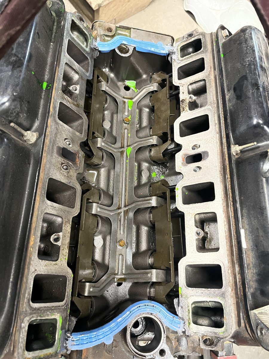

For now more carnage! I either forgot to torque the cam bolt (very odd for me) or a mix match of timing parts caused an issue? I may never know

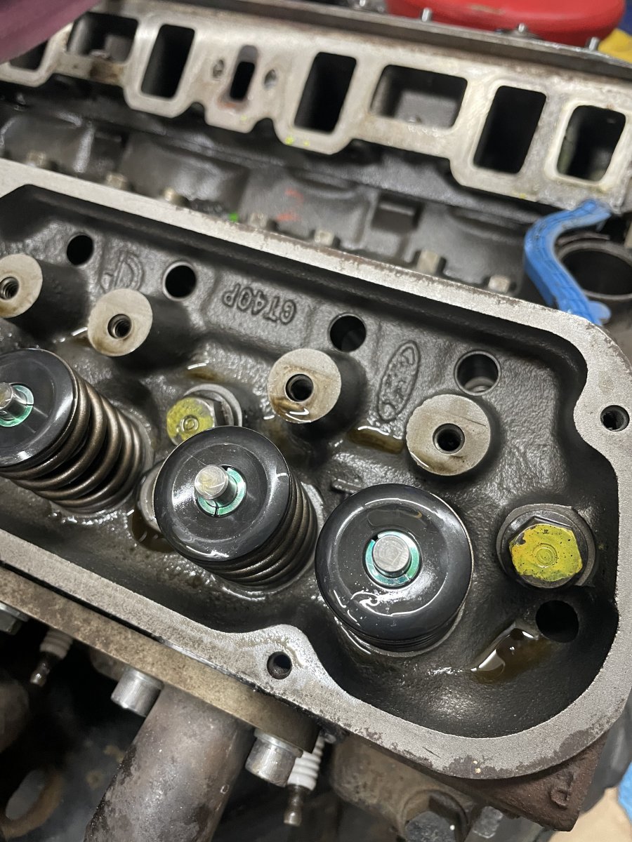

The camshaft walked back far enough to where it destroyed some lifters
Trouble in paradise
Pushrods all seem okay at first glance
All springs made it. I may just need another $530 cam
She’s on the stand now so I can pull the heads FromWhat I can see lifter bored still smooth? Longblock Maybe can be saved we shall see

dono broke a lifter, it jammed the cam, which broke the dowel for the gear, which made a mess. dono had no luck with his truck and he didnt nothing wrong. he sold it to me, now his black cloud is over my truck.....
