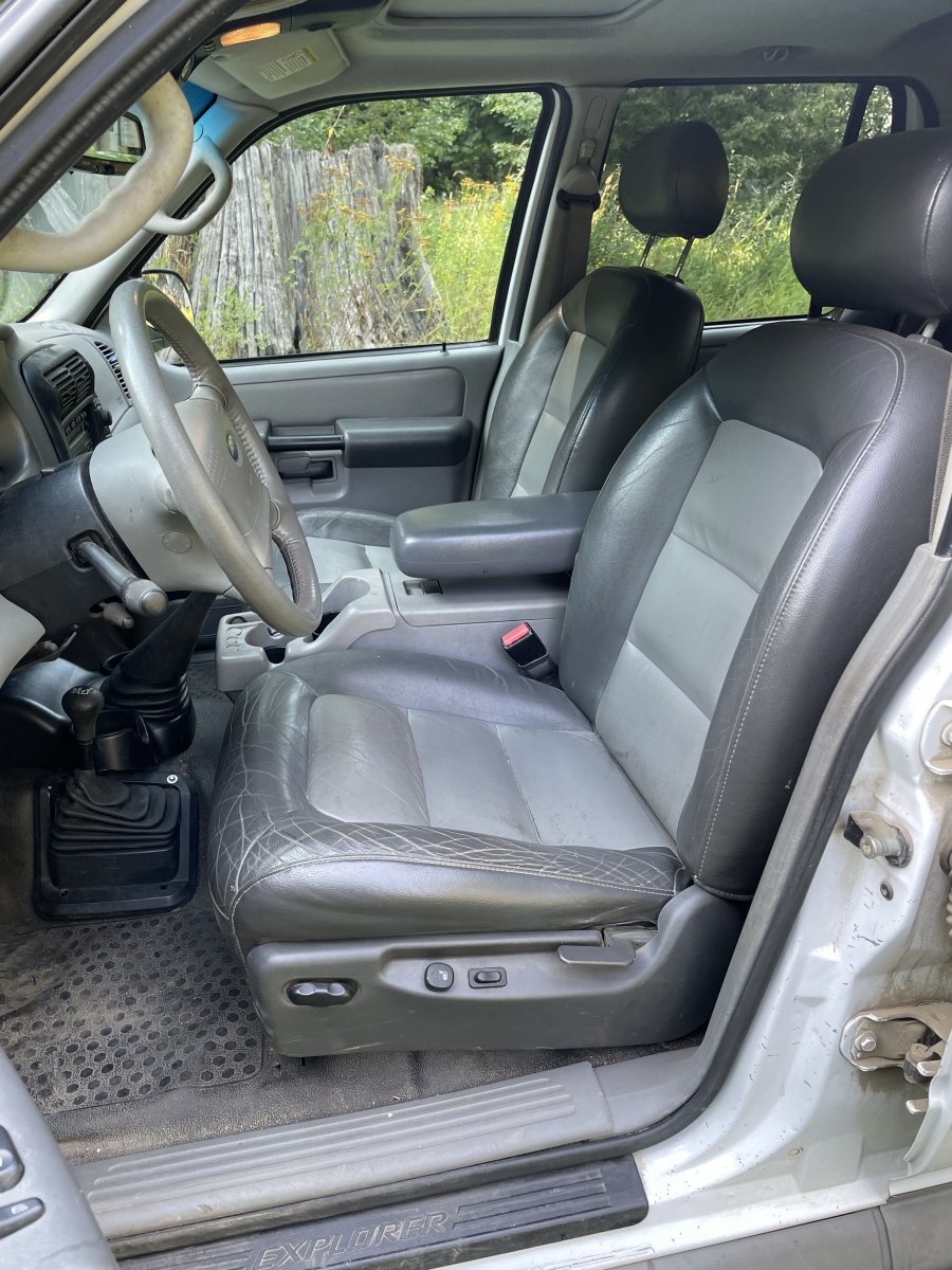

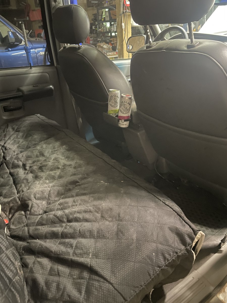

5 cupholders front
Two back!

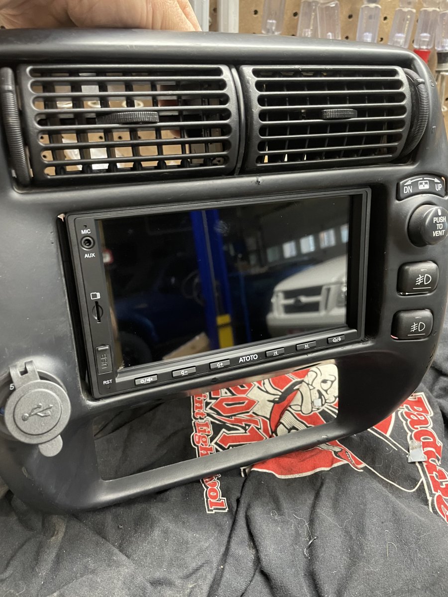

Wife ordered me atoto w rear camera! $165 on amazon woooohooo

Nice, and I hadn't thought of that, where can I find a column cover trim without the shifter hole? I'll need one for my 98 project Explorer.
5 speed sport or ranger has the steering column bits lots of 5’speed rangers out there. These parts are almost always black, very rare to find tan or grey
Works for me as I will eventually install 06 ranger steering wheel to match (black)
I recently had the realization most if not all manual Rangers had non-tilt steering columns, whereas the manual Explorers had tilt steering columns (or at least mine does) like the auto Explorers. What I need to check is if you can screw the bottom half of any Explorer steering column "shell" (with slot for tilt lever) onto the top half of a shell from a manual Ranger (with no column shifter opening/boot) -- I'm betting you can. @410Fortune I'm assuming you're just going to leave the key interlock push lever out and the small rectangular hole will stay open?
Things are looking good! I'm a big fan of mixing and matching OEM Explorer, Ranger, etc. interior parts to get an "OEM plus" feel. Keep an eye out for a first gen limited console cupholder piece. They have the cups side-by-side instead of forward and back and are more "curvy" like 2nd gen interior styling (they fit better in 2nd gens than the actual 2nd gen consoles IMO). The first gen limiteds also have leather armrests for the half console and make an easy upgrade.
I could install the little key out lever but it would be just for looks. So I’m thinking of using that square hole for something else down the road… maybe mic for the speaker phone? Something clever like that. Right now there are a few “holes”‘in the interior there are spaces where the old cruise switches were in the steering wheel and then this hole… I can close them up with some
Black plastic if needed

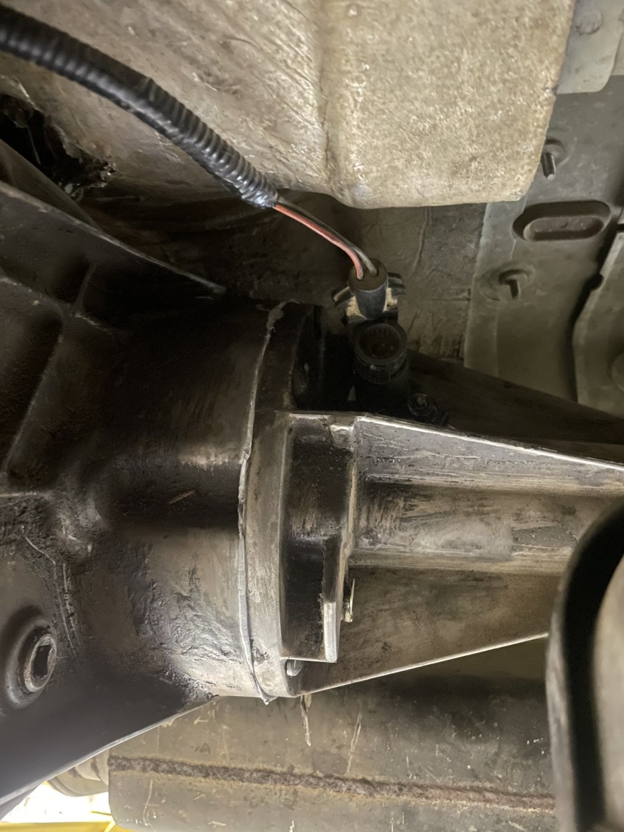

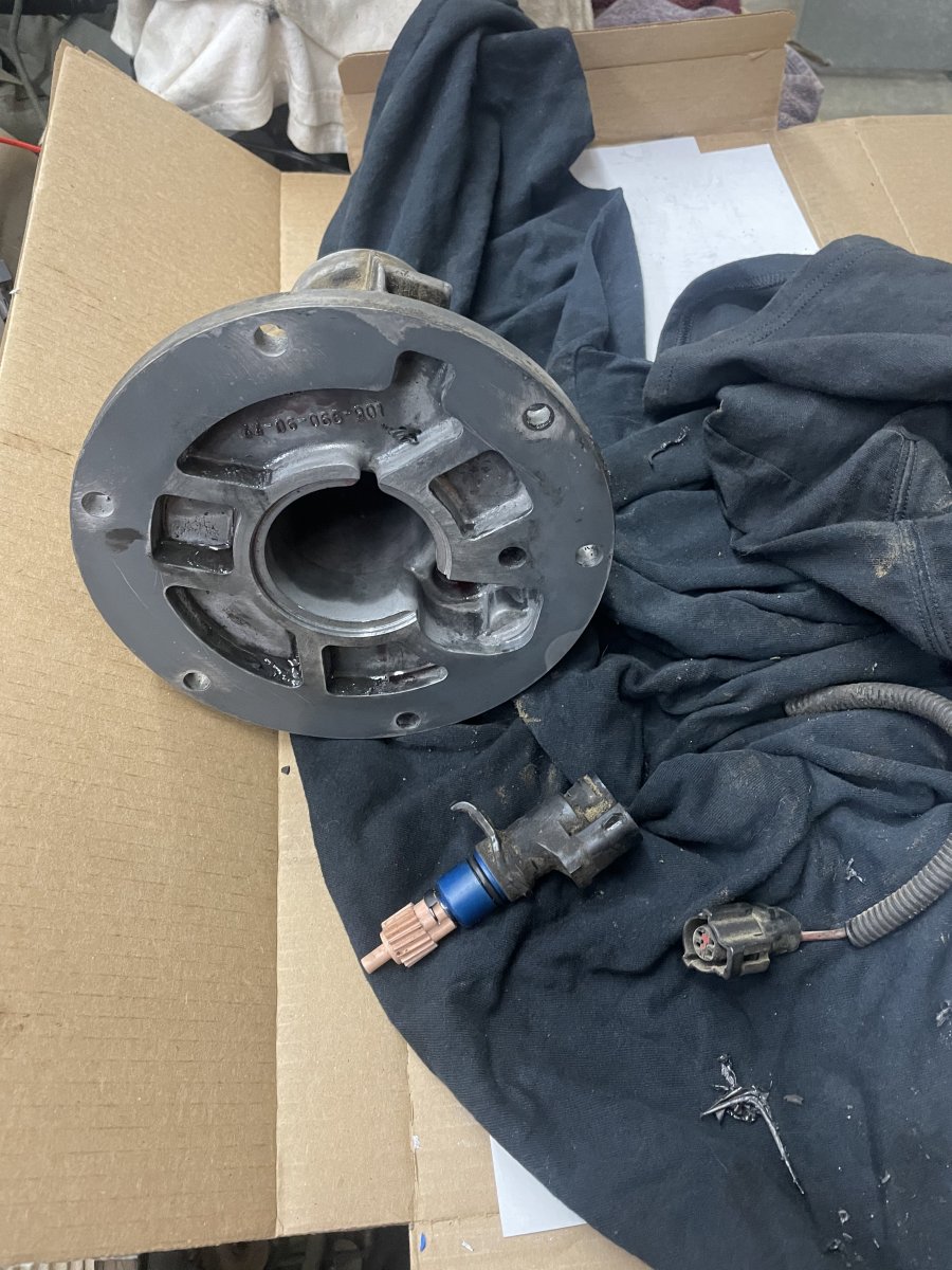

Speedometer is now working
I also wired the clutch switch to neutral wires so truck won’t start without clutch depressed

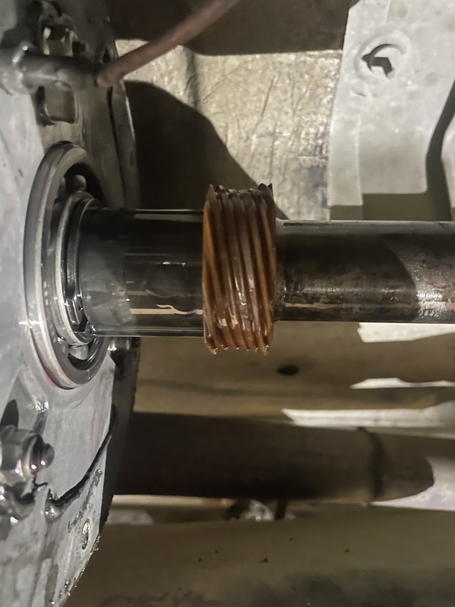

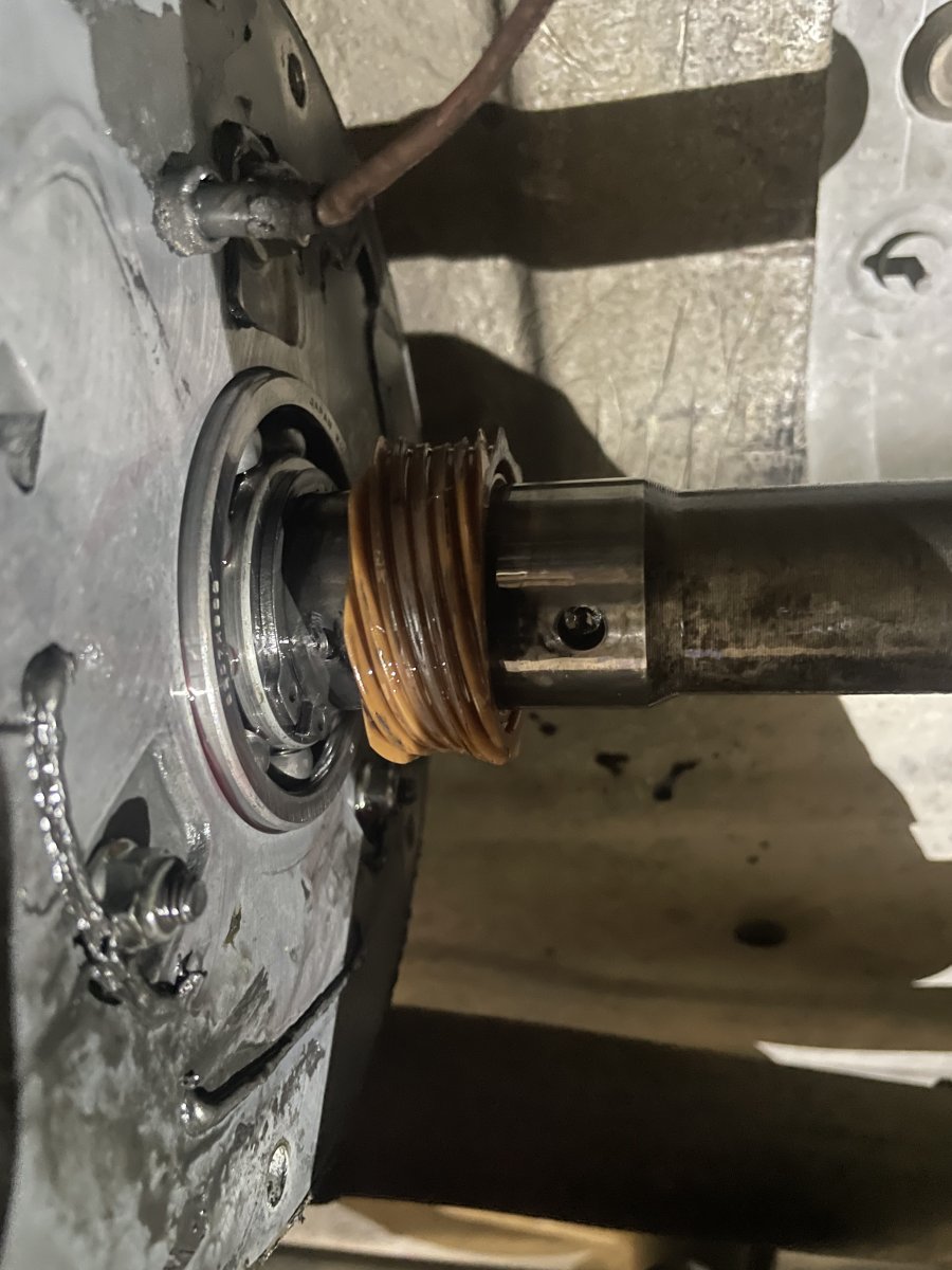

Speedometer was intermittent followed by p0500 code. Checked vss sensor, this truck using 96/97 computer and 96 transfer case with gear driven vss.
Pulled sensor the driven gear is worn. Put finger in t case can feel drive gear is worn.
Lucky for me I actually had a drive gear in stock from many years ago… I ordered two so kept a spare all these years

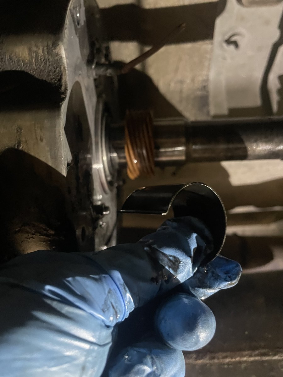

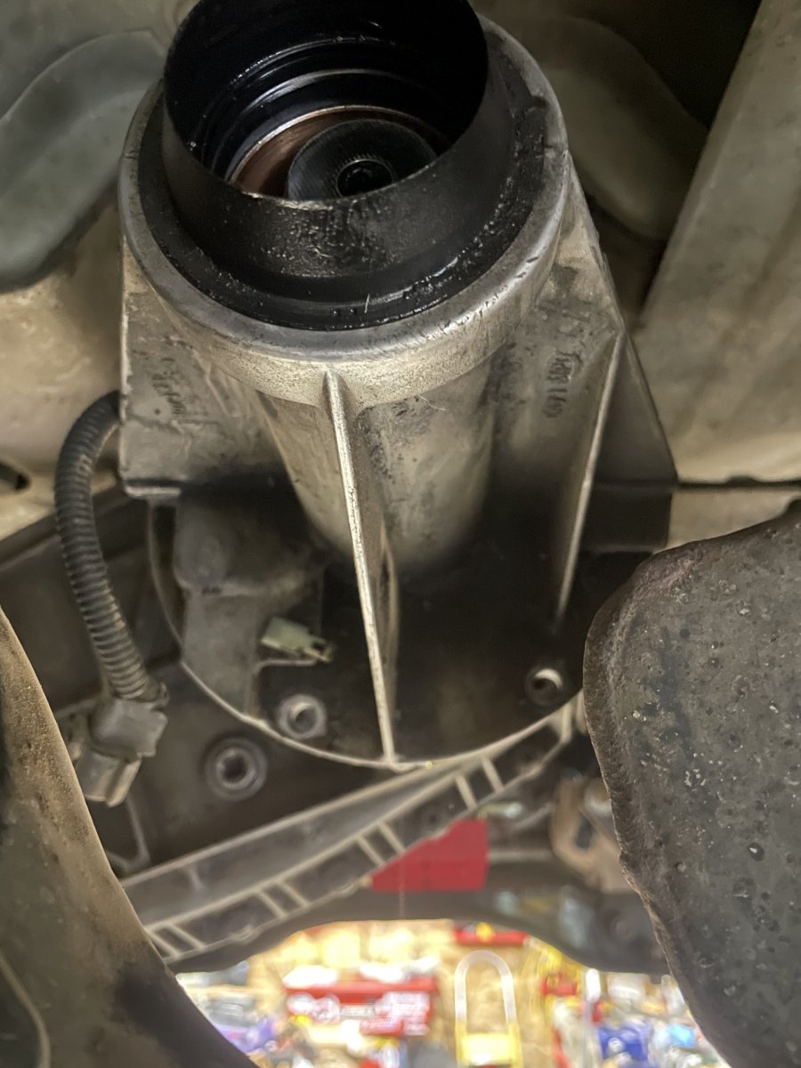

Off came the tailhousing
I cut the brown wire as it will never be used on this truck
Once tail cone is off you remove a metal collar, it snaps over the output shaft. Then the gear presses backwards towards t case and comes off the check ball

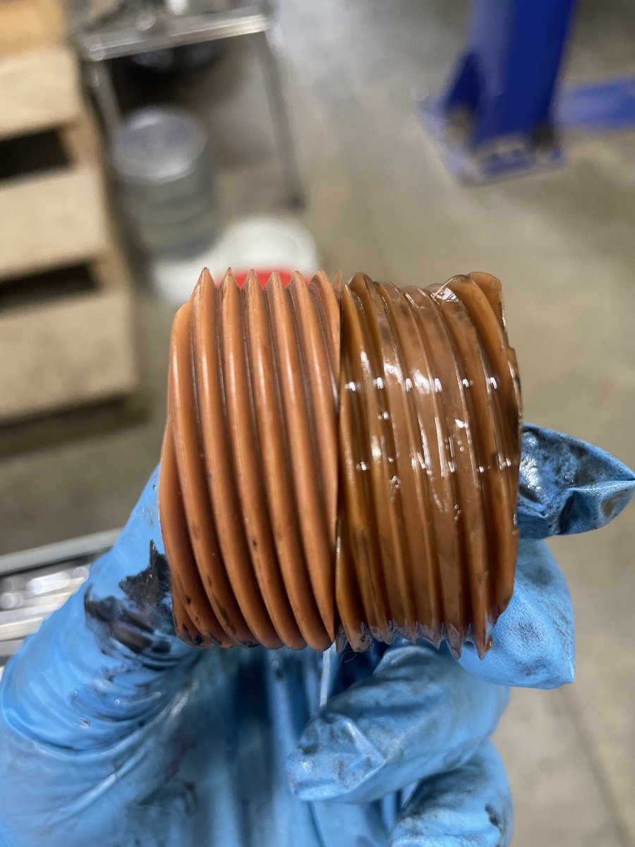

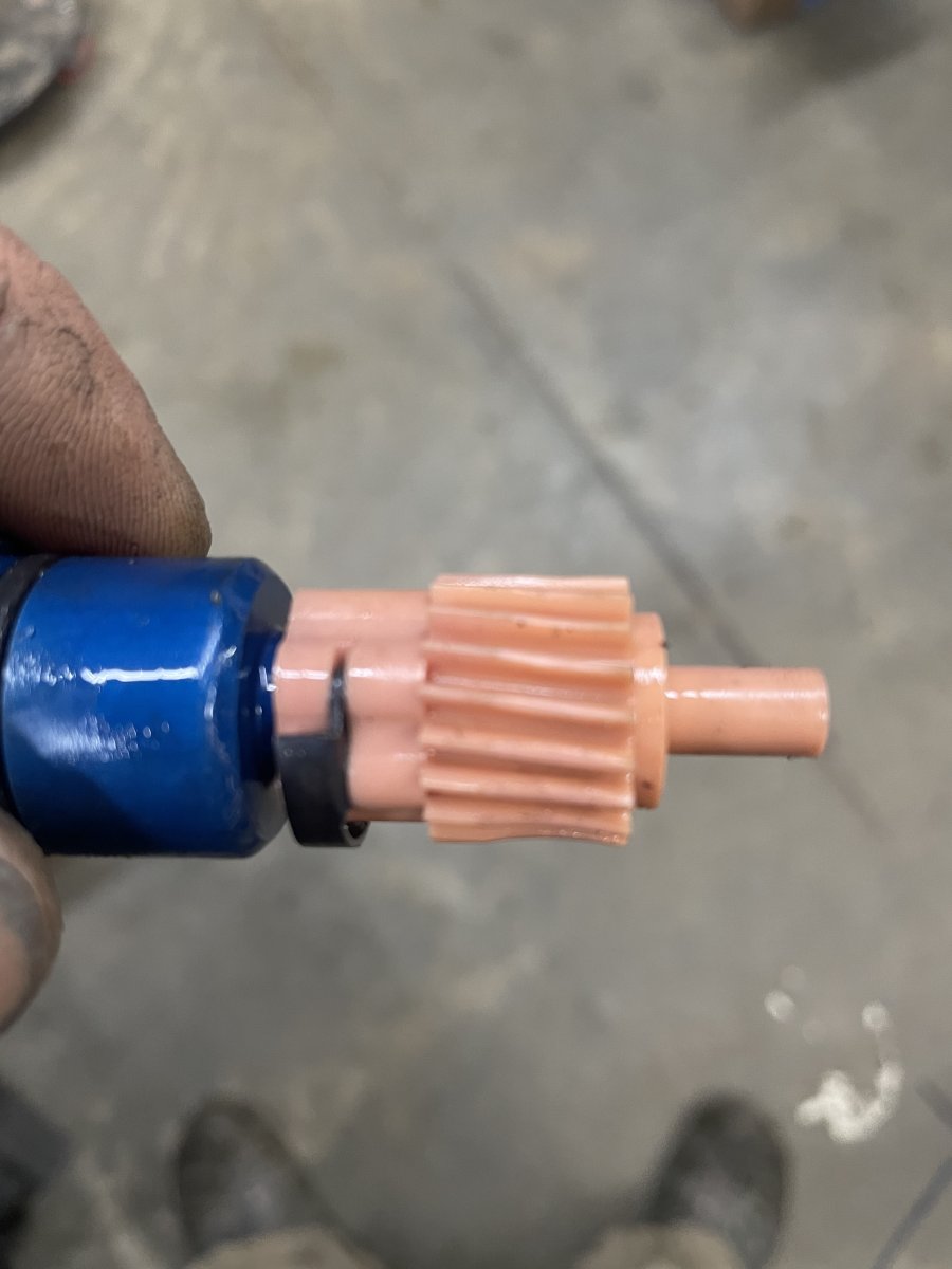

This gear is badly worn which explains the intermittent speedometer
New vs
Old
Parts cleaned and lubed. Tailhousing installed w new permatex ultra grey
I used a 20 tooth driven gear should work well with 4.1 and 265 tires (31.5”)

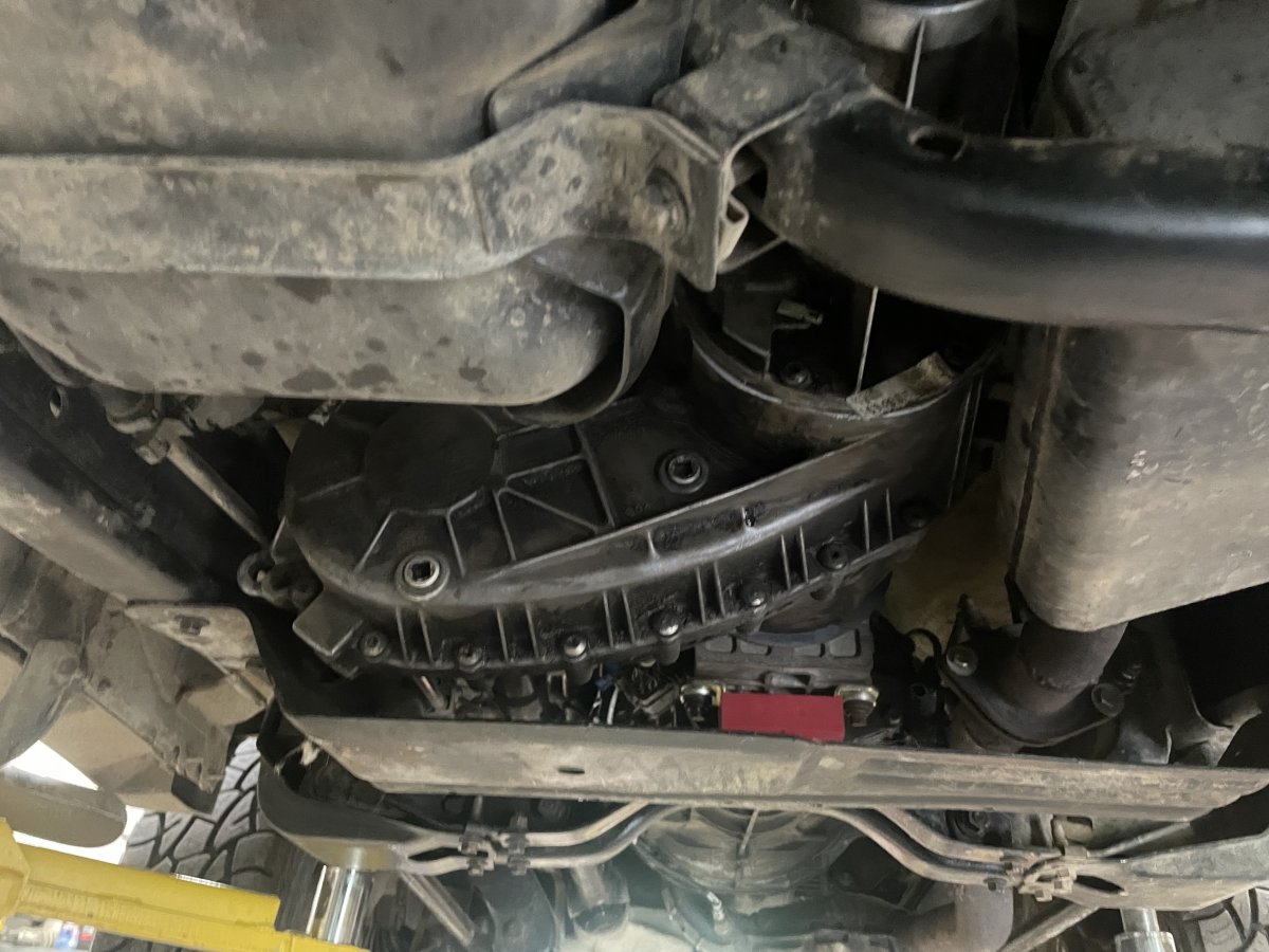

Turns out 03 sport trax skid plate fits over the 4406

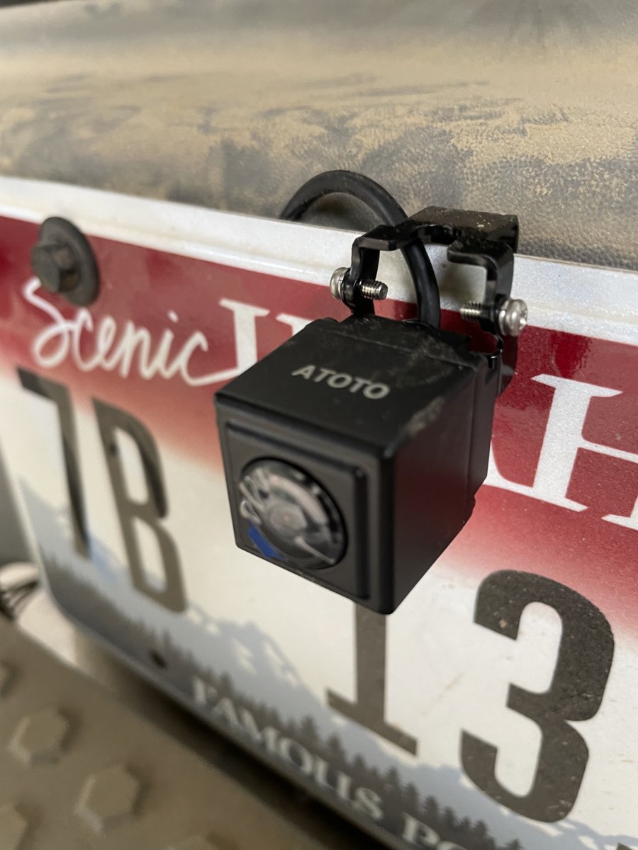

New atoto head unit is installed and rear camera, I’m having issues with the camera I think they sent me a bad one? Not sure I may have to return the whole thing and try again. Bluetooth with apple carplay is very nice. I got it working with the factory subwoofer as well, sounds fantastic!

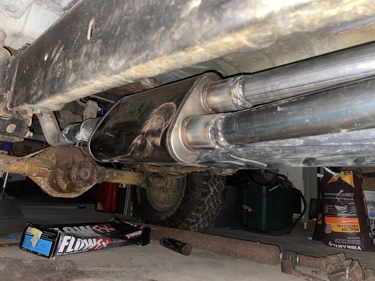

I built a nice exhaust for the 05 as well, dual in single out flowmaster sounds good so far! His 05 is blue and on a superlift, she’s going to be a beast.

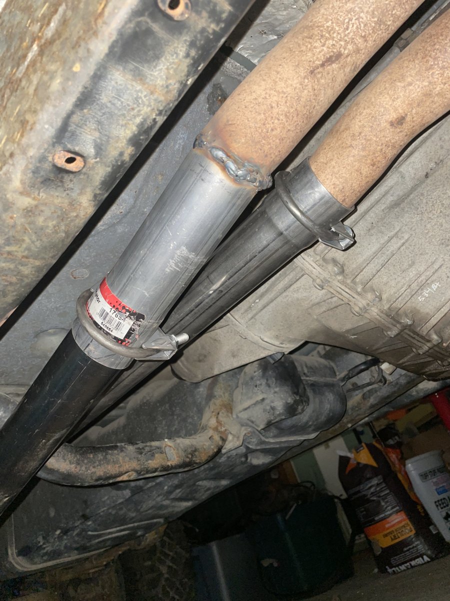

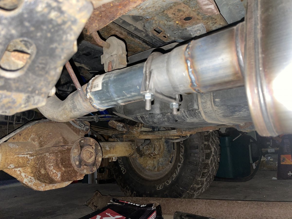

05 exhaust from Downpipes baxk. Dual 2.25” into flowmaster dual in single out. Truck already had a brand new tailpipe so we re used that. It maybe a little small (looks like 2.25”) I would prefer 2.5” but hey he can upgrade down the road
Be kind it was all welded in the truck upside down lol
Sounds great! And mounts w three clamps so can be removed

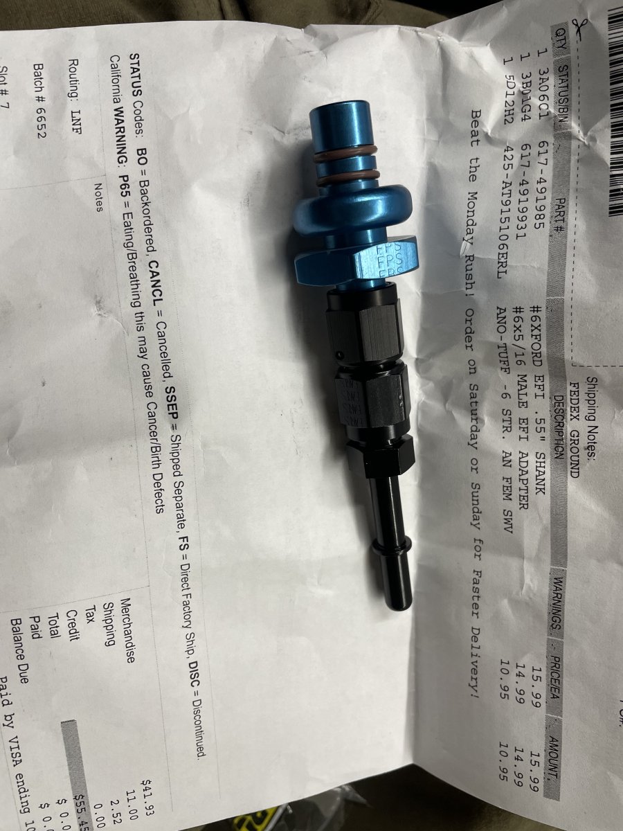

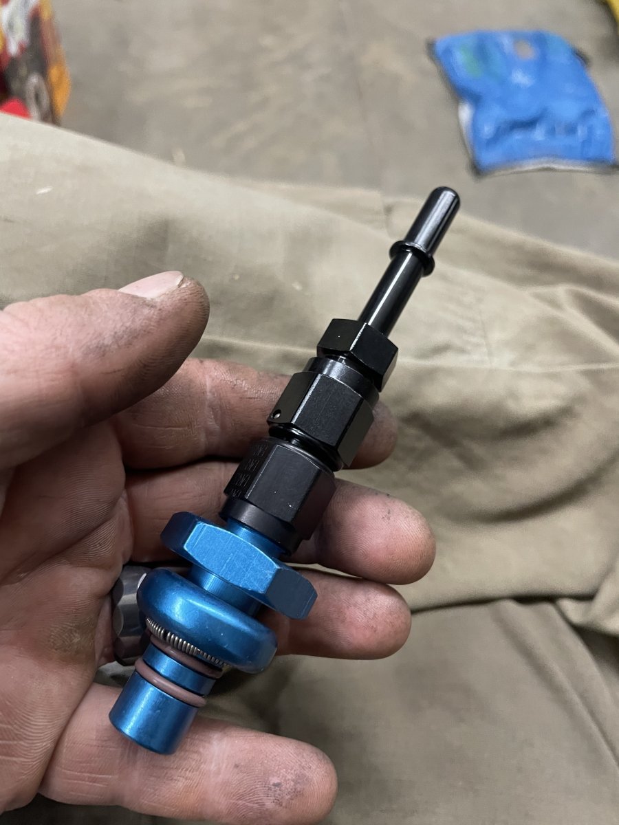

Also built a real fuel line adapter with parts from speedway 5/16” fuel fitting with an6 fittings, cost about $40

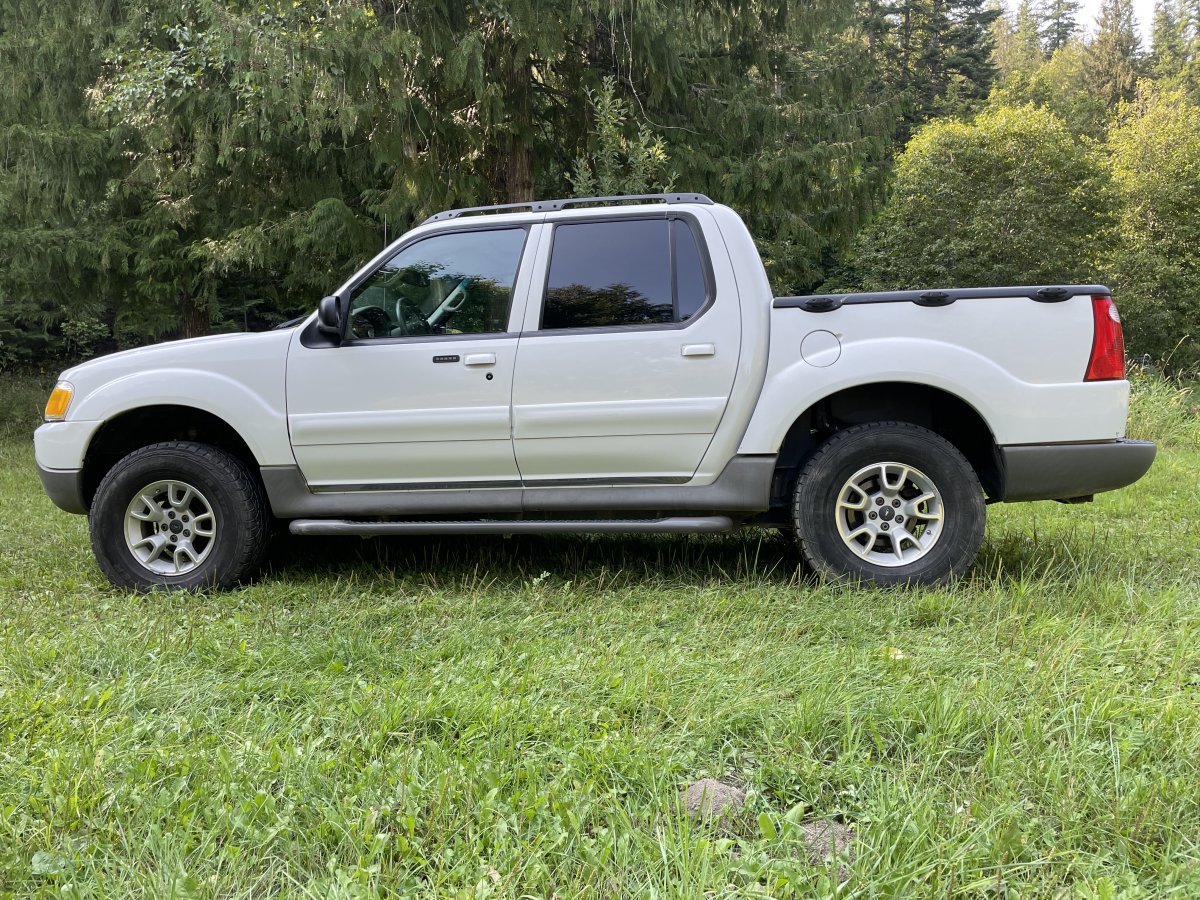

No seriously this white truck it would take a lot of money for me to let it go… like $18-25k otherwise she’s a keeper!
The white one is getting ball joints tie rods and alignment (already did new bearings and it has recent brakes and shocks)

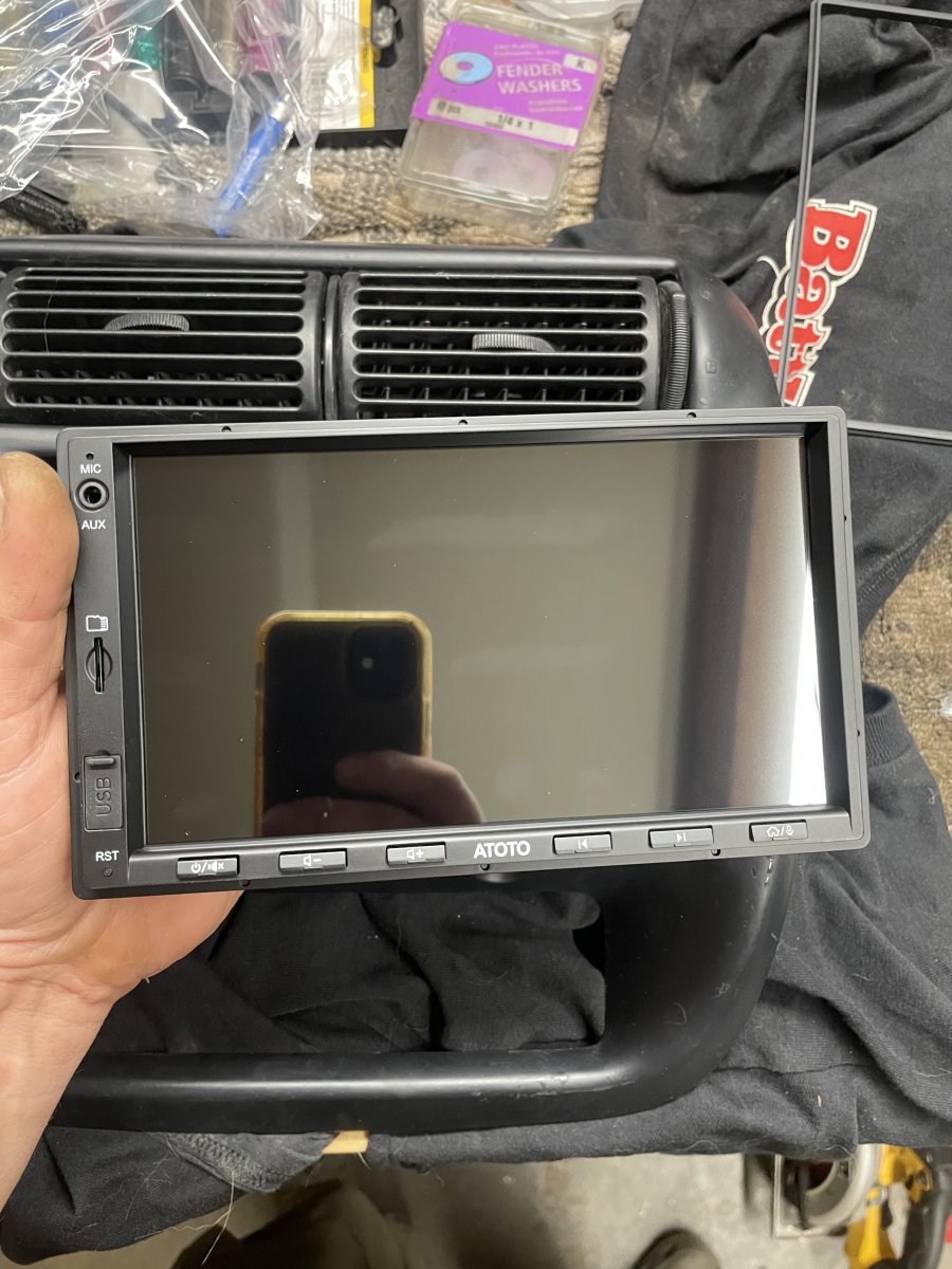

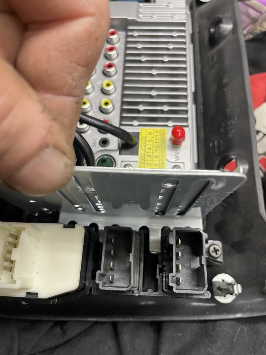

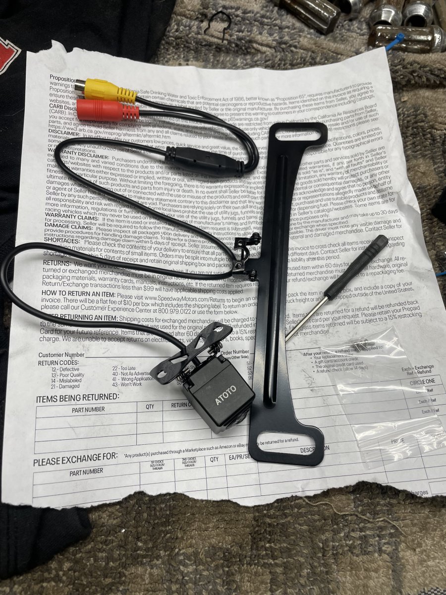

Atoto f7 we $165 on amazon w rear camera

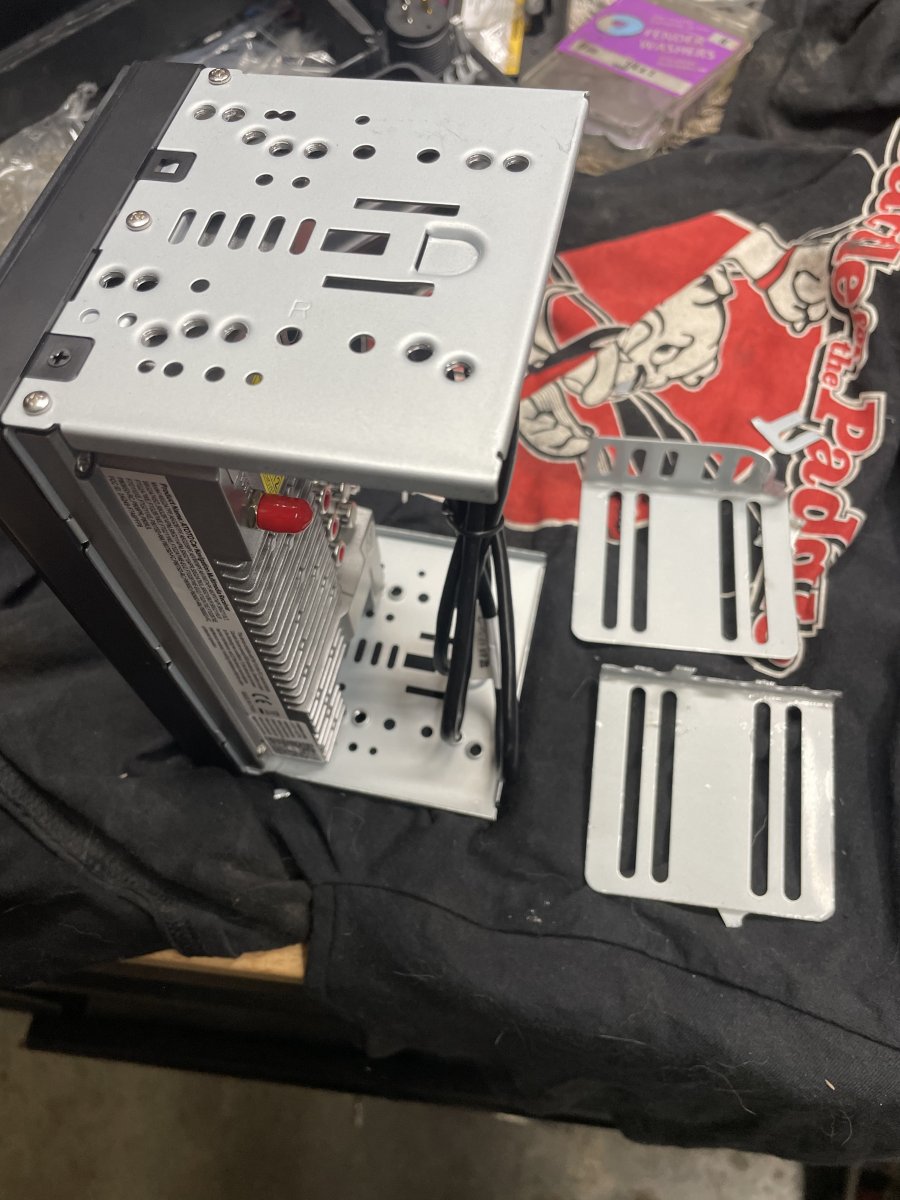

With mounting brackets installed
Brackets modded to clear switches
Perfect fit

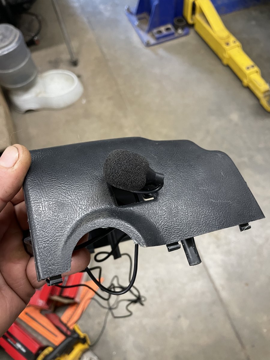

Glued the mic in place to cover the hole in column shroud, worked perfectly
Mounted

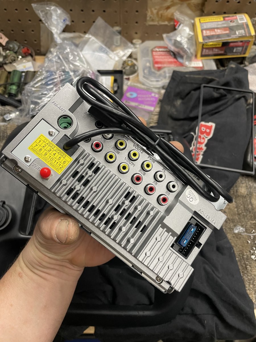

The wiring is a little tricky, good to have the 03 sport trac wiring book (I have 01, 02, 03 and 05 books for traxs now)
Basically to get the factory sub to work there are 3 wires power to sub amp (remote turn on) which is a 5v feed or you will get a “thump” each time you turn the key on. So we use a 12v to 5v resistor inline. Also the atoto subwoofer rca out is full range so I used a low pass inline filter to block out all mid and high ranges, keep bass to 100hz. Have to cut an rca cable apart to get the + and - feeds. All in all it worked out easily without having to buy an install kit or wiring harness (I never do)
This is the 12v to 5v step down used for the remote wire to factory subwoofer amp
RED WOLF Car 12 Volt to 5 Volt Step Down Adapter Harness Fit Aftermarket Radio Stereo Install for Early Ford Mustang Lincoln https://a.co/d/hqj1r1P
