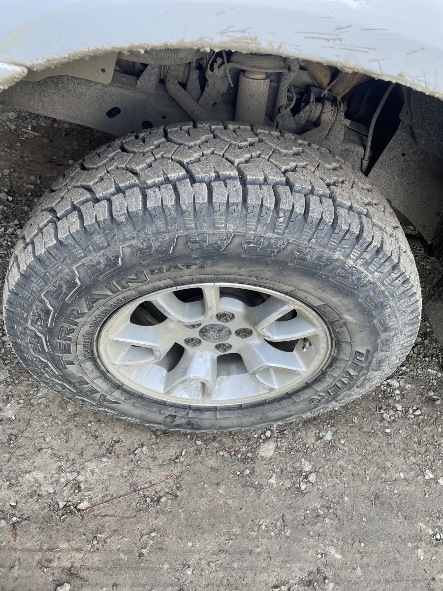

I replaced all 4 tires
All 4 tie rod ends
And front whee bearings with new precision parts from oreillys
Also she’s getting new motorcraft plug wires and some new $25 Fog lights, the old ones got water in them over the winter. The new lights will get taken apart and sealed with some permatex before install

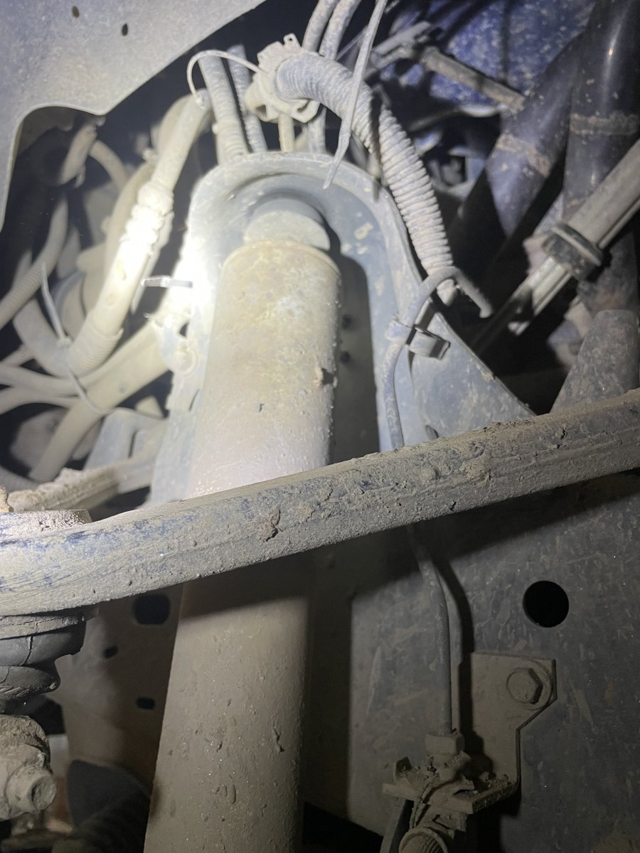

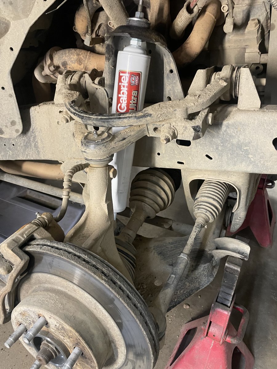

Was making some nasty noises up front
I found the shocks were toast, the bottom bushings wallowed out. I also found (with the help of my stepson) that the upper control arms were coming loose… that was most of the noise. The alignment dudes probably didn’t lock them down enough ( for our road)
So I re torqued them.. 112 ft lbs is the spec, ours were nowhere near this
But before I did that I replaced the front shocks with Gabriel ultras from rock auto. I also unloaded both torsion bars and replaced the isolator pads. Both sides were worn pretty badly with the Kevlar pad cracking.
And I lifted the front end quite a bit. Basically I bottomed out the drivers t bar bolt and matched the number of turns on the passenger side, then checked the truck for level. The front was raised about 1.25”

I hate the way that new shocks for these rigs are too short. My suspension drops out at least 1” past where the new shocks bottom out… I know the shock is acting as the limiting strap, explains the bushing wear. Next time I’m gonna run shocks for a 1-2” lifted rig. Let’s see how long these Gabriel’s last (fyi my wife’s drives fast)
I need to get the bronco and FJ back on the road alleviate some of the strain put on this 03 ;)
I hate thumps bumps and clunks.
On a side note, those are the exact shocks I've been eyeing to replace mine. Did you get the ones that are exact fit for the truck or ones that are an inch longer?
Exact fit I should have gotten the 1” longer

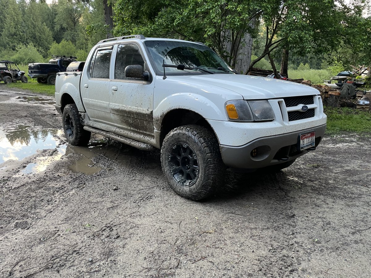

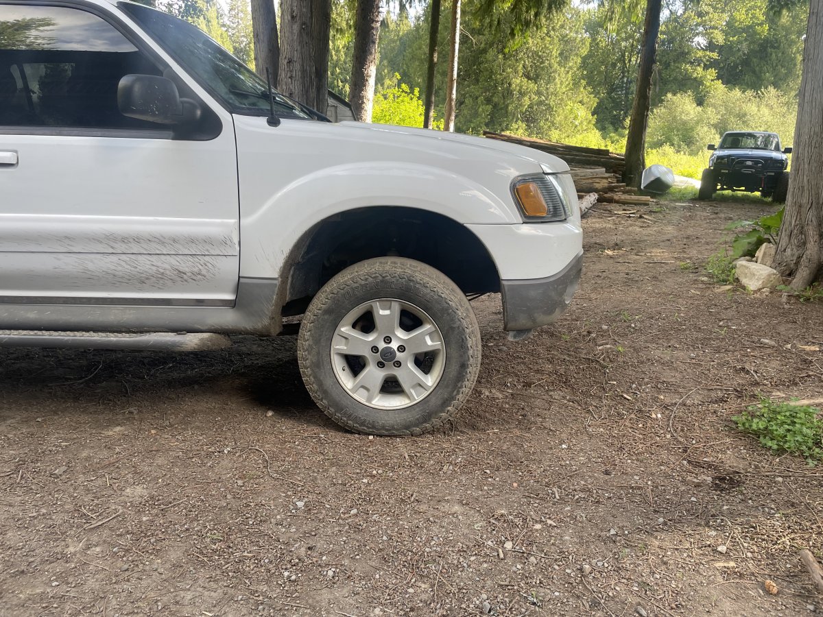

Can see her new found stance
Urethane body mounts
2” body lift
1.25” torsion twist, finally looking proper
265 17 or a 31.5 will go perfect
Working our way up to 285s!
With the v8, manual trans and 4.1 gears our highway rpm pretty high, larger tires will help. This thing is mostly commuter, she may get 3.73s

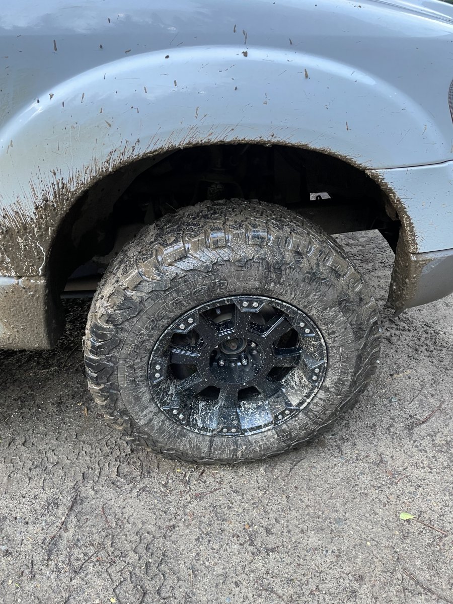

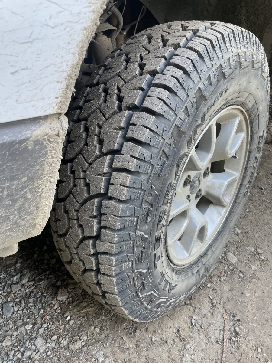

Here she is with her 17” wheels and 265 70 bfg ko2s
I scored the tires used for $500 and will sell the gmc wheels center caps for $250-300. The wheels I got in a trade. So at the end of the day I have $250 in these tires, they are 10
Ply and at least 75% tread. I’m running them at 24 psi right now because they are 10 ply, will do chalk line test to determine best pressures. We have a coats rim clamp tire machine and recently picked up a coats 1001 spin balancer. Life is good!
