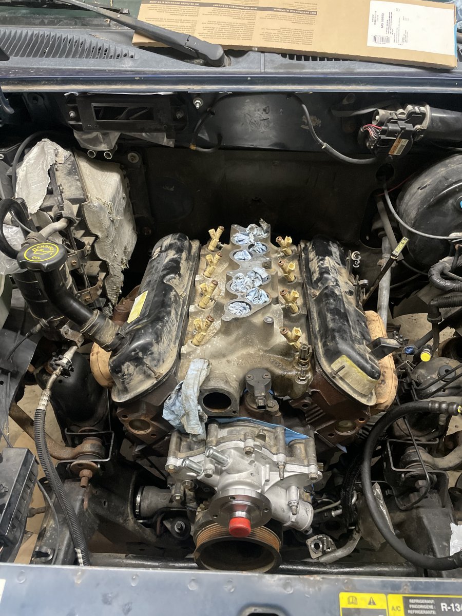

I have a really rare opportunity here I have a set of obx/maximizer on this engine and I have a set it tmh brand new in the box in the shop so I’m planning to get some side by side comparison pics

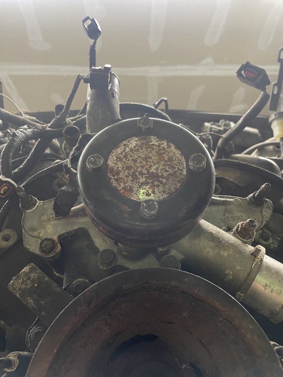

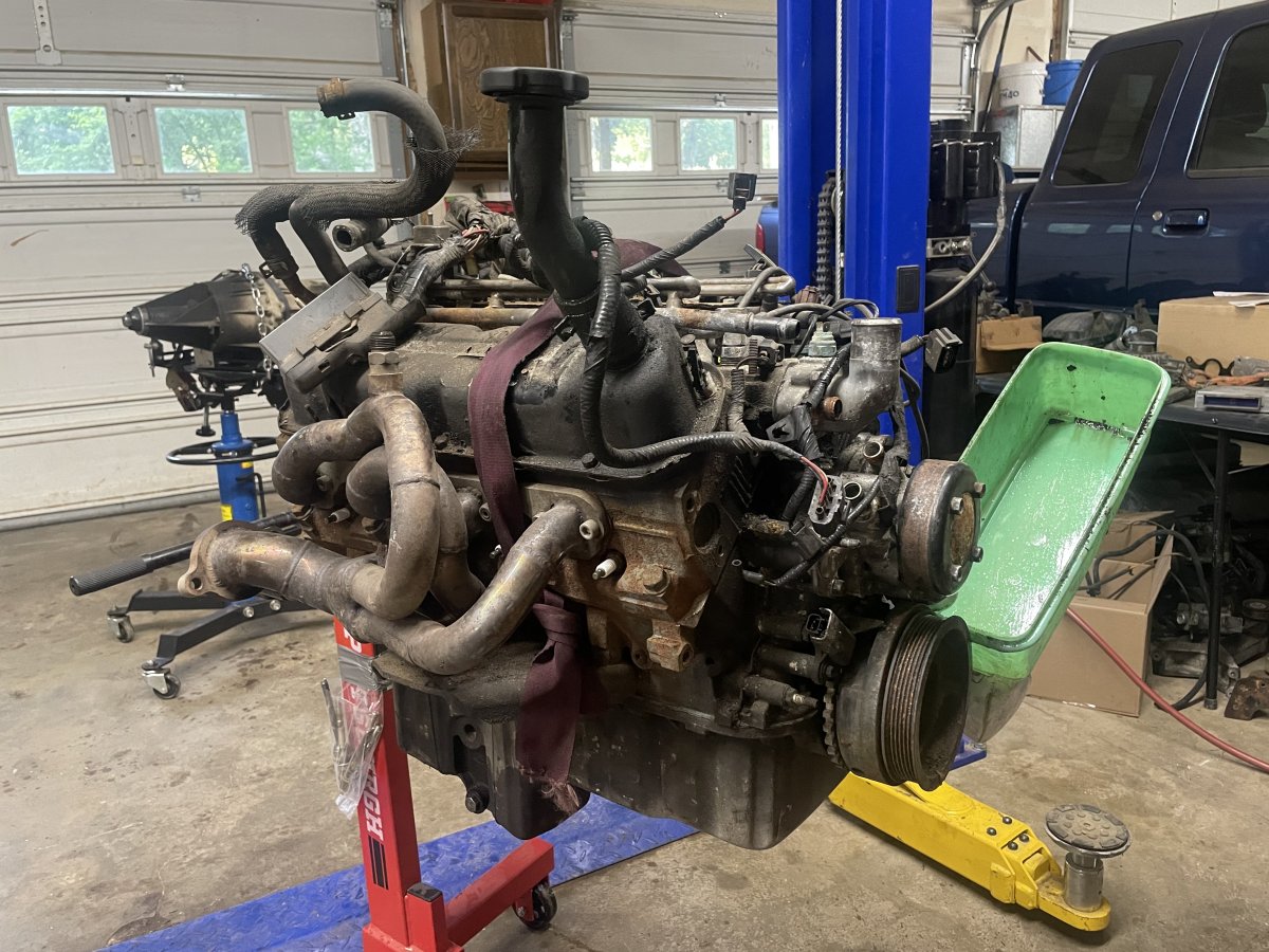

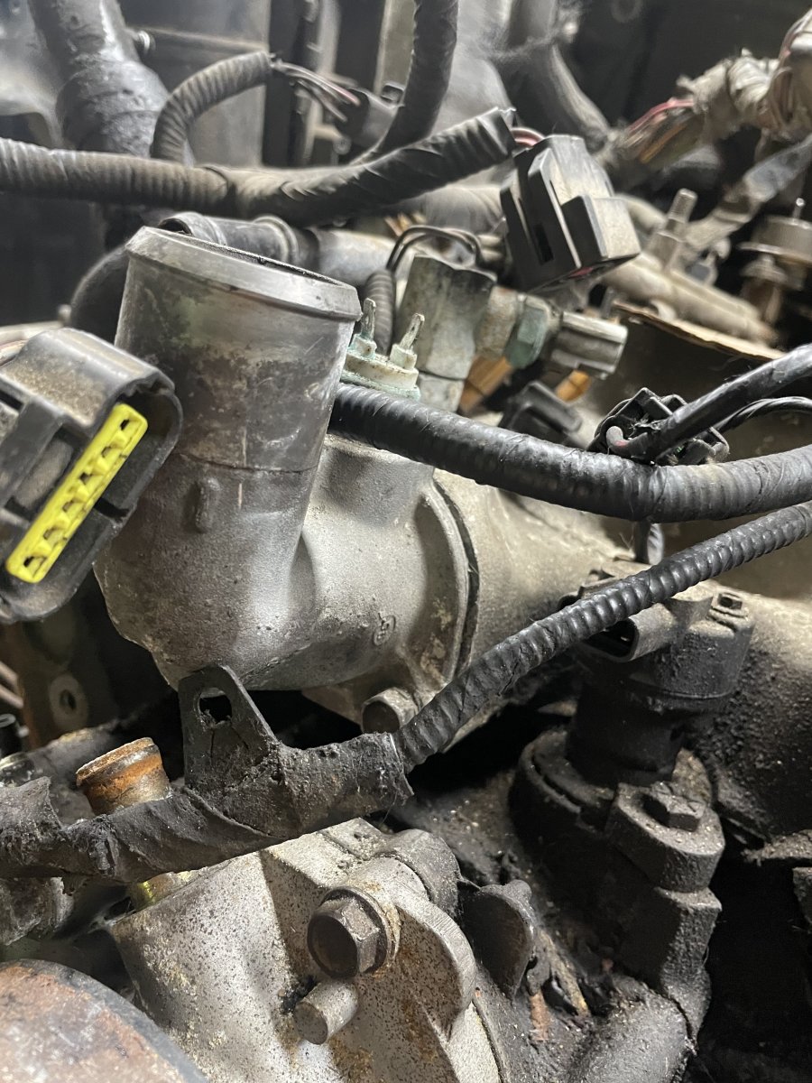

Water pump w no snout, was running e fans
Thermo housing tapped for fan controller sensor
And it’s out

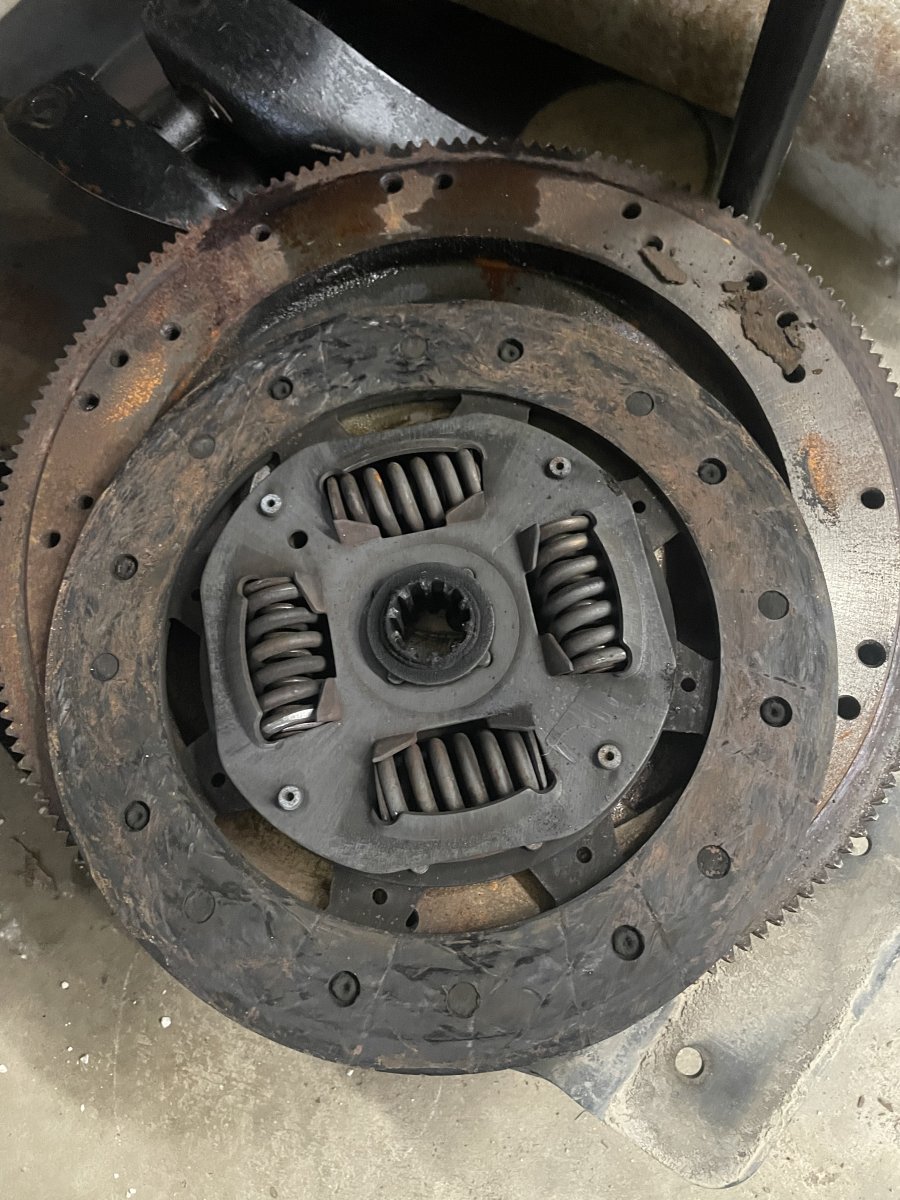

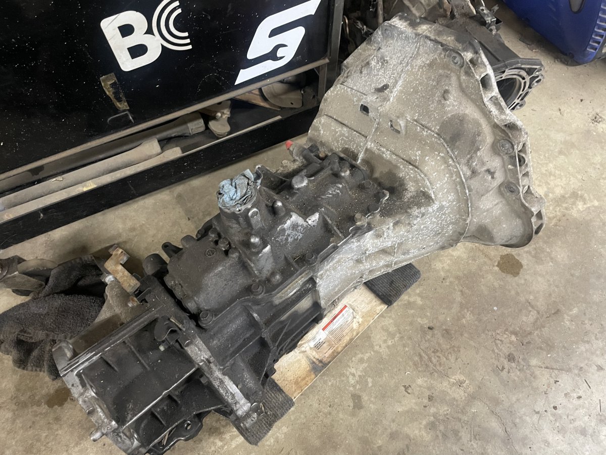

Clutch is fried
4406 leaky
5 speed leaky
302 leaky
Ordering gasket kit waterpump and clutch

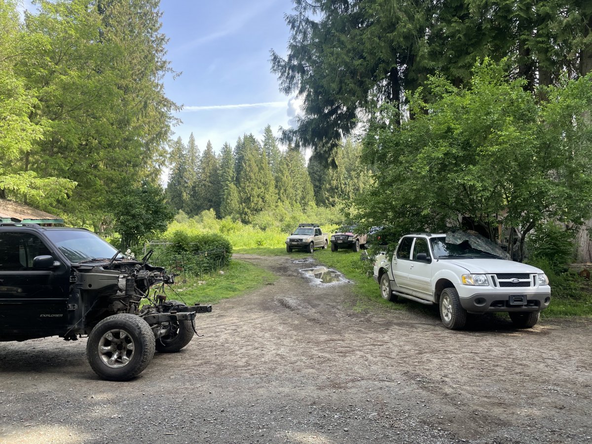

Black trac is outside

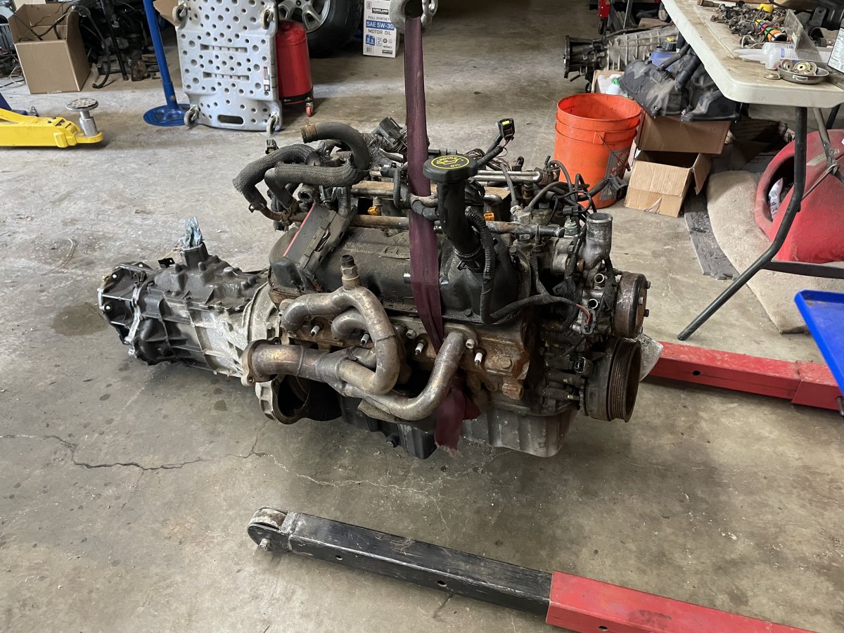

Brought in the 01 w the 05 sohc after some serious wiring changes (lots of research just a few Minutes of actual wiring) I have a starter and a fuel pump. Fuel pump sounds weak and gas is from 2018…. But truck fired w ether!
So I disabled the stupid drl by pulling a fuse and now I’m about to do a fuel pump and filter
Once I get this truck sorted I can get back to building the 03 v8
soooo I have the 01 trac with the 05 engine in the shop

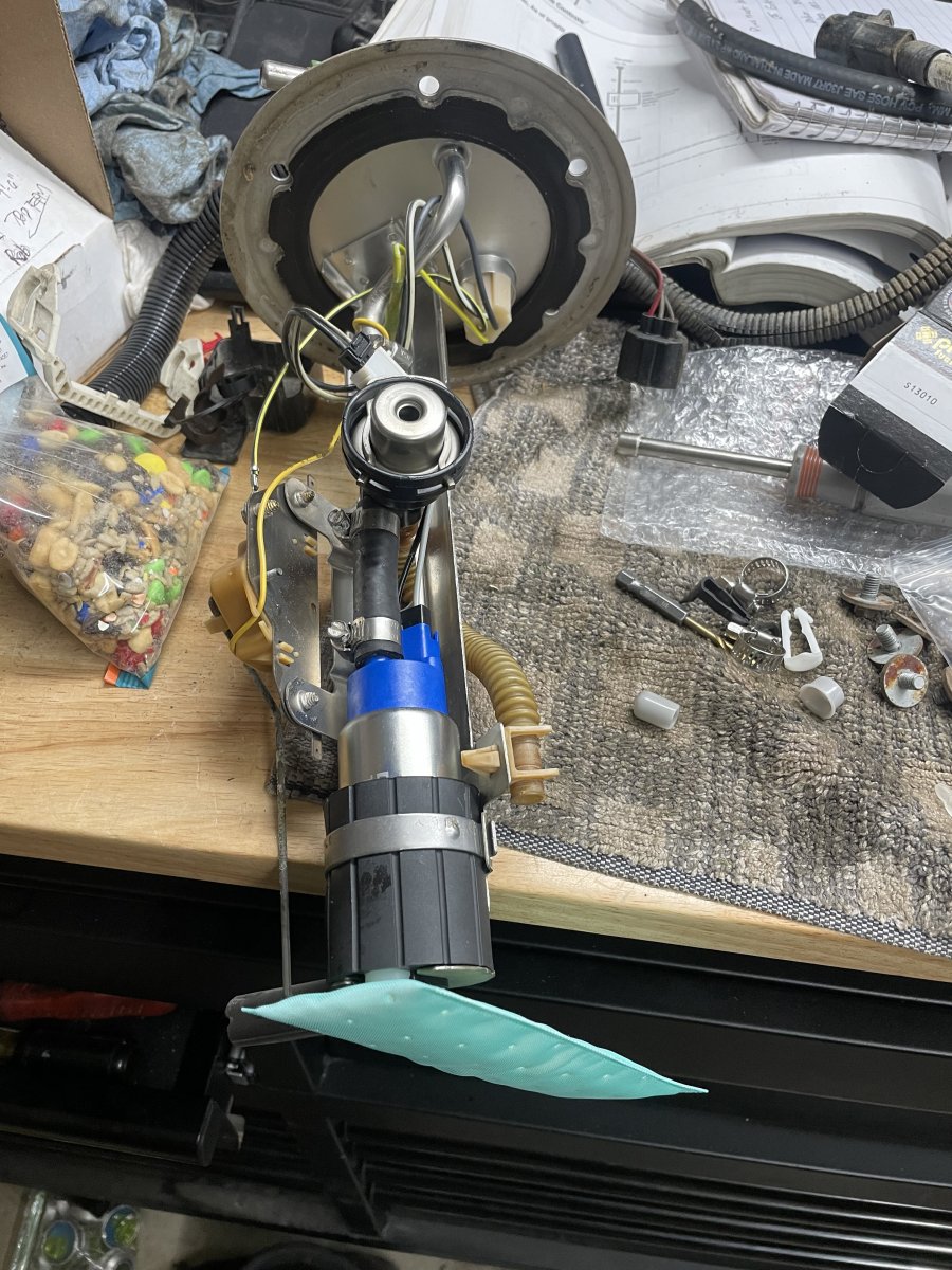

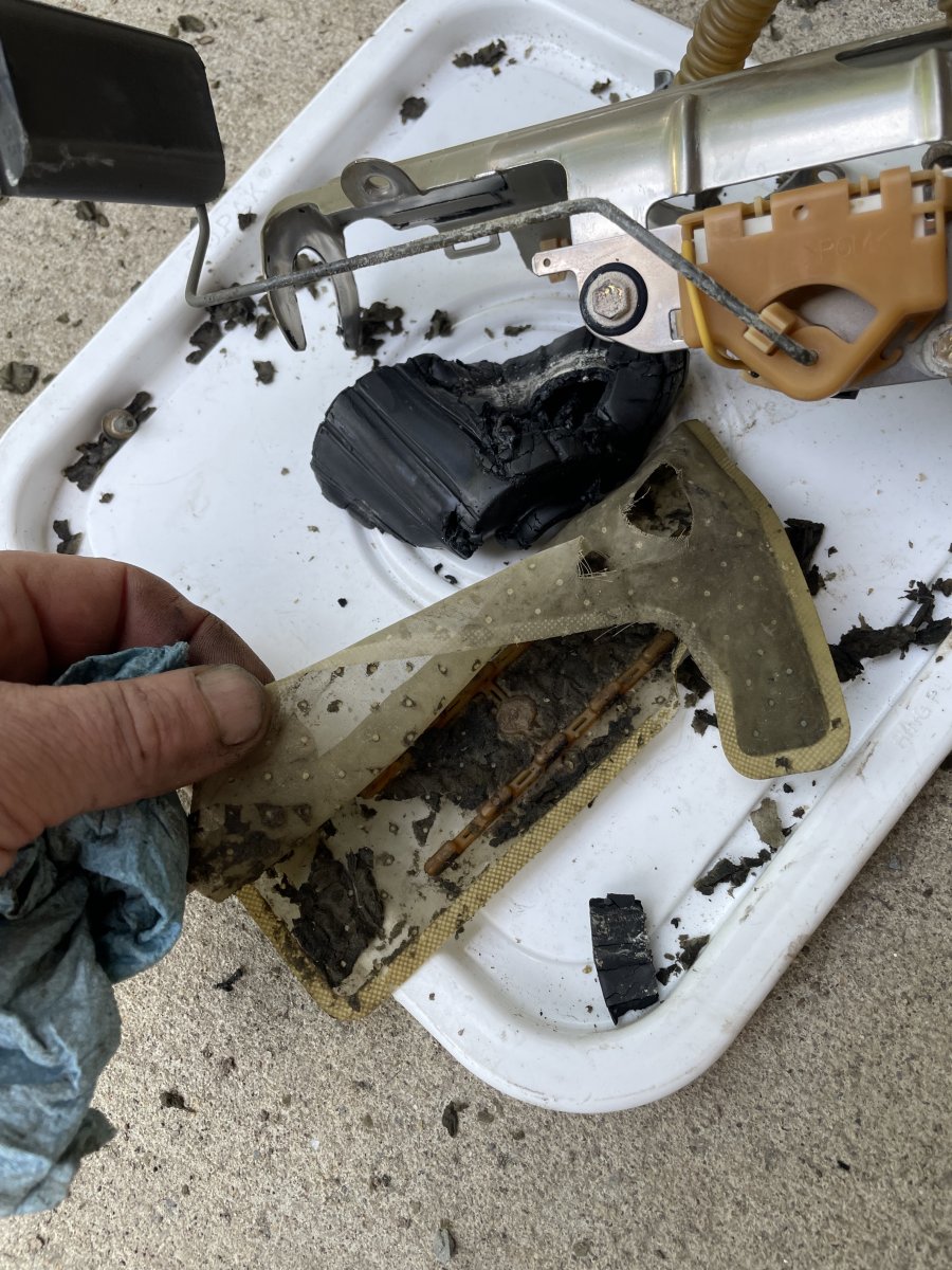

I dropped the tank
Truck been sitting since 2018
Fuel tank varnish (old fuel) is a real thing
Completely destroyed the in tank pump, mount, strainer and rubber lines
Nasty!
I am glad the pump never ran because it could have pushed some of this crap into the lines/new filter/ fuel rail.
The 01 also has a metal tank
I will be cleaning the tank
Adding new pump strainer and rubber lines
Then fresh fuel
Fingers crossed

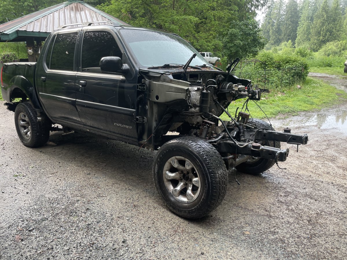

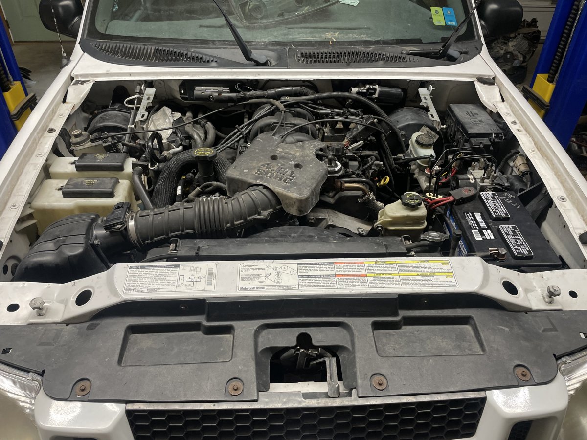

Back to sport tracs! Yesterday was a good day. Started off with me at the junk yard at 7am (40 mile drive) I pulled keys pcm and pats module from a 98 sport sohc. Ran home, installed parts, truck was running by 9am. This is the 01 trac with 05 sohc and 07 trans…. The one with the varnished fuel tank.
Two days ago i installed new Delphi fuel pump and strainer with new hoses. Made in USA, $104 in town.
Third Delphi pump I’ve done this
Month, things happen in 3s w these trucks?
Bosch pumps Mia, so I have been using these
Truck fired instantly!! However no oil pressure gauge hahaha turns out I had to move oil pressure wire from pin 6 to pin 8 on the c139 connector. Again this is early production trac vs late production trac wiring changes
Engine is from 05 gen iii, wiring and accessories from 03, truck is 01

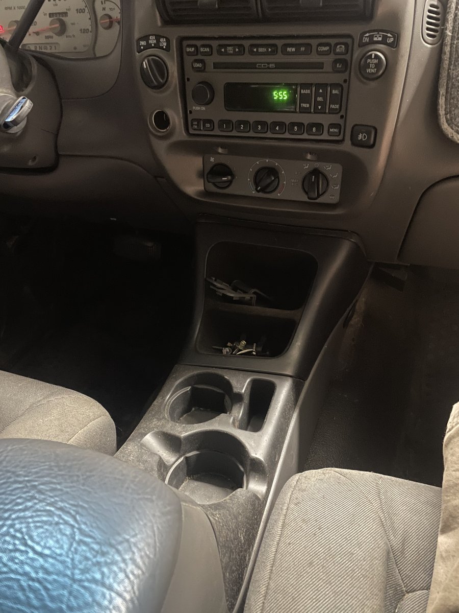

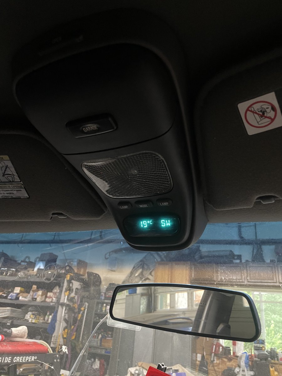

Spent the day getting it 100%. Replaced overhead console w one that works. Removed the “bag” center console and installed gen ii graphite full console. The oem bag console is missing the bag and the armrest does not fold. Previous owner repair. I kept bag console and tweed floor Matts for my own collection. This truck is sold as soon as it’s done (friend)

Overhead console and center console in

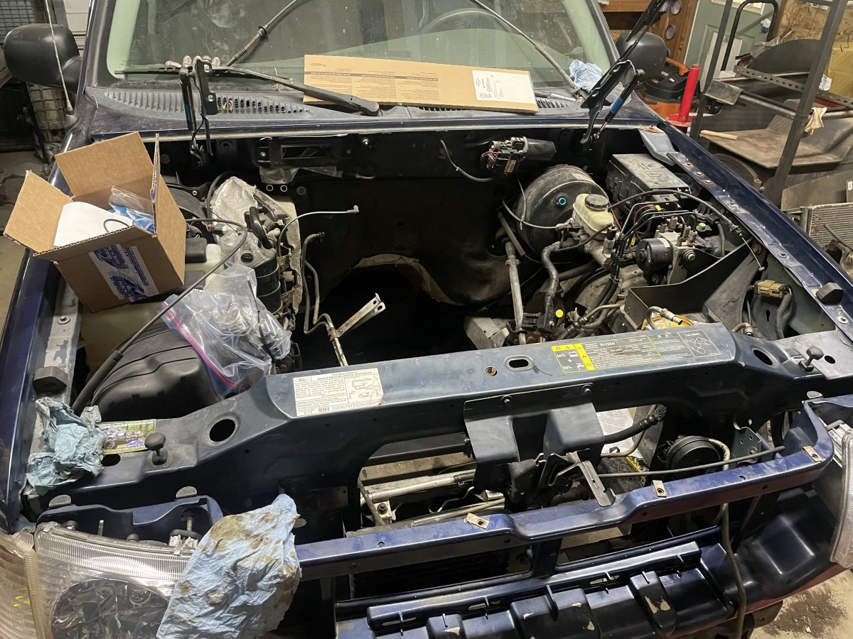

Next I helped my stepson install the v8 into his wife’s new 05 sport trac and we sorted out how to handle the superlift bracket install

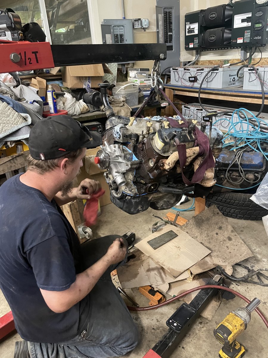

Here he is buttoning up his low mile 302’ready to drop in. You can see the 400 engine in background under the blue air hose. Also almost pictured is my 306 engine with 18000 miles on it and comp cam xr cam and valve-train (on stand under plastic).
His blue 05’ready for the 302
He changed out drivers motor mount in favor of a v8 mount and the. We dropped her in

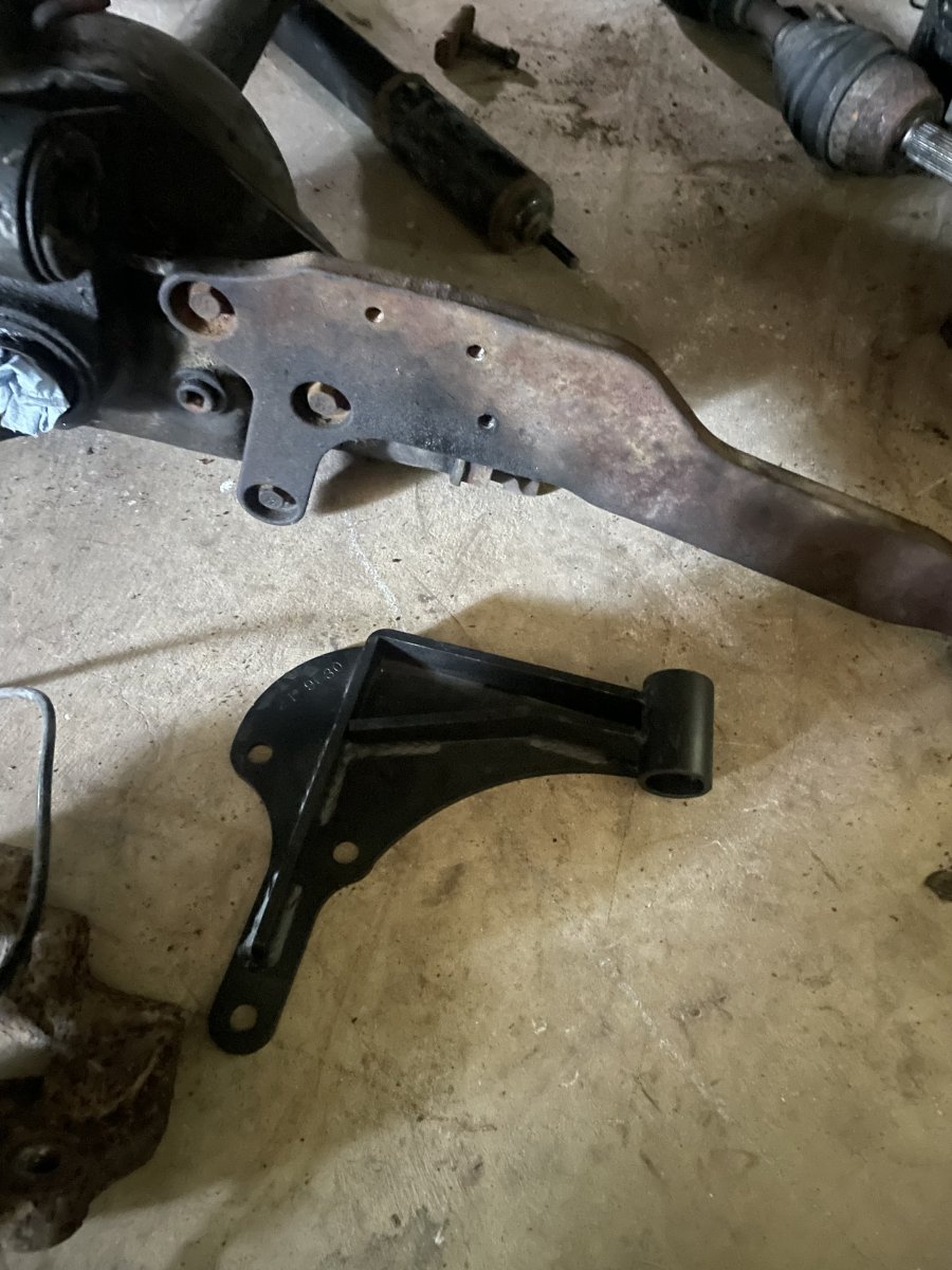

Now the superlift

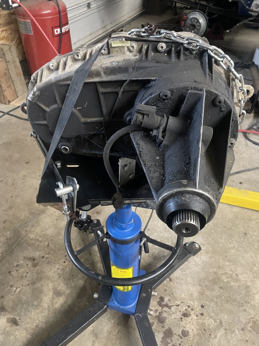

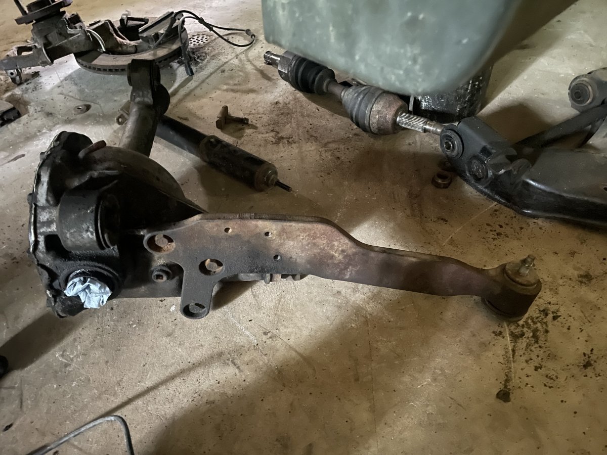

Here is the funky late sport trac front diff with long arm bracket

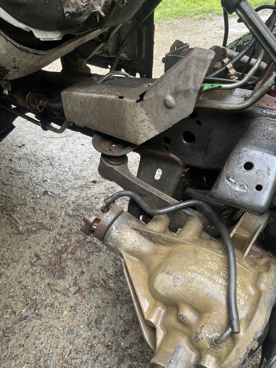

03+ sport trac Long arm pictured next to superlift bracket
Wth ford? Sheesh
Lucky for us my 01 black trac that’s going to crusher has the old style diff mount. We will simply cut this tab off frame and weld it in proper spot on 05 frame allowing the superlift bracket to bolt in
