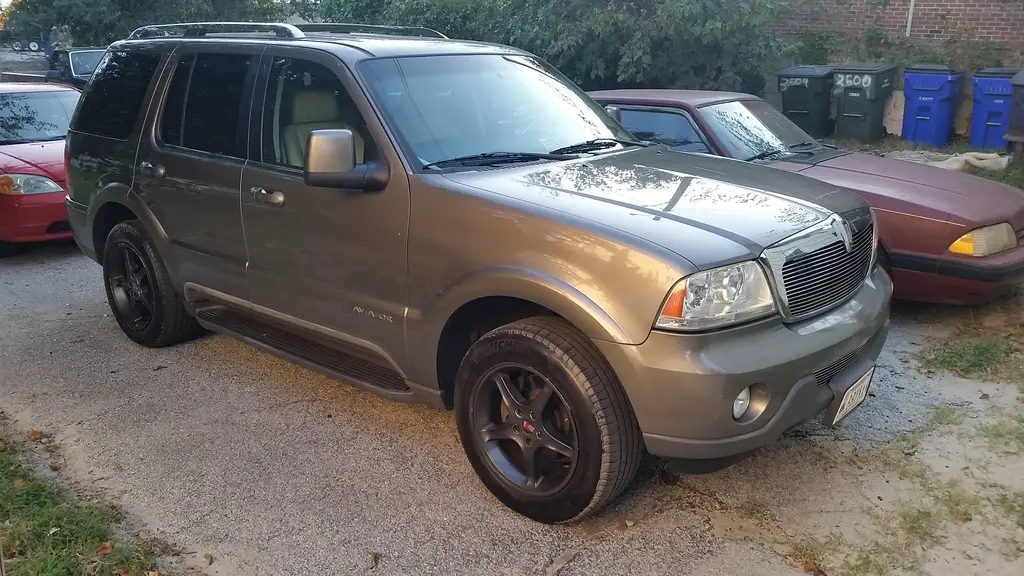

Sure loooks good back in my driveway though. .the wheels are growing on me but still needs a drop,they look too small with all that gap!! :)
