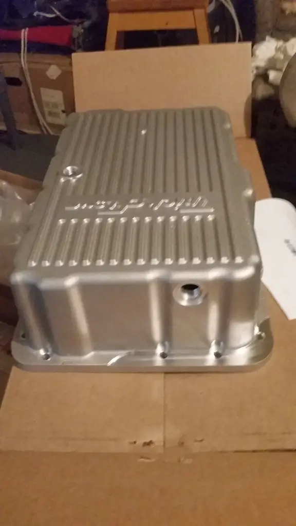

Got my deep pan with dipstick and valve body yesterday , the solenoids will be in on Monday . .
Pan is a nice unit for sure,was gonna throw some paint on it but might not now..maybe some blue pinstripes . .
Clear coat it and be done, it's pretty as is.
What's that hole on the side for in pic #2? Is that for the trans cooler line?
