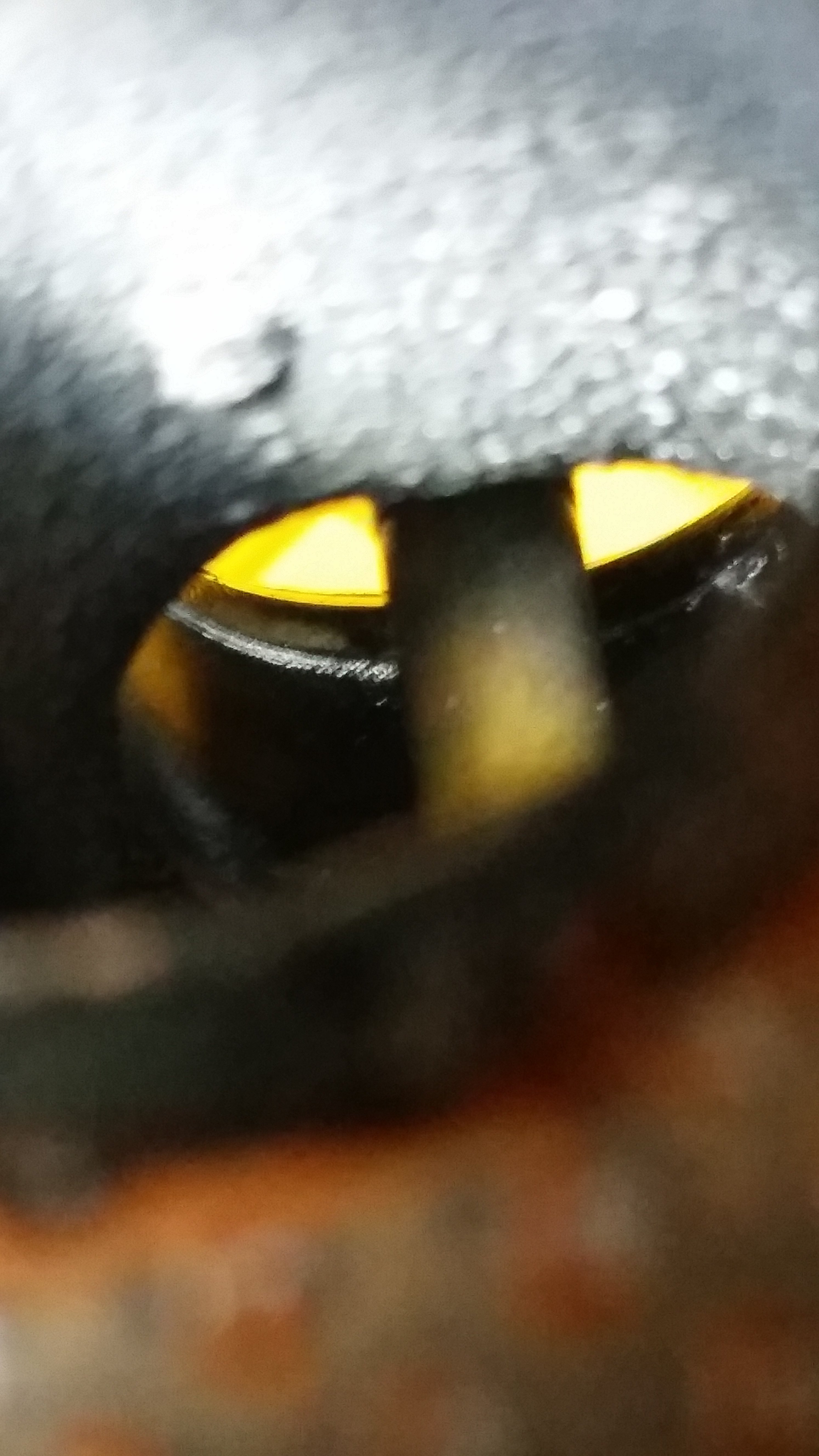

Soo think i may have found it..these heads i had the old shop put hardened seats in the exhaust. .
Well looks like one has been moving around..there is a line and ridge where the seat is pressed into the head..all the rest are nice and smooth from the ""port"" work,also evenly covered with carbon. .
Bad pictures but can see the shiny line/ring and has a lip like its been moving around..

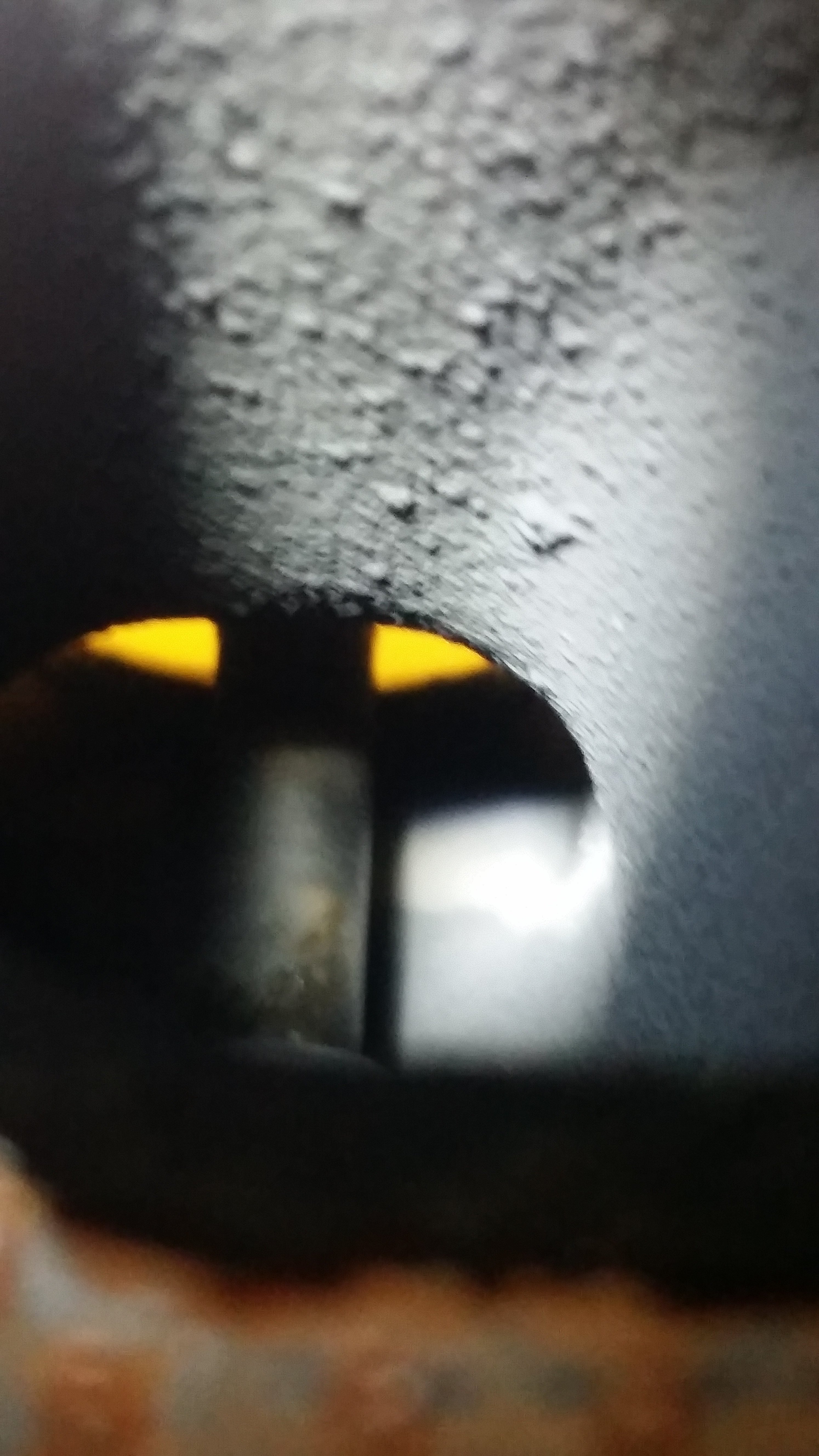

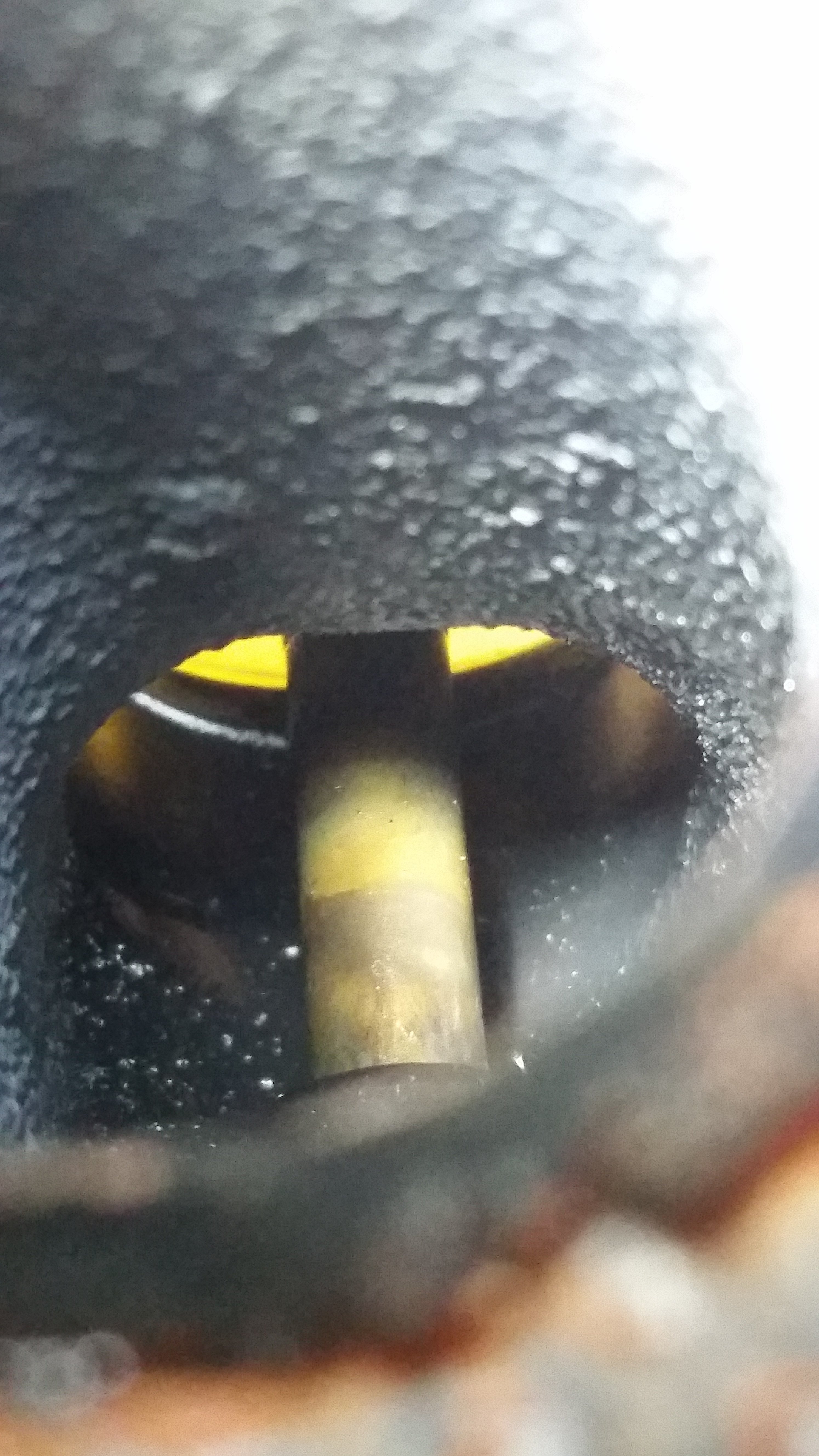

Here is another crappy picture with no ring,smooth carbon and transition. .same cylinder 2nd exhaust valve..

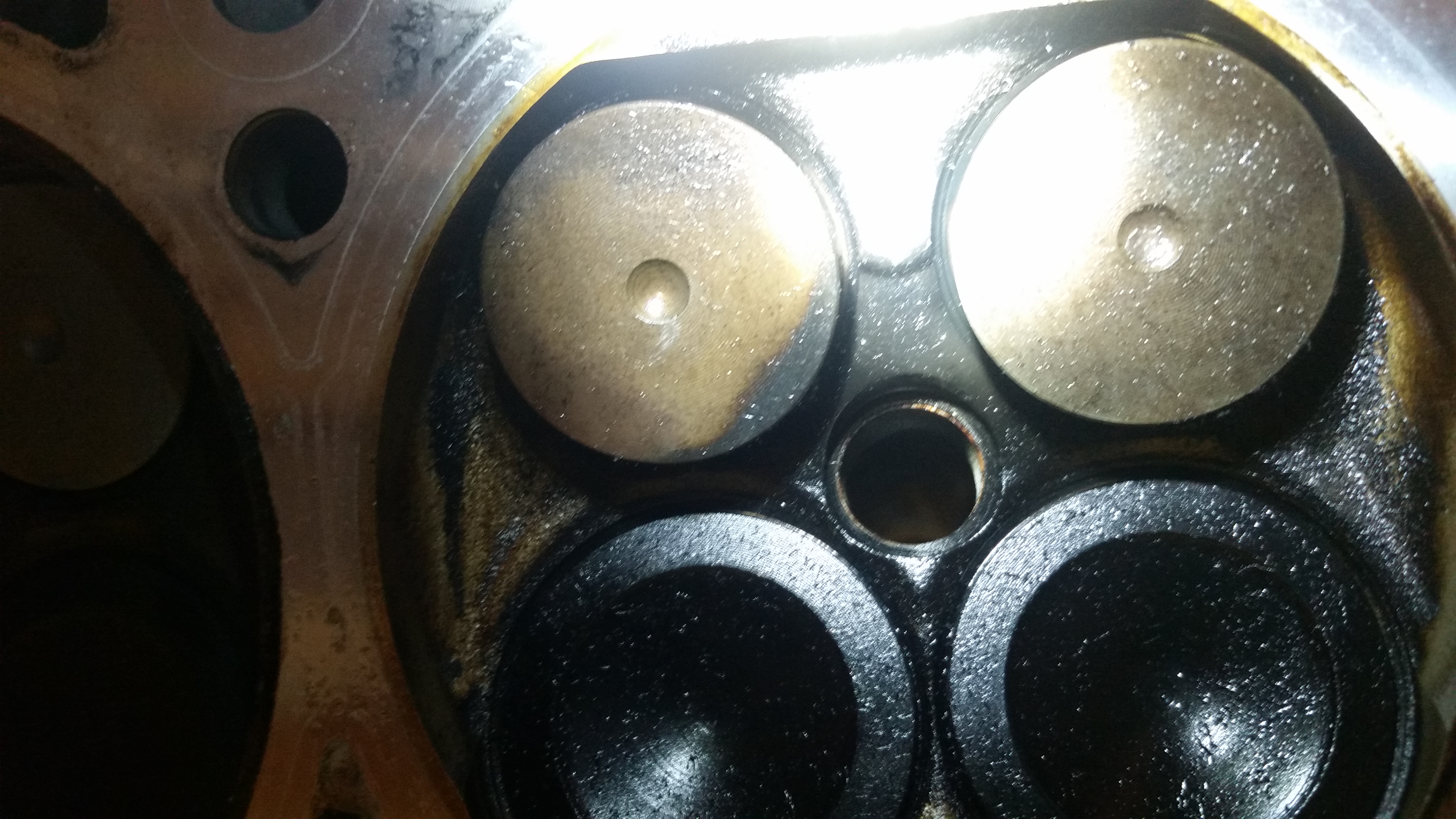

More crappy pics..but you can see where the valve has been hitting the seat at a angle where its been moving,it also correlates to the burnt carbon spot on the valve face..
Problem is the old shop did these seats and i dont trust them anymore. .so the new shops going to have to replace all these valve exhaust seats with slightly larger ones and the do a valve job on all them..it aint gonna be cheap and thats if they even will do business with me after the fiasco last time..they ended up giving $400 back for mesaing the cams up and took $100 off originally for taking so long..
