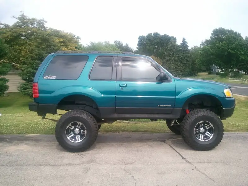

Here's my truck as of last week
Would i have to grind my calipers down to fit a 15, What backspacing should i get to fit 33's without rubbing, or triming
No you don't have to grind your calipers they just fit. Get some 15x8 rims with a 3.75" or 4" back spacing. Those will stick out enough to look good but they won't stick out to much.

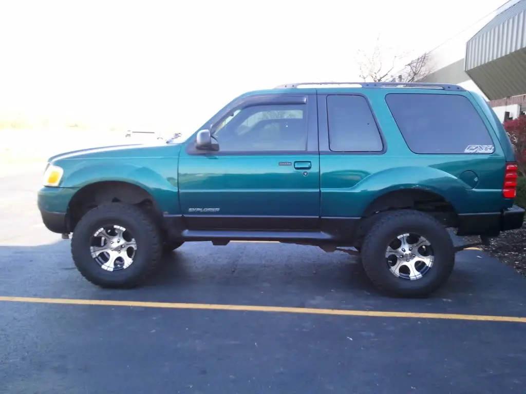

This is my explorer with 4" of lift and 32's with 15x8 dick cepek rims. They had a 3 5/8" back spacing.
