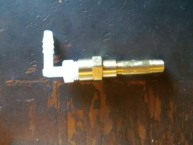

Fluid fill adaptor. (mine was homemade & cost $5+- at Lowes)

Adaptor : 1/8" x 1/8" a 1-1/2" MIP nipple to 1/8" x 1/4" MIP coupling to 1/4" MIP x 1/4" Barbed elbow
I am going to change it to a straight brass barbed adaptor.

7/8" socket for drain plug & (?) size torx for fill adapter
