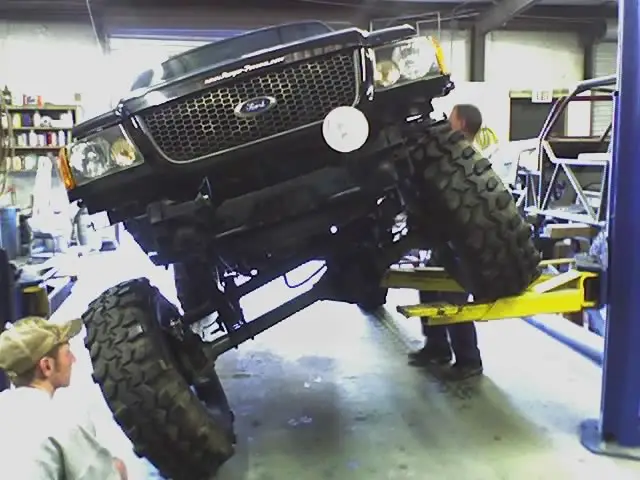

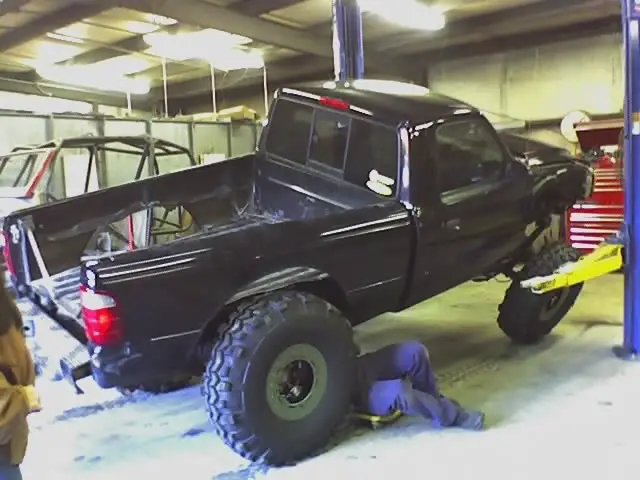

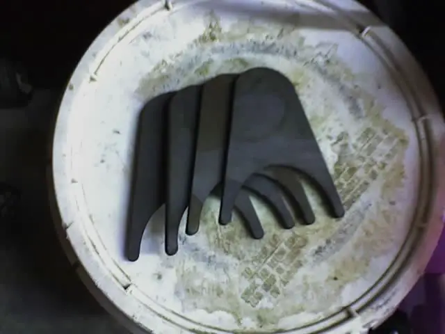

Took it to mild2wild today to flex it out. Nothing too impressive. But got it measured for shocks in the rear. Got some shocks and tabs for the rear also. Still dunno about the front, i'm gonna find a set of f250 towers to see if I can make them fit and then measure it again.
I need to cut the bolt holding the drag link to the pitman arm, it still hits under flex, one of the reasons its not flexing as much as it could.

that thing can flex ohh my god that thing is bad azz

Is that right before a tire comes off jey??

oo also did you test flex by liftin one of the rear tires as well? you probably wont see full droop at the fron unless you do...
034x4
- January 16, 2005
- 438
- B'ham
- 2003 Ranger Edge
supergildo said:oo also did you test flex by liftin one of the rear tires as well? you probably wont see full droop at the fron unless you do...
ya i did, but didn't take any pics.
I gotta get my f250 shock towers and figure out how/where exactly i'm mounting them, before i go back and flex it again, and measure/order/install whatever the front shocks.
edit: Ya thats almost right before a tire came off the ground. If it has weight in the back i'm sure it'll flex more than that.

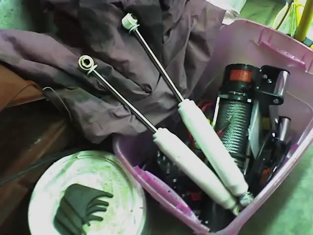

Got my winch carrier today. It's not a bumper, so everyone freaking out about me "buying" a bumper can let out a sigh of relief.
Tomorrow i'll be making the mounts and installing the carrier and the winch itself. and welding the tabs and mounting the rear shocks. I gotta find me some f250 shock towers and get them mounted, then go re-measure for the front shocks.
