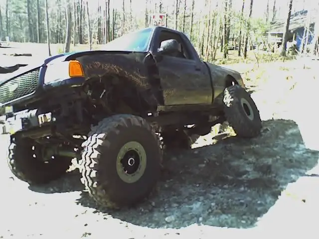

Drove into all the pics with my 2wd lol.
I need some bumpstops...drag link hits the frame at full compression and so does the bolt on the tie-rod for the assist ram which I still need to cut above the nut and cut some excess of the inner-forward u-bolt it hits the hydro bolt too. I'll be doing all of that this weekend when I install my spacers.
