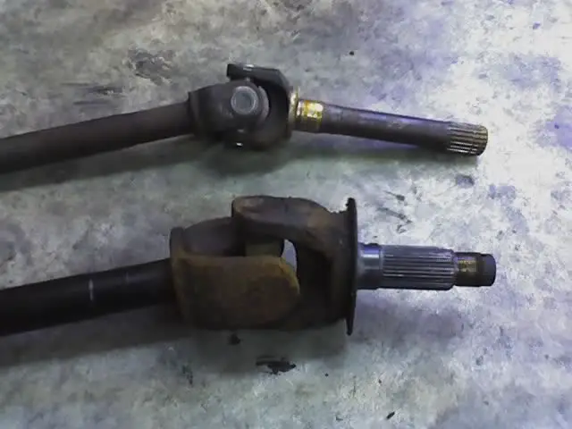

Stock 44 w/760 spicer on top. Stock "new" shafts and joint on bottom.
Ahahaha, the stock rear shafts are bigger than 14 bolt shafts.
It's not a 70. That probably makes it non Dana unless you got something that I don't know about.
