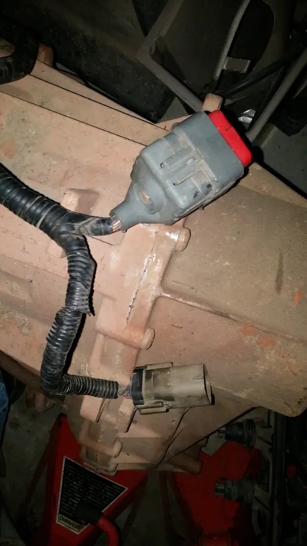

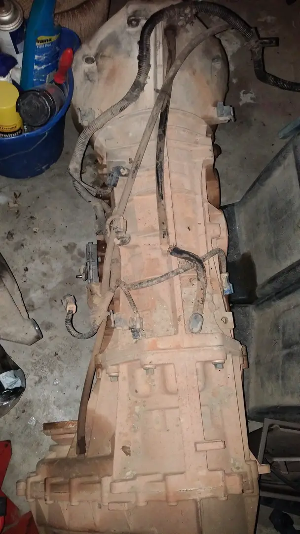

Remove front and rear driveshafts, disconnect shifter cable from lever on the side of the trans, unplug oxygen sensors, Disconnect electrical plug from transfer case, unplug all the sensors on the trans,( I have one out with the harness still attached if you'd like a pic to show all the sensors locations) On the top, passenger side of the transmission, there will be a bolt for the fuel line bracket. Up top, (and you can do this step before you put the truck in the air) The top two bell housing bolts are easier to get at with a wrench, as well as another fuel line bracket on the passenger top bell housing bolt. The other 4 should be fairly easy from the bottom, a swivel adapter may help.
