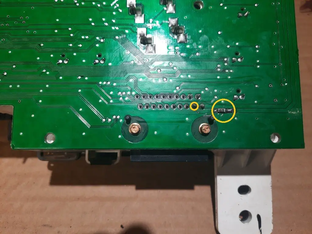

This may sound stupid but I want to defeat the audible beep coming from the cluster. I have intermittent charging system fault message going off extremely frequently. Does someone have a diagram for the cluster connector to help me figure out which one is the tone?

The cluster is now a self-contained microprocessor, a computer, if you will), which does not have individually wired inputs anymore. It is controlled digitally through the CAN bus by the PCM. Nearly all the lights in the cluster are LEDs and not replaceble either. I can post Ford's Shop Wiring Diagram of the cluster if you like. It is disappointing. Their aim apparently was to make impossible defeat of any of the features, such as ABS, CEL, etc. lights, as well as perhaps the beeper. imp

You need the cluster schematic
It is a speaker on the board and if you snip it it can’t make noise anymore
Just like if you pulled off a stepper motor the tach or speedo would not have something to drive the needle
There is a cluster shop in Flint that can customize anything cluster and they likely know what to do
Someone is sure to have the detail
These were designed and made by Visteon post spinoff but the base board layout was complete likely in the late 90s
