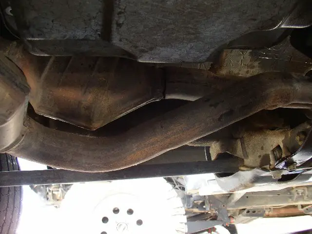

...I climbed under the truck to find one rear mudflap gone, 1 chewed up, and the exhaust gone from behind the last cat...

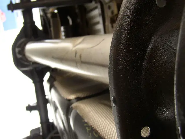

...I next noticed the drive shaft had a good dent..

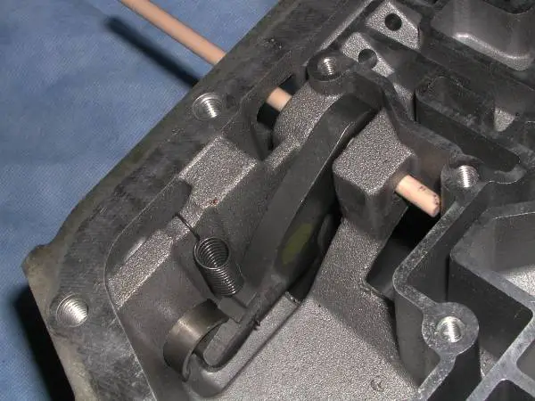

...Which led me to this which brought me to posting here...The tail housing is missing a chunk...
Is it right to think that this section can easily be replaced???
Besides dropping the pan, is there anything else I should look into or be aware of???
How much is a tail housing for a 5r55e???
I am not familiar with the long single drive shaft but I wouldn't think it's really damaged but I think the hit to it is what broke the tail housing..
