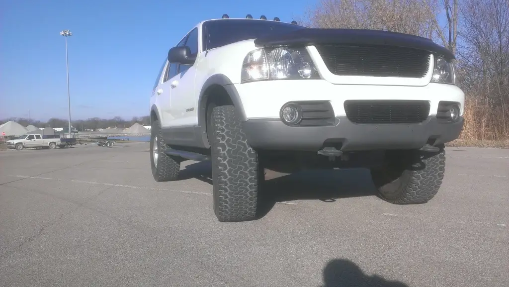

here are my tow hooks with the 1.5" bodylift

Lift is installed....
Not the best pic, but the 1.5" lift and the Coopers made a huge difference.
Looks nice Dred! I'm looking at doing the same for my Sport, where did you buy the lift/blocks?

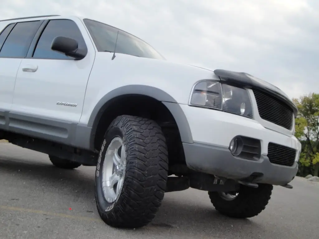

Lift/Level
Finished the lift/level yesterday...I may go up a notch in the back but, overall I'm happy with the look. Now for tires...
Sorry for the huge pic...will figure out how to resize soon...
