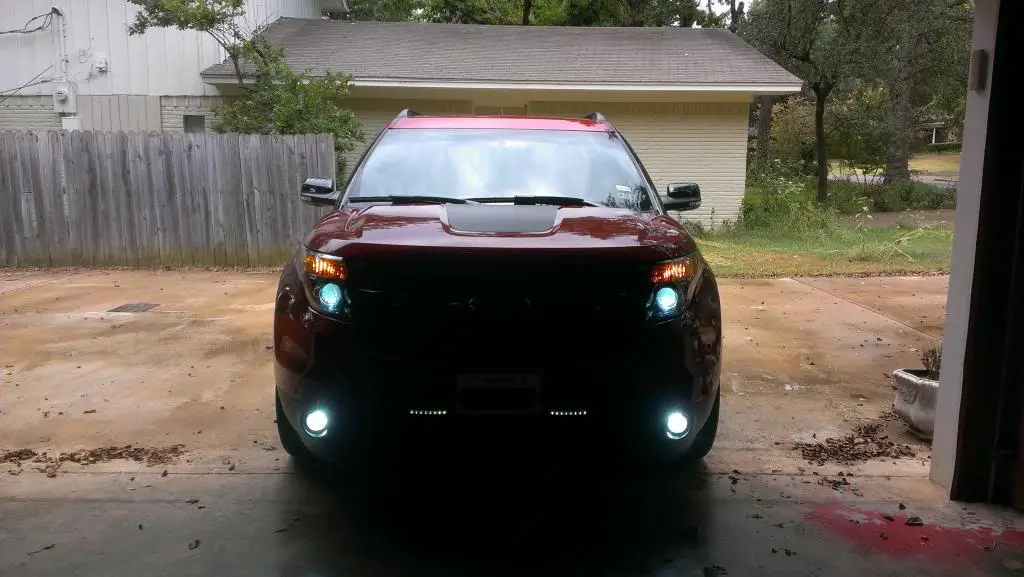

Just wanted to share pics of my 2 mods today.
Cut out and applied vinyl to hood in center "scoop" area. It's not perfect, and it was a pain... outside my comfort zone... lol. Used matte black 3M automotive vinyl.
Also added LED DRLs from here: http://www.feeldo.net/products/1211-super-bright-led-daytime-running-light-automatic-switch-onoff-8-led2467.aspx
I like the location I chose and the look, but the "control wire" doesn't seem to be working. (To shut them off with headlights on). Will have to work on that another day...

I was wondering about that location for LEDs... Is it very visible in sunlight? I'd like to see some pics of the vinyl from other angles in the sun when/if you get a chance. Thanks for sharing!

I would say they are visible but not distracting. So they're not going to catch another driver's eye in direct sunlight but they would if coming around a shadowed stretch

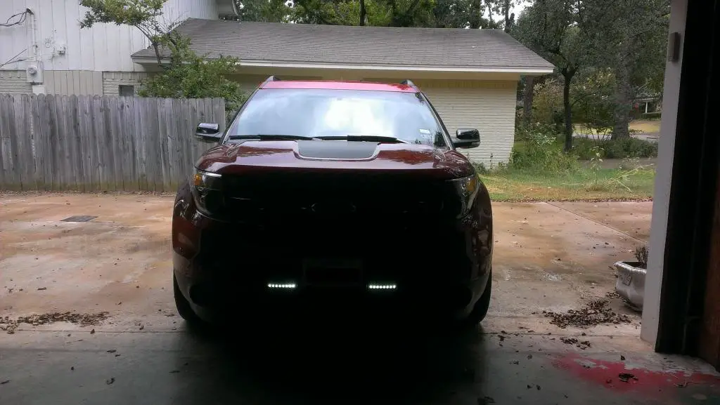

Here are a couple more pics at different lighting / angles as requested:

Is there a template for the hood section matte black - that looks incredible!
Darren
Nope, sorry.
I bought a large sheet of vinyl from http://autovinylsolutions.com/
I made sure it was oversized x2 (because I planned to screw up the first time... which I did, so it worked out)
The method that worked for me was time-consuming, but worked...
Basically lay the material out upside down. Use some kind of clips to clip it in place at the top of the hood so it doesn't slide around.
I felt along the edge of the dip in the hood and drew a line about 1/4" outside of it.
Then I cut out on that line.
Then I laid it back down, black side up and trimmed until it was right.
