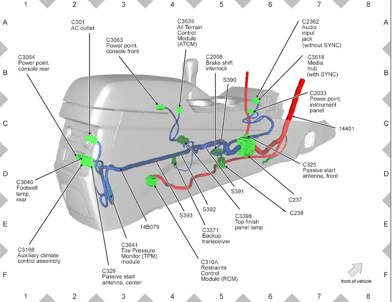

Hello all. New to the forum and proud owner of a 2015 PIU, a retired unit out of South Carolina. Recently took it to a local dealer to have the TPMS message diagnosed. Apparently their are 4 or 5 plugs that do not have a home in my center console. What they are telling me is there is a module missing for the TPMS. Was wondering if anyone knows what module is missing and if possible the part number. Thank you all In advance for any info!

Here is diagram from the Component Location thread for the 2011-2015 retail Explorer. C3641 seems to be the connector.
Found this thread but it doesn't actually identify the module by part number. TPMS Module Location?
After some Internet searching and using the AutoNation Ford parts site, I think this may be it. 2011-2019 Ford Tire Pressure Monitoring System Receiver BB5Z-15K602-L | Auto Nation Ford White Bear Lake

Thank you. One more question....the tech said the TPMS and the keyless entry work off the same antenna. I took this with skepticism. Do you know if that module when hooked up will get my keyless entry working?
