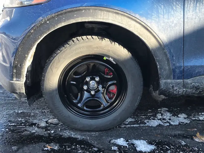

I just got back from my dealer (5:00pm) and I can confirm that PIU Steel Rims p/n LB5Z-1015B
and TPMS p/n TPMS-60 fit a 2020 Explorer ST with Street Pack, but they look like dinky toy wheels after taking the 21" off.
No pictures yet, I will take some tomorrow in the in the daylight and try and post them.

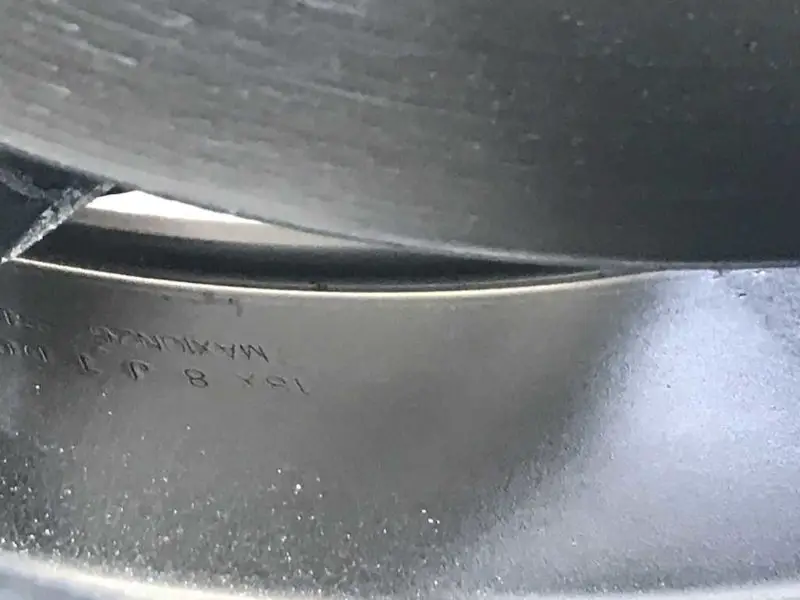

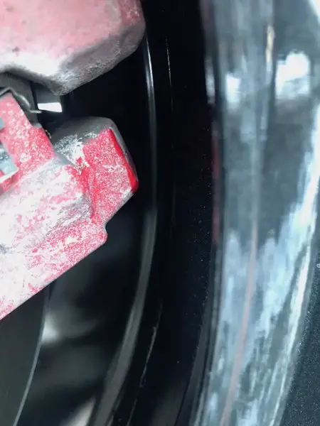

As you can see in the pictures, they do fit OK, look funny but fit.
There is about 1/4" clearance from the caliper to the inside of the rim.

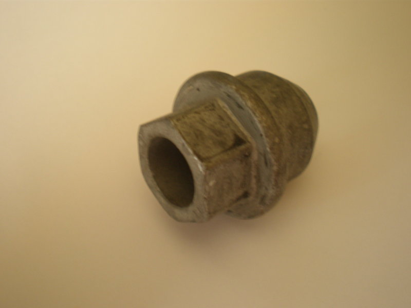

I have the old lug nuts and centre caps, the lug nuts do not fit, I am looking for new
lug nuts 14mm x 1.5 with the raised edge so the centre cap fits.
