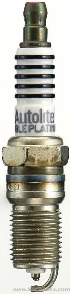

I just replaced the spark plugs and wires on my 137k 2000 XLS and the valve cover standoffs crumbled as I removed the old wires. Are the standoffs important to 1) insulate electrically the spark wires from the (metal) valve covers? Or, 2) are they mostly to prevent heat damage/degredation to the spark wires over time from excessive heat/cooling cycles? Or, 3) "Both"?
I can't find the standoffs for my 2000 so I thought I'd take a piece of heater hose, attach it to the metal bracket where the old standoffs were, cut parallel slits in the hose, and simply wedge the spark wires in the hose slits to keep them off the valve cover.
Any ideas/comments are appreciated.
Oh, BTW: The plugs that came with the dealer-sale had gaps worn to >> 0.080!!! One plug wire connector snapped off when I gripped it. No wonder it didn't have any zip-up-and-go! I can't wait for the on-board computer to reset to the new plugs (double platinum/Autolite). I gapped them to 0.052".
