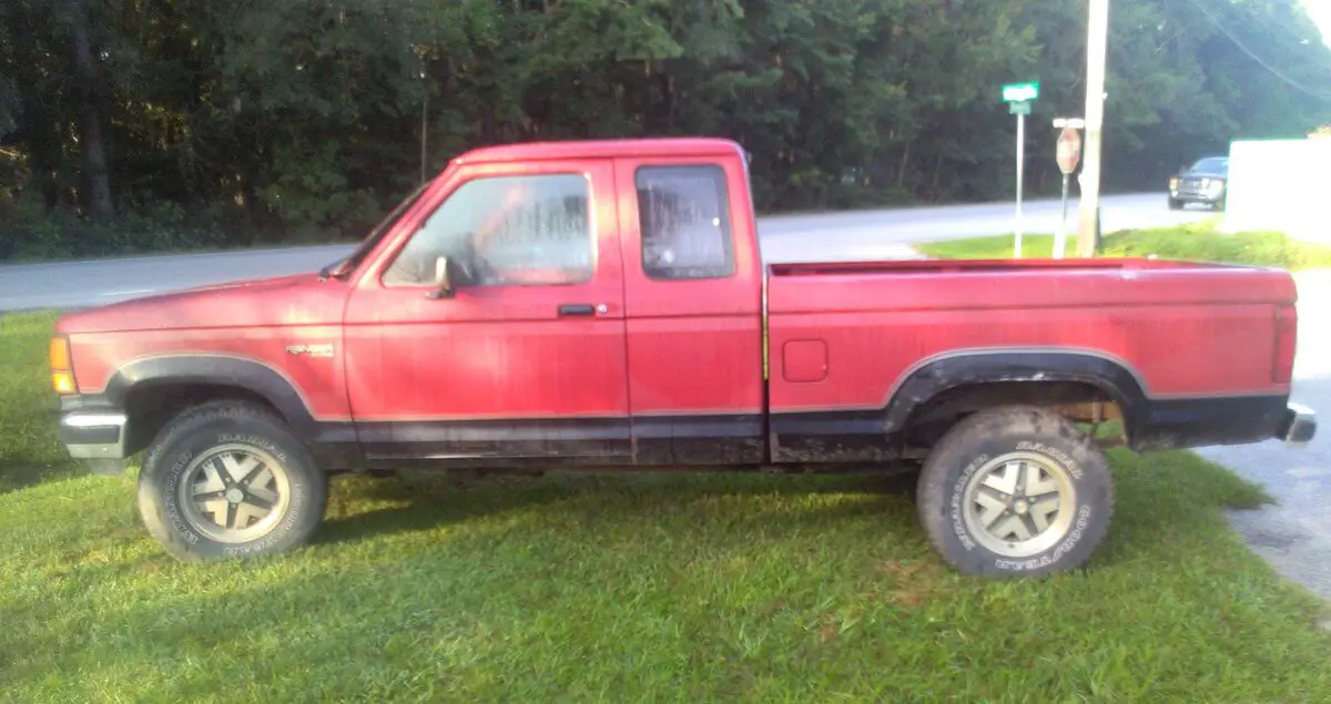

Just bougfht this last week - "Clanked" so badly I just had it towed straight to shop after 100 yard test drive - Mechanic says Pass Front Axle destroyed - Parts look readily available on Ebay & reasonably priced - Should I just replace both front Axles AND Front Drive Shaft ? - 95K miles but surely rolled over.

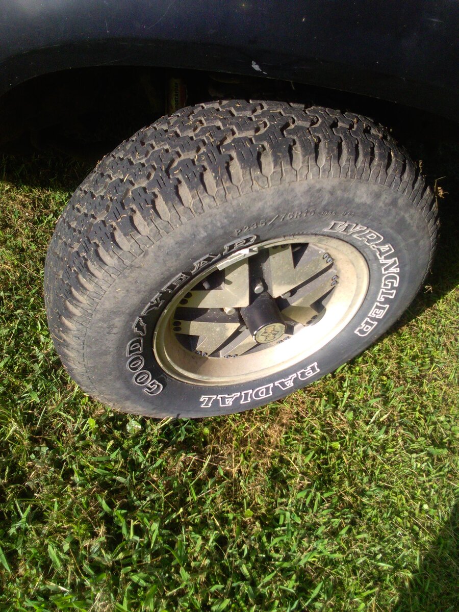

So I have Locking Hubs ?

those are AUTO locking hubs and basically they belong in the trash
You could put them on Ebay, some purist who is restoring an old BII or Ranger MIGHT want them
