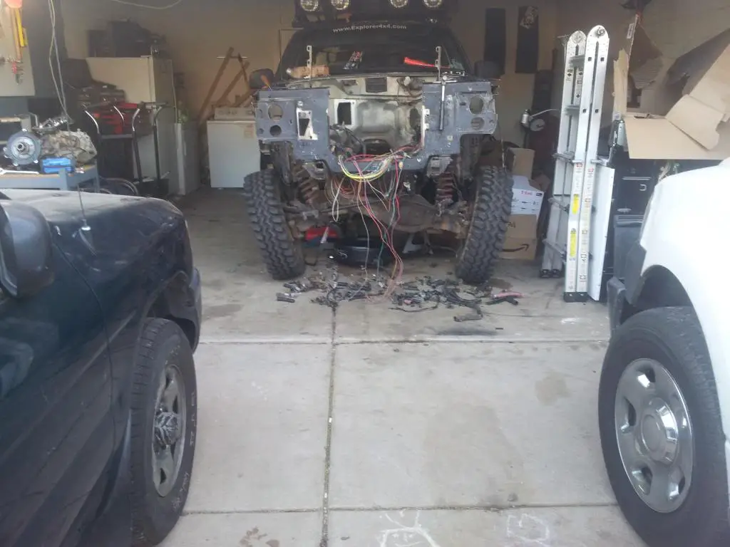

So, new swap I have committed to doing :) take your guess on what is going in and let the hybrid hate begin :mad:
I will also be swapping to a d44 ttb while I have all this room to knock them rivets out. My goal is to have this all done by july. I will attempt to take as much pictures as possible and a few videos too.
p.s. the wiring job in the explorer engine bay is such a mess :/

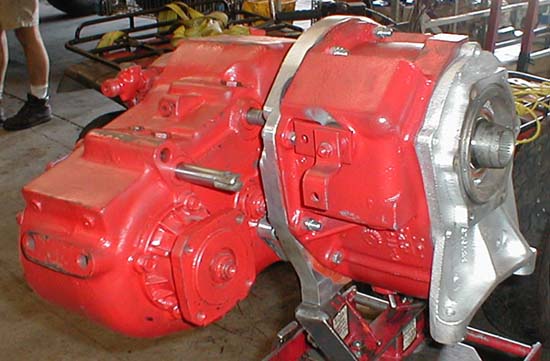

Decided on the lq4 6.0l motor. From the dimensions i have found and seeing the oil pan it should fit in without to many problems. Changed my mind from the th350 to the 4l60e, overdrive = higher axle gears and still be able to drive on the highway :). Depending on how much $$ i have left over after i get engine/tranny put in there will determine whether i go with an np241 (2.78 low?) or dish out some money for the huge 300lb 203/205 doubler (4:1 low and 2wd low and fwd selection). Has anyone put the np205 between our frame rails, how well does it fit :).
