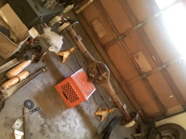

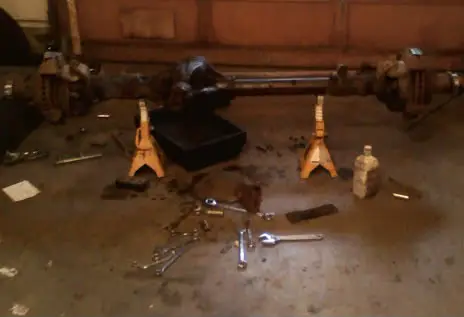

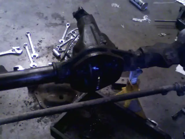

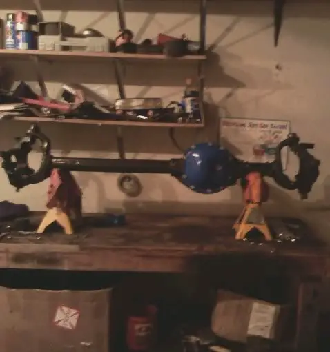

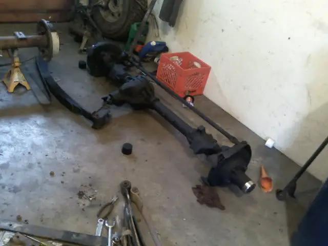

updated pictures!
Ford 9" (upside Down)
Dana 44
Dana 44 with arms
The gears in both axles are about 3.55, which i am thinkin of goin with 4.88s or 4.56s. when i upgrade to a 302 which, in your opion, gear ration should i go with?

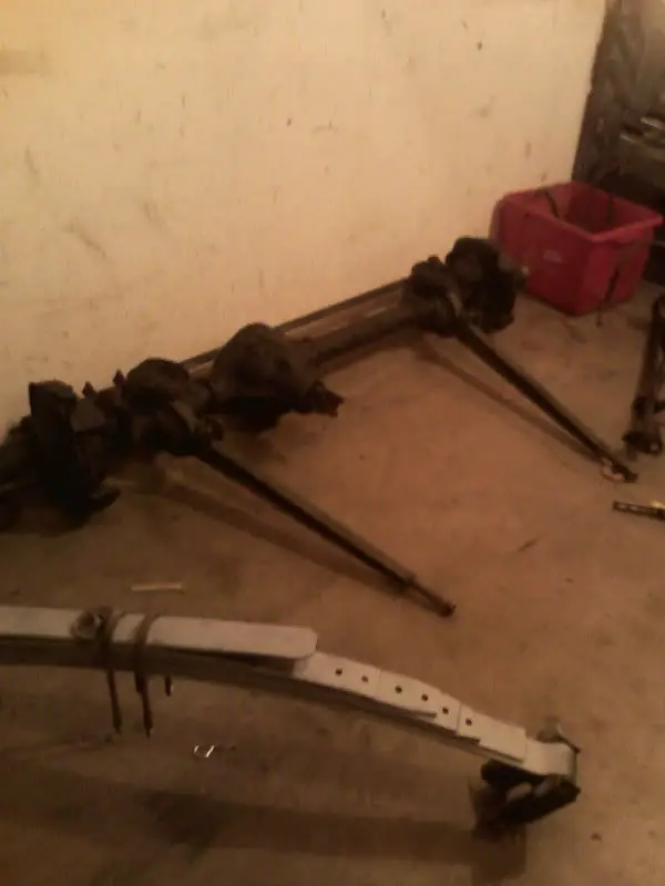

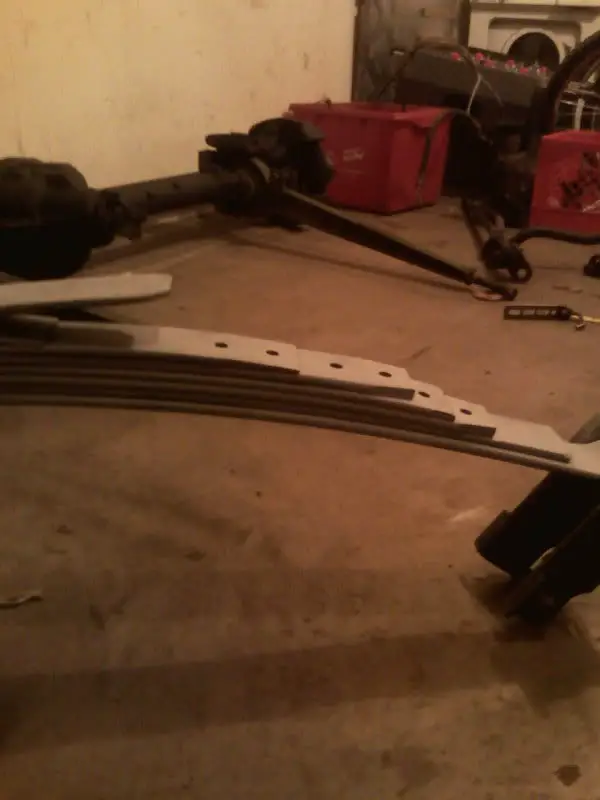

oh and a few pics of the leaf spring packs i built using ranger and explorer leafs.
The order of leaves are:
1) explorer main
2) cut-down ranger main
3) explorer second
4) cut-down ranger second
5) explorer third
6) ranger fourth
7) ranger fifth
8) explorer overload

Hate to burst your bubble, but that leaf pack is gonna be crazy stiff.
i know but i won't be wheeling all that often. Just every once in a while and it'll really never be hardcore. Just the same ol same ol. But i want this truck to be flashy and perform decently. A guy here in town has the same lift done but its really trashy and hacked so i wanna show him up since he thinks his truck is number one on the list.
also i'm not sure i'll be running those. I'm kinda interested in the 63" chevy leaves
