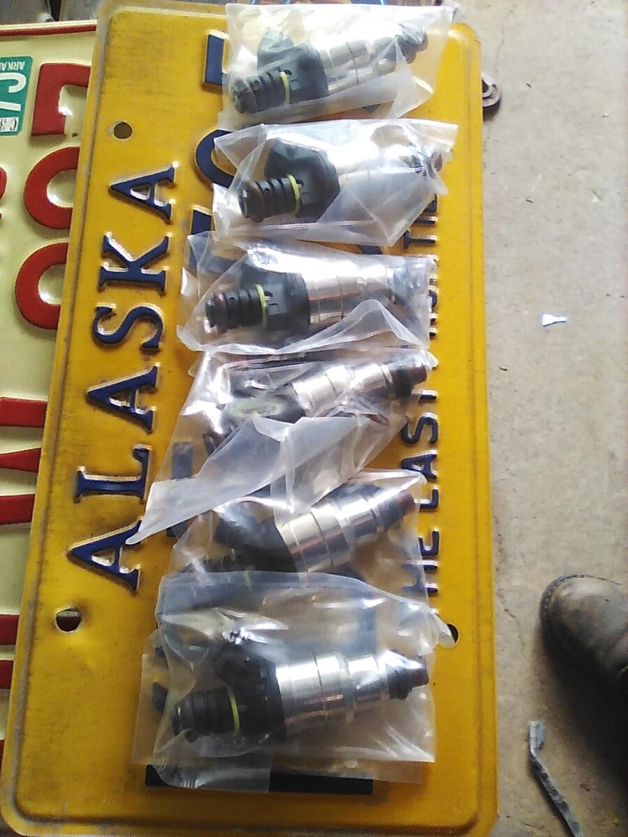

I stopped working on the '92 late Friday. Then it dawned on me that we have Monday off. Tuesday the package with the remainder of the tune up parts should be here. In the meantime, here is s picture of my latest license plate. My wife's cousins' family runs a local online auction and thrift store. I was able to "win" the Arkansas plate but missed out on Missouri. Here is a pic seeing as I can't post pictures in "everything under the sun" category. They had an early Mustang center cap that I picked up for $1-.

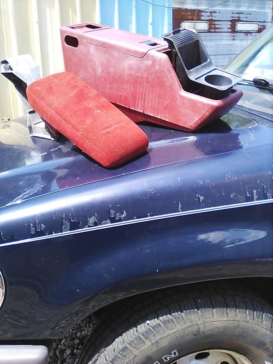

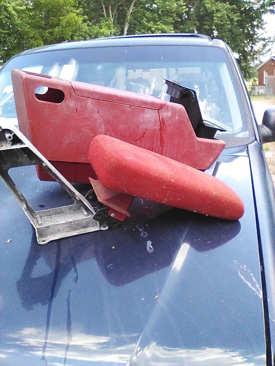

I spent some time during the holiday straightening up the space where my truck project is located. I'm trying to make more room to bring in the rear fender cart. I have several Explorer parts in there some I will use. Here is a picture of a 1991 console that I'm not going to use. It is not cracked an all of the major pieces are together. Even the armrest isn't torn.

Get the dual cup holder insert it is so much better! I have one of those consoles in every color….except red lol

@410Fortune The red console wont fit in my red '91. It has the bench seat type seat.

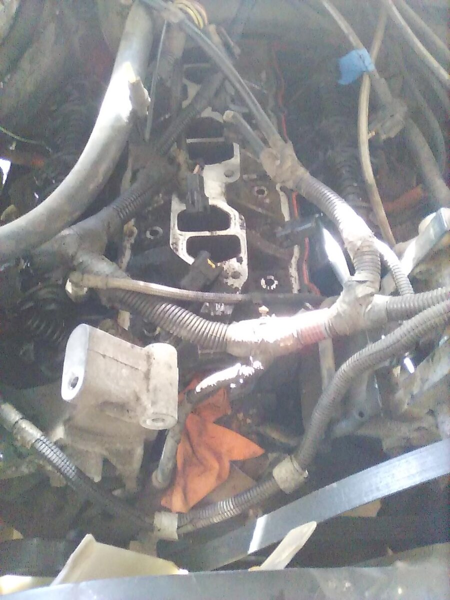

I was trying to do a simple fuel injector removal and test and it turned in to a VC gasket R&R. Several more things have to be undone or removed to get to the valve covers. One was leaking some. I've drained the radiator in hopes that the coolant/AF level will drop out of the intake. Before I left yesterday (Fri) I put a wet rag in the T-stat hole hoping it would siphon out any residual mix. I'm gonna drain the oil and save it to put back in and run it a little before the oil change. It may still be usable if I don't get antifreeze in it.
Tight and not much working room

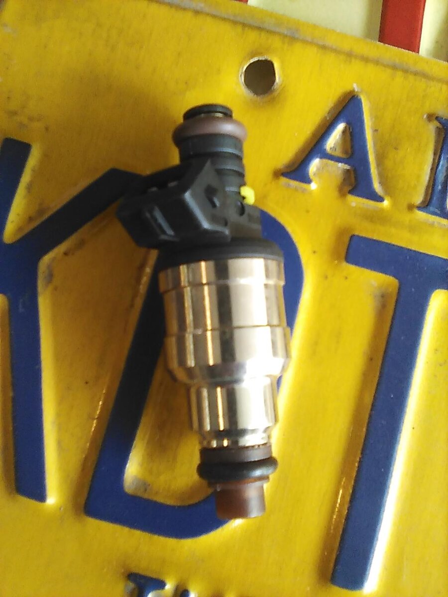

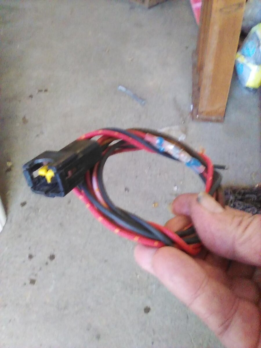

Well it is June 20th and the engine is running again. It took a few days for the injector package to show up and the gasket package bounced around the southeast U.S. before it decided to stop at my/our shop. I made the tester like you guys showed me and then I cut an injector plug and made me a test harness. One injector was clogged and one was sticking open. It ran pretty crappy with the injector problem.
When I went to the tire store to get a new rubber valve stem the service writer grabbed one of the counter and gave
to me. I told him what I was doing with it and snapped it on the injector and he said that he had never seen anyone
use a valve stem to make an injector cleaner. Test harness below.
I thought that I would see how bad Chinese injectors could be. Here are two pics.
They came with O-rings on them. The engine runs as well or better than I remember. It took about 5 minutes for
the ECM to relearn, then the idle steadied out. Tomorrow I will test drive the transmission.

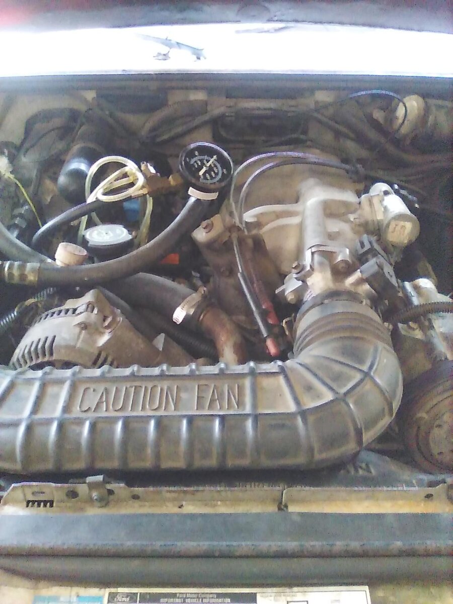

The fuel pressure before I went on the test drive was a steady 33 pounds. I shut down the engine when I got back and then checked the pressure. It was sitting steady at 40. In the pic below it's holding at 40.
